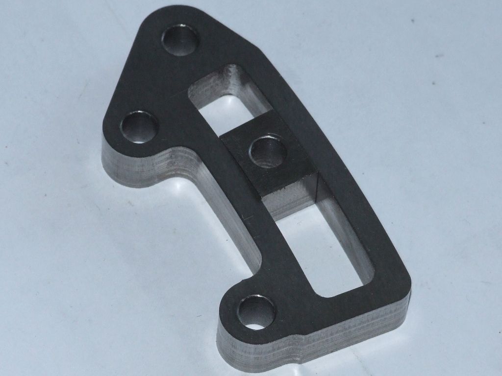

                      I've only ever made one set of expansion links, for a fellow builder rather than for my engines, and I cheated by using a CNC mill:
                      For scale the material is ½" thick gauge plate. I still did a lot of hand filing to get a good fit though. The outside profile was left rough for the recipient to finish. The inner slot was left undersize from the mill and draw filed to fit, using a Hoffmann roller as a guide. The dieblock was left oversize and likewise finished by draw filing to fir the slot. These are Hoffmann rollers, in this case bought on Ebay at an advantageous price:

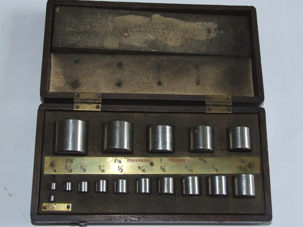

                      Despite the optical illusion height and diameter are the same.
