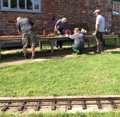

                  Just don't go too fast down this section
                  'cos you might er run out of track. Now what have we forgotten, oh yes some ballast would help.
                  Well actually they were just teting the fit as we found it pays to make the track first on our table jig then set the alignment to the actual track piece.

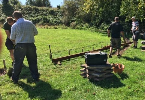

                  The long and heavy bar is used to set the gradient for each section and after ballasting to check the paving slabs are laid flat. We are not using loose trak ballast as the landlord doesn't want anything available for the kids to throw around.

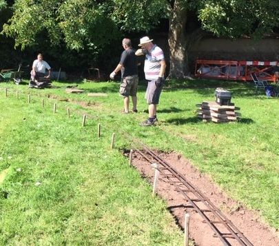

                  Progress will be slowed with new processes to comply with the latest restrictions as we go back to smaller groups and wider separation.
