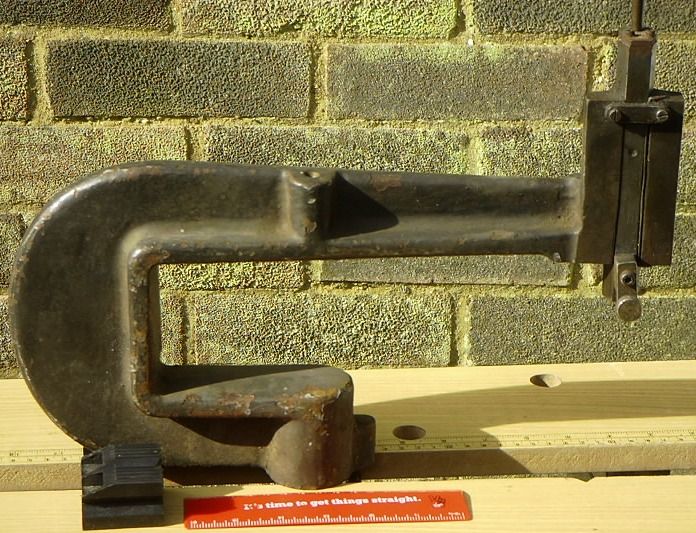

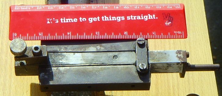

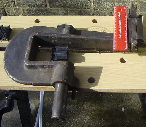

                        #119663
                        Bazyle
                          @bazyle
                          This is the cast overarm alternative to the "roller arm support " you have.
                          The Harvey Butterfly spares list calls it the "Complete Over Arm"
                          As you can see it has a round mounting where you have a straight rod called "complete cone".
                          There is a boss half way along the arm which I have now realised is just to allow it to be mounted between centres for turning the mounting bar. It would need an 18 in swing lathe to do that.
                          The rear of the end of the arm has holes for mounting the hold down.
                          The head has a prismatic sliding member with gib strips and clamp for holding the top of a saw blade or file. The round rod in the head is supposed to be enclosed by a spring to provide the upward force for the saw blade.
                          It was named "Butterfly" because it is as noiseless in its running as a butterfly in its flying.
                          The mfr recommended oil is "#30" whatever that is.
                          Edited By Bazyle on 13/05/2013 00:43:22
                          #119672
                          OuBallie
                            @ouballie
                            Thanks for the photos Bazyle. Saved for future reference.
                            Must find out how to add photos to my posts.
                            Here I was thinking it would be a relatively easy accessory to reproduce.
                            Should have realised of course, that anything produced during that period in history would not be a weekend job to copy, not for the likes of me that is.
                            Added to my wishfull projects list nevertheless
                            Don't understand the operation of the spring enclosing the round rod. Brain regularly refused to co-operate.
                            Geoff – Coffee & listening to Enya
                            #119695
                            Bazyle
                              @bazyle
                              Spring. At the top of the slide there is just visible a plate held by 2 screws. It has a hole for the rod. Between the plate and main casting there is a long thin coil spring to force the slide up and tension the saw blade. The rod just goes down the middle of the spring to stop it boinging out sideways.
                              The spring always seems to be missing probably because it is taken out when filing and lost. I think the saw was never used after scroll saws were invented so you are better off with what you have.
                              A roller rest like yours is on my todo list.

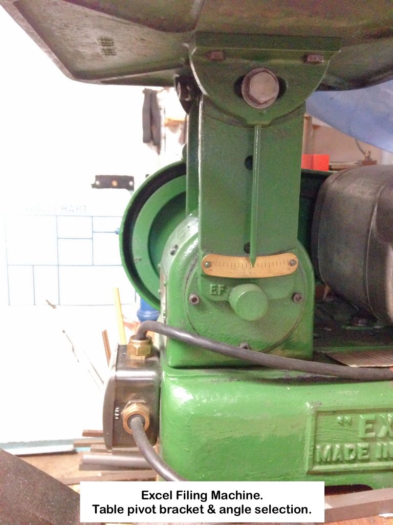

                                  #353048
                                  mechman48
                                    @mechman48
                                    I would agree with your thoughts; either for a light or a blow line off your compressor, so two options to consider.
                                    ​George.
                                    #353052
                                    Bazyle
                                      @bazyle
                                      That top block is not original as it doesn't appear in the catalogue of spare parts that I remember. I think you are right that it holds an air line or lamp.

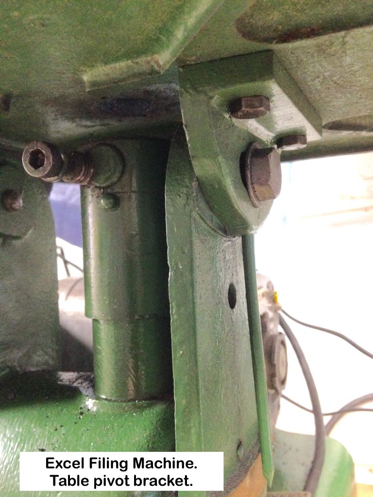

                                      #353065
                                      T.B
                                        @t-b-2
                                        Hi
                                        I picked up one of these Excel die filers a little while ago that is missing the front bracket that the work table pivots on, this is the part with the needle indicator attatched to show the table angle.
                                        While this is a relatively simple item to make , i would like it to resemble the original part as much as is possible and i can not find a good picture anywhere online that shows this part.
                                        Is there any chance anyone could post or send me a photo of this part please ?
                                        #353070
                                        Mike E.
                                          @mikee-85511
                                          I would say that the block on top is for an airline to blow swarf away.
                                          There is an attachment for an airline on one of the hold down arms of my Opus 120 filing machine, which can be seen in the photos. This machine uses a ball mount for positioning, whereas I would speculate yours would have used something like the arms from a surface gage to position the air nozzle.

                                          #353359
                                          OuBallie
                                            @ouballie
                                            T.B
                                            Two more in my Album page 3.
                                            Excel Filing Machine
                                            Geoff – The sudden heat is welcome, but affecting me more than expected.
                                            #353370
                                            T.B
                                              @t-b-2
                                              Thats great Geof , thank you !
