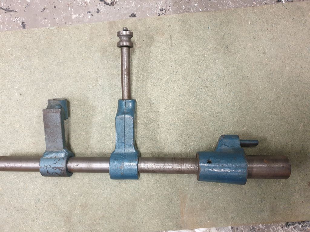

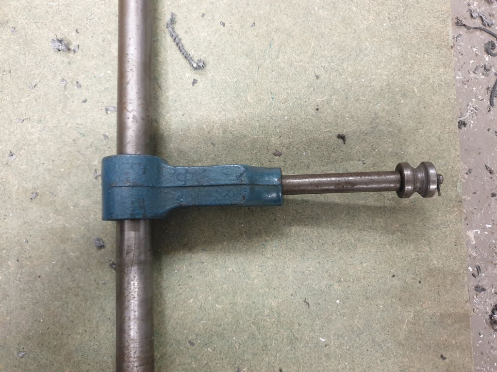

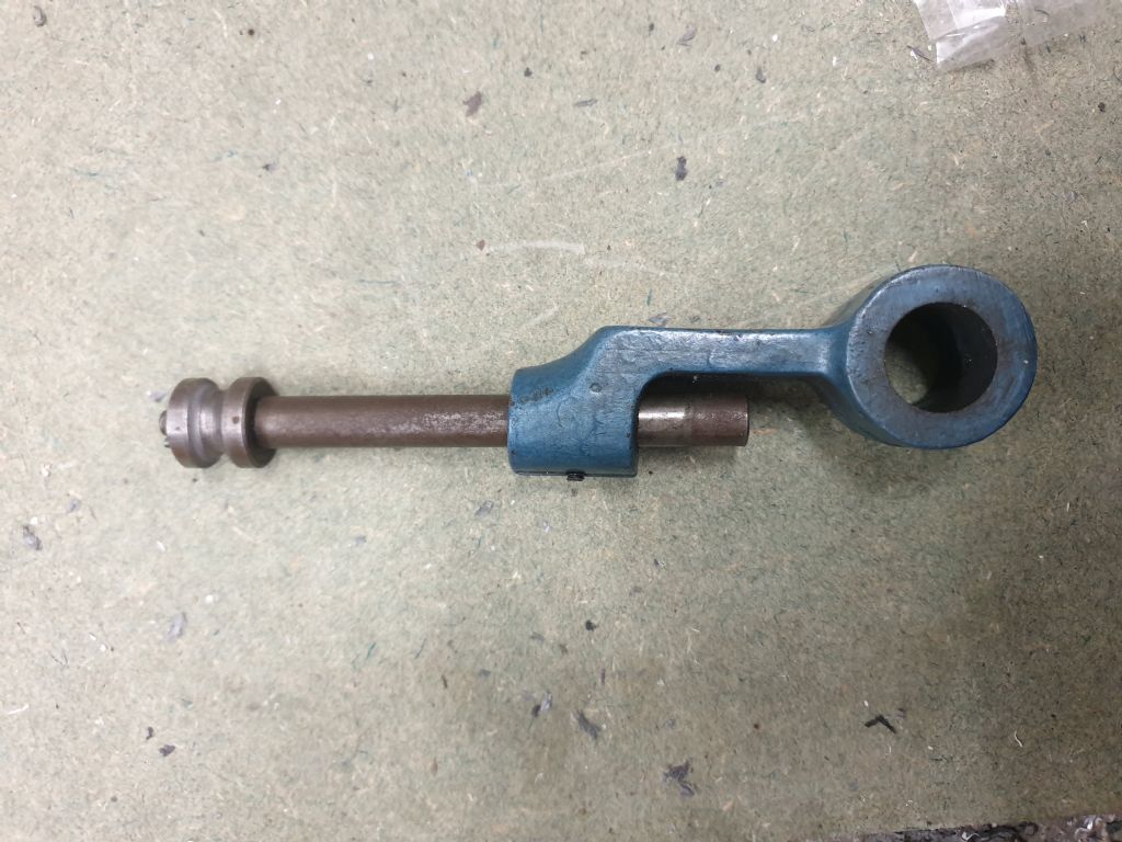

                    #410939
                    paul rayner
                      @paulrayner36054
                      Hiya Colin

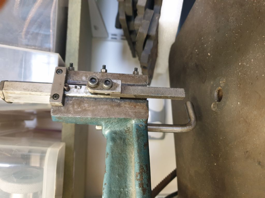

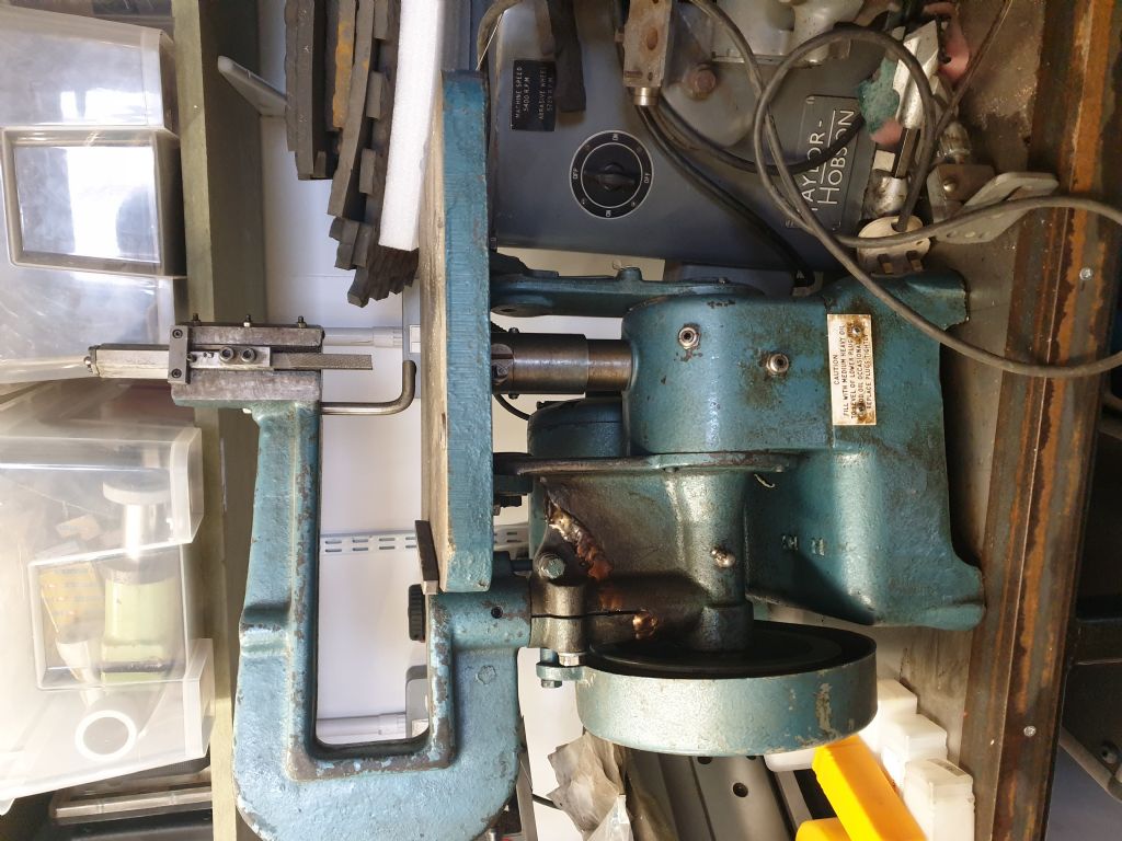

                      This is my filer although its branded a new wonder it looks the same, interestingly the top support in pic 1 & 3 is different but I have another support in pic 3 which fits as well.
                      I assume it's this what you require the measurements of? if so let me know and I will take some more pics of the part and some measurements
                      regards
                      Paul

                        #411017
                        Bazyle
                          @bazyle

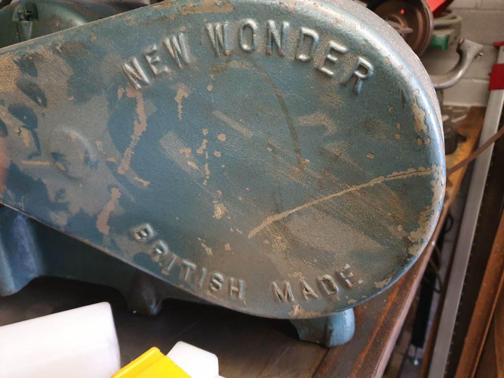

                          My interpretation of Paul's second picture is that the top arm (left most) is a fabricated one.
                          The arm in his first picture is the saw arm, there should be a spring at the back of the top section that is there to tension a coping saw blade during the upstroke.
                          I've not heard of the New Wonder version but this design has been copied or branded with a dozen names round the world. In the USA Buterfly is a common one.
                          #411021
                          Colin Heseltine
                            @colinheseltine48622
                            Baz,
                            Yes I agree that is fabricated. The middle arm, which I am collecting details on looks a nice casting.
                            I have the saw arm, but the previous owner used the saw clamp to hold a file. I spent part of yesterday afternoon grinding the tangs off some new files and thinning the width of the files down so they fit in the clamp mechanism. I now have to decide hold to hold the triangle section file and the small round files. For the parallel round files I was thinking of a small block with a hole drilled for the file and a clamp slot. With luck when the clamp mechanism on the Excel is tightened the block will compress slightly and hold the file firmly. This way it would be possible to slide the file up in the clamp to take account of worn teeth. If this is a no goer, then just a small block with a hole and super glue the file into the hole.
                            Colin

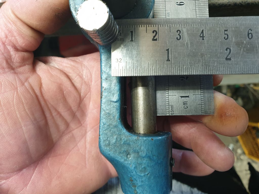

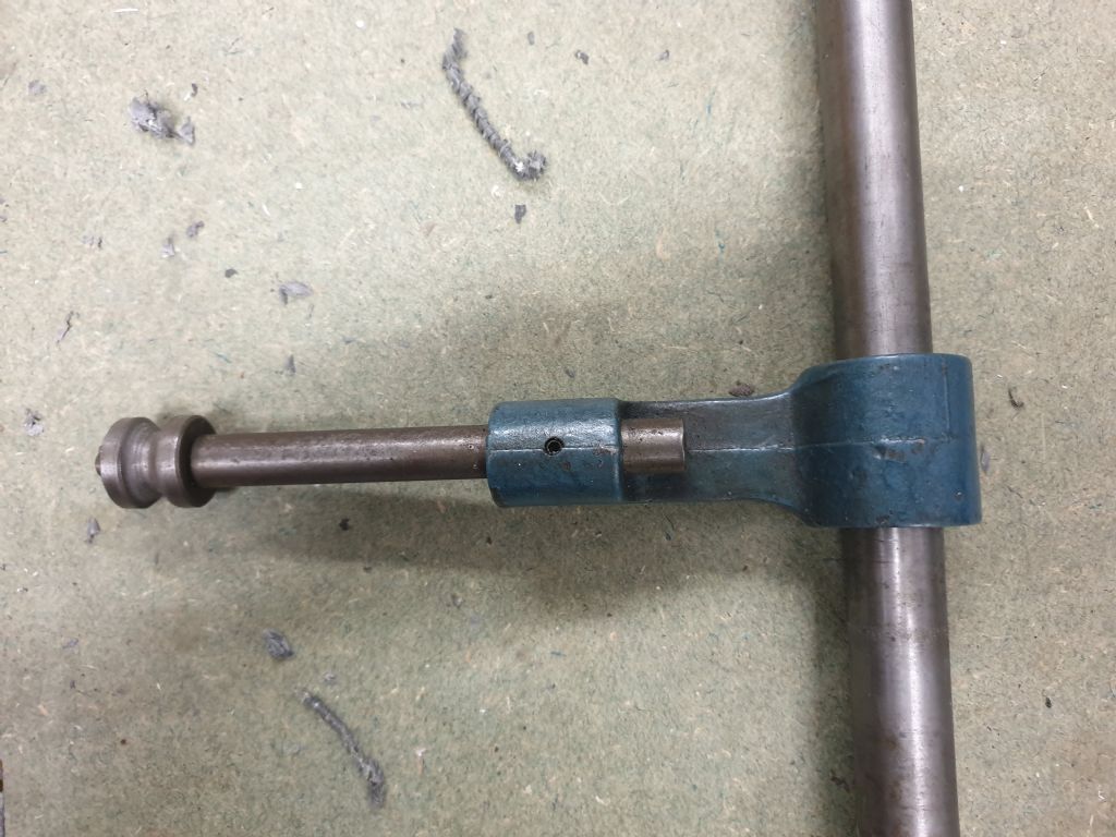

                            paul rayner
                              @paulrayner36054
                              20190526_142658.jpg20190526_142530.jpgBaz- spot onyes
                              Colin-
                              dia of wheel is 22.31mm length is 19.21mm
                              the boss is 38.5mm wide & 38.13 high
                              the arm casting is 111.2mm long it is fixed to the vertical via a grub screw to enable adjustment.
                              a 12.7 mm bar fits into this casting which is a total of 141.18mm long of which the last inch is turned down to 6.63mm for the guide wheel, which in turn is held in place by way of a washer & split pin
                              The amount of offset is approx 13mm
                              I will take another pic with a rule when I get chance for you
                              hope this helps regards
                              Paul

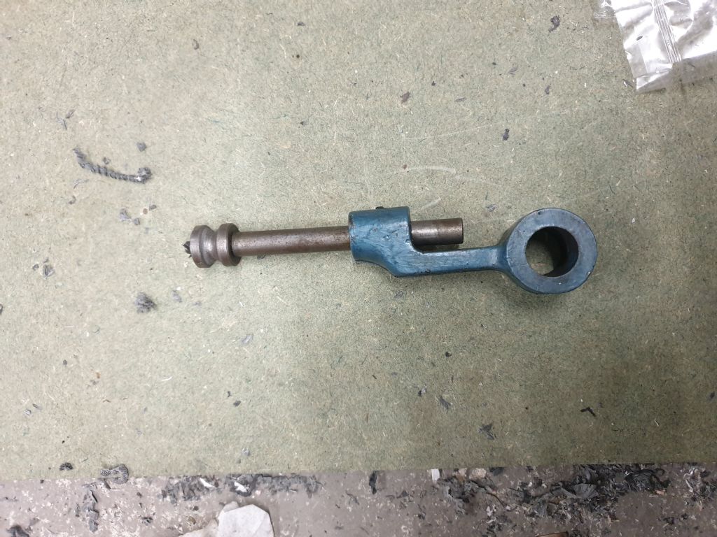

                              #411033
                              Colin Heseltine
                                Paul,
                                Thats great. What is the diameter of the vertical support. I know the bottom is 1.25", but it appears tpoo be narrower on the upper portion.
                                Could you also possibly take a photo of the plan view of the arm.
                                Colin
                                Edited By Colin Heseltine on 26/05/2019 16:57:47

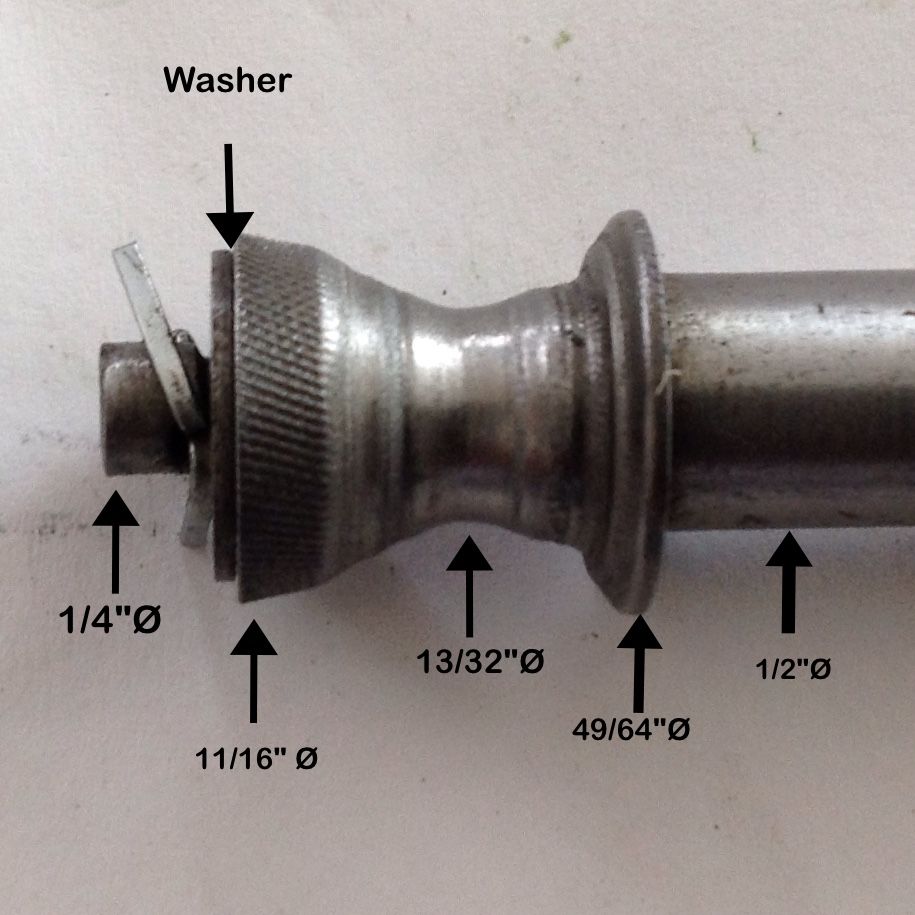

                                #411036
                                OuBallie
                                  @ouballie
                                  Colin,
                                  I've split your post into Q) and A), easier for me.
                                  Q) Is the main support pillar 1.25" diameter or is it reduced to a smaller diameter above the boss with the downwards projecting pin (pin used for adjusting radial position of the arm).
                                  A) It tapers from 1.29/32 at the base down to 1.9/16 at the top where the 7/8"Ø bar fits into.
                                  Q) Is the roller one piece with bearings and the conical shaped machined into it, or is it two loose cones (with or without bearings).
                                  A) One piece, without bearings, the 1/2" shaft turned down to 1/4" for the roller.
                                  Excel Filing Machine
                                  Q) What size bolts are fitted and are they in counterbores in the main boss.
                                  Large boss – 3/8" Whitworth C'bored Small boss – 1/4" Whitworth not C'bored
                                  Q) What is length of short boss that pressure finger or roller arm are fitted into.
                                  A) 1.3/32"
                                  Q) Is it just an optical illusion that the finger arm looks to be at an angle.
                                  A) It's at 90° to the shaft.
                                  Geoff – Audiobook next me thinks 🤔

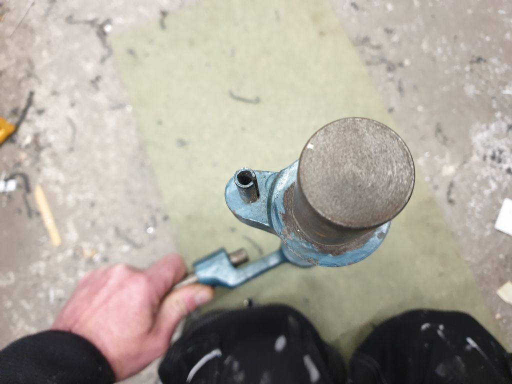

                                  #411039
                                  paul rayner
                                    @paulrayner36054
                                    20190526_170927.jpg20190526_170905.jpgHiya Colin
                                    the offset is about 1/2" centers the top bar is 7/8"
                                    regards
                                    Paul

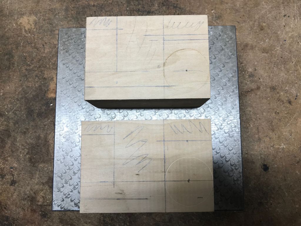

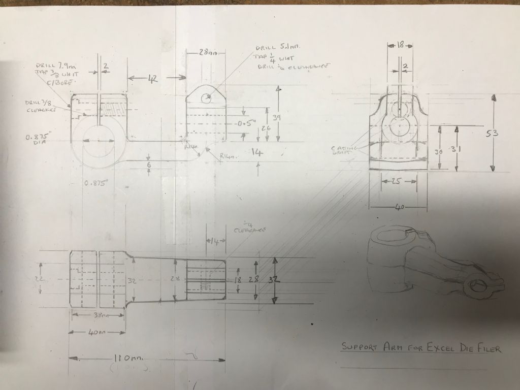

                                      #414112
                                      Colin Heseltine
                                        Thanks to all the help I have now drawn up plans for the arms:
                                        Started with some nice Basswood
                                        Found these twins inside.
                                        Just need to make the pattern for the boss which hold the upright for the arms, get them painted and off to the foundry.

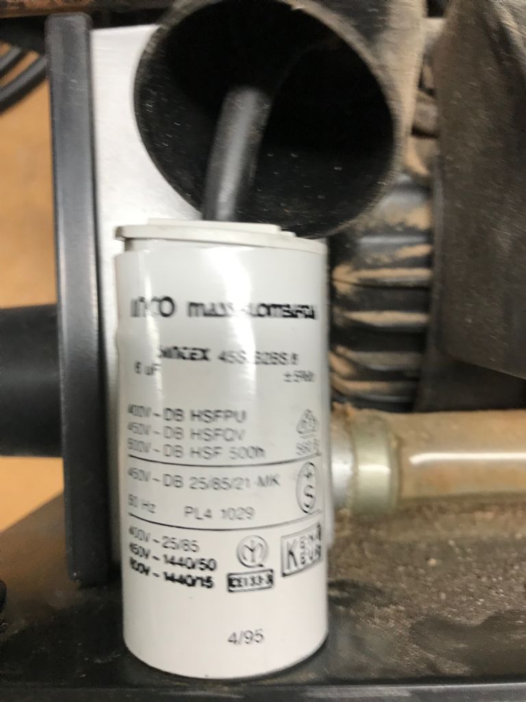

                                        Whilst making them my Dremel Motosander 1731 (1" belt sander) went pop. Could hear a slight hum from the motor but that was it.
                                        After my issues with my old mill I though immediately "the Capacitor". Open its case and see below:
                                        It says 6 microfarad.  This seems a bit low.  Any thoughts.
                                        Colin
                                        Edited By Colin Heseltine on 13/06/2019 17:45:15
                                        #414709
                                        Colin Heseltine
                                          Ordered a replacement Capacitor from Fleabay and it arrived today. 5 minute job to install and very pleased that I now have a fully operative Dremel belt sander.

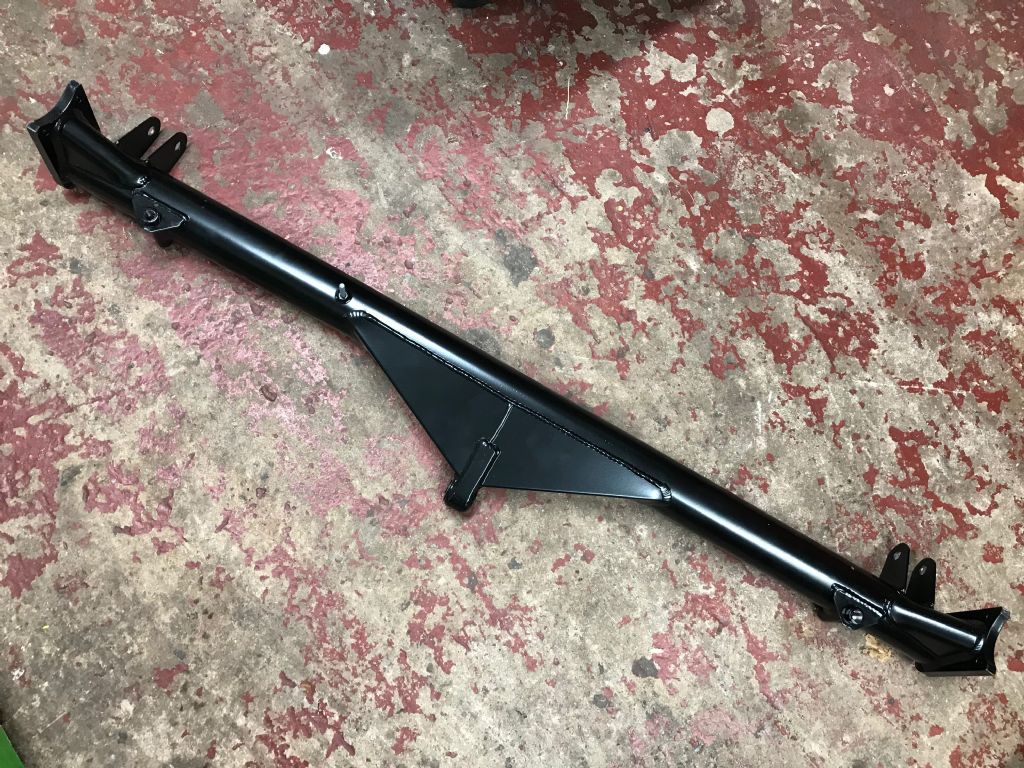

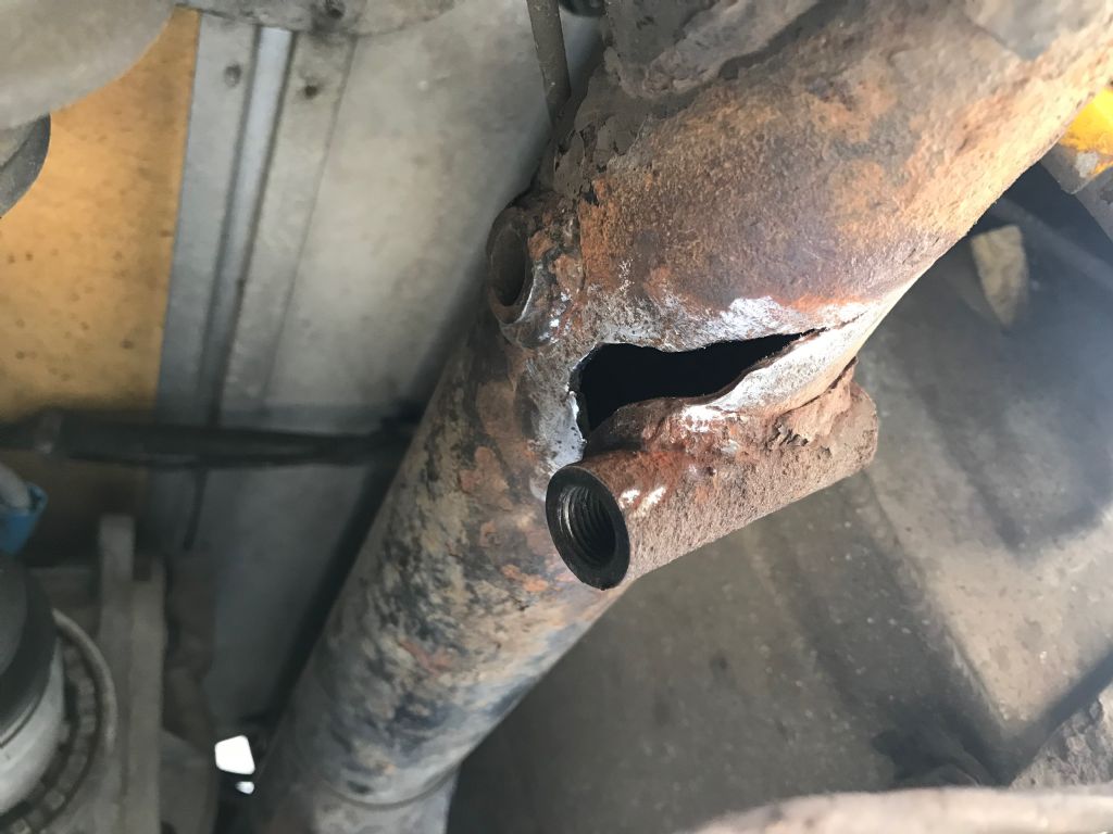

                                            I mentioned progress might be slow due to having to fit new shock absorbers to Caterham 7. Well I got them fitted and had a nice weekend driving round the Yorkshire Dales. Got back and couple of days later went to get the car flat-floored (all suspension set up properly. All set up ready to adjust rear shock platforms and found this.
                                            img_5254.jpgShocker had ripped rear mount out of De Dion tube. Not deemed safe to weld as could be too much corrosion inside, so now need to fit this.
                                            So Die Filer project slowed down even further.

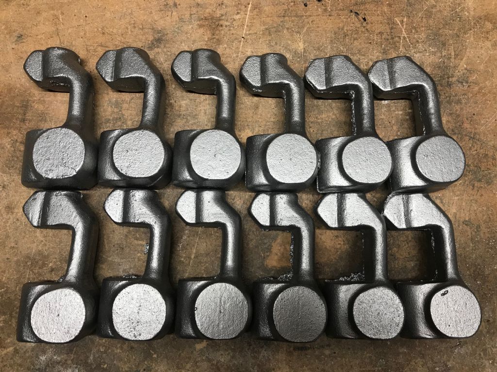

                                            #429829
                                            Colin Heseltine
                                              I went to collect my casting yesterday morning. Superb quality. Will have a few spares for sales. Took pattern in for the third casting I require and it should be available next week.
                                              Colin
                                              #429836
                                              Jeff Dayman
                                                @jeffdayman43397
                                                Nice job on the patterns Colin, castings look great!
                                                #429840
                                                  Posted by Jeff Dayman on 21/09/2019 03:34:14:
                                                  +1 for that yes
                                                  #429847
                                                  Chris Evans 6
                                                    @chrisevans6
                                                    Nice castings Colin, who do you use ? With the demise of Coventry Castings I now use Purbright in Walsall but always looking for other foundries locally. Chris.
                                                    #429851
                                                    Waggonerman
                                                      @waggonerman
                                                      Superb looking Castings Colin – look forward to receiving my pair.
                                                      KevinH.
