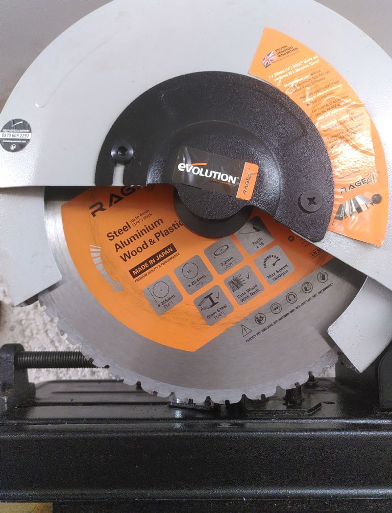

      I want to buy a large TCT blade to cut steel. I found the Evolution brand and I wonder if it is any good. There are many positive reviews but also cases when people complain that after a few cuts the blade didn't work anymore. Or are there better alternatives?

          What sort of steel section are you cutting and with what?
          I have only cut metal with industrial machines and personally wouldn’t use anything in my workshop other than a band saw. Most blade manufacturers can supply metal cutting blades but are specific for material being cut and speed of machine.

              I want to be able to cut mild steel plates up to 10mm thick. Or square bars up to 20x20mm. Speed is adjustable up to 1400rpm.

                I have an Evolution chop saw with a TCT blade. I have successfully cut steel bar and angle with it.
                BUT there are a lot of red hot chips flying everywhere. So much so that I invested in a small bandsaw which is a far more civilised way to cut metal.

                  Usually these saws run at much slower rpm than the max allowed for this blade. In the low hundreds and with coolant, plus the work must be really well clamped.

                      we’ve been here before – the evolution chop saw will cut mild steel certainly upto 15mm but after finishing the job I’d bought it for I put it away and bought a bandsaw – the chop saw is not suitable unless in a large workshop as it throws red hot bits a long distance – also the blades are not it appears suitable for stainless steel (though neither is my bandsaw – I cut these with a small angle grinder with 1mm cutting disks)

                          That 14" blade in the picture will take some considerable power / torque to drive it through mild steel, let alone austenitic stainless.

                                    I use the evolution rage blades, I recently cut a 3" x3" large slab of 1" hot rolled steel. Most probably some sort of carbon steel as the laser cut edge seemed hardened, (scrapyard offcuts). Anyway with plenty of wd40 and a slow cut it made a nice job. Made all the difference when I tried my fly cutter on the myford. Strickly speaking the blade is on rated at 6mm for steel but the unconventional blade pattern seems to prevent stalling or grabbing issues.

                                        It was an evolution chop saw, most likely the mitre saw and my chop saw have similar universal motors. Mine runs at high speed but I didn't force the blade, so yes slow down feed. Got through plenty of coolant, but no red hot shavings thankfully.

                                                The RAGE blades in the chop saw need to cut and not skid over the metal. Best for tube and section. Cutting 1 inch bar is possible but also easy to skid and that will blunt the blade. It will cut reinforcing bar but that reduces blade life. Anyway, must go now and buy another blade

                                                  I have used one of the Evolution metal cutting saws for years, the 255mm diameter version. When first bought was used to cut lengths of 50x20mm mild steel, whilst not quite as fast as cutting wood, wasn't much difference.
                                                  BUT!
                                                  What the saw will not do is cut rusty metal. If the metal has a layer of rust on it, in my case inside roled amd welded tube, the balde will only last for a dozen or so cuts. The flaky rust is hard and destroys the tips. If you have ever tried to oxy acetylene cut rusty steel then you will know that that doesn't work at all. If the metal just has a film of corrosion that can be removed with WD40 and wire wool then ok.
                                                  The comment about it chucking very hot chips everywhere is true! Use some sacking to catch them.
