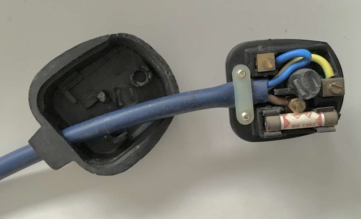

      … dies of fatigue eventually:
      Unplugging my extension lead t’other day was interesting to say the least.
      The top came off in my hand, and the live bits remained in the socket:
      IMG_9010
      The rubbery plastic post, with its little brass threaded insert was the ‘single point of failure’
      … be warned.

        Possibly repairable with a bookbinder’s screw.

          One thing I’ve noticed with Duraplugs is that as sulfur fumes outgas from the Vulcanised rubber, tin sulfide is formed on the fuse end caps. Unfortunately, this doesn’t conduct electricity. A number of times over the years, both at work and at home, I’ve had to remove the fuses and either clean or replace them.

            Just buy a new plug, not worth electrocuting yourself for a couple of quid
            #686458
              Plug was removed and condemned, immediately after photographing it for the forum.
              I’m definitely with Duncan on this one !!

                The lesson from this should be to only use Duraplugs in switched sockets. It is an example why it is always a good idea to switch off a socket before removing the plug.

                  I’ve noticed that after a while the rubber used for Duraplugs age hardens and becomes brittle, I was under the impression that vulcanised rubber wouldn’t do this, I must admit I have had a similar occurrence with a Duraplug in the past.   Dave W

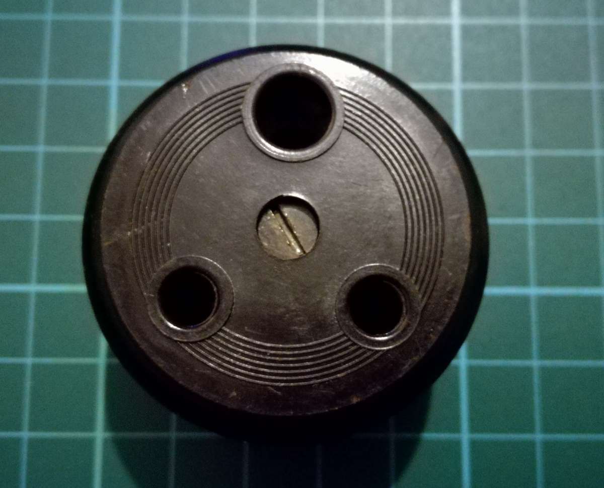

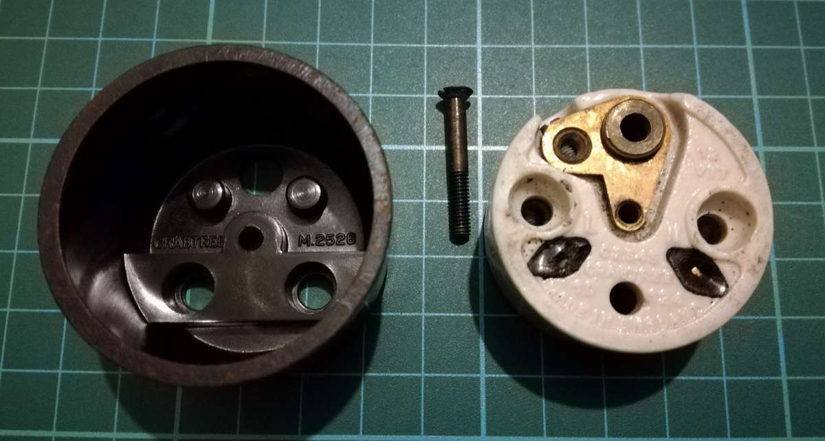

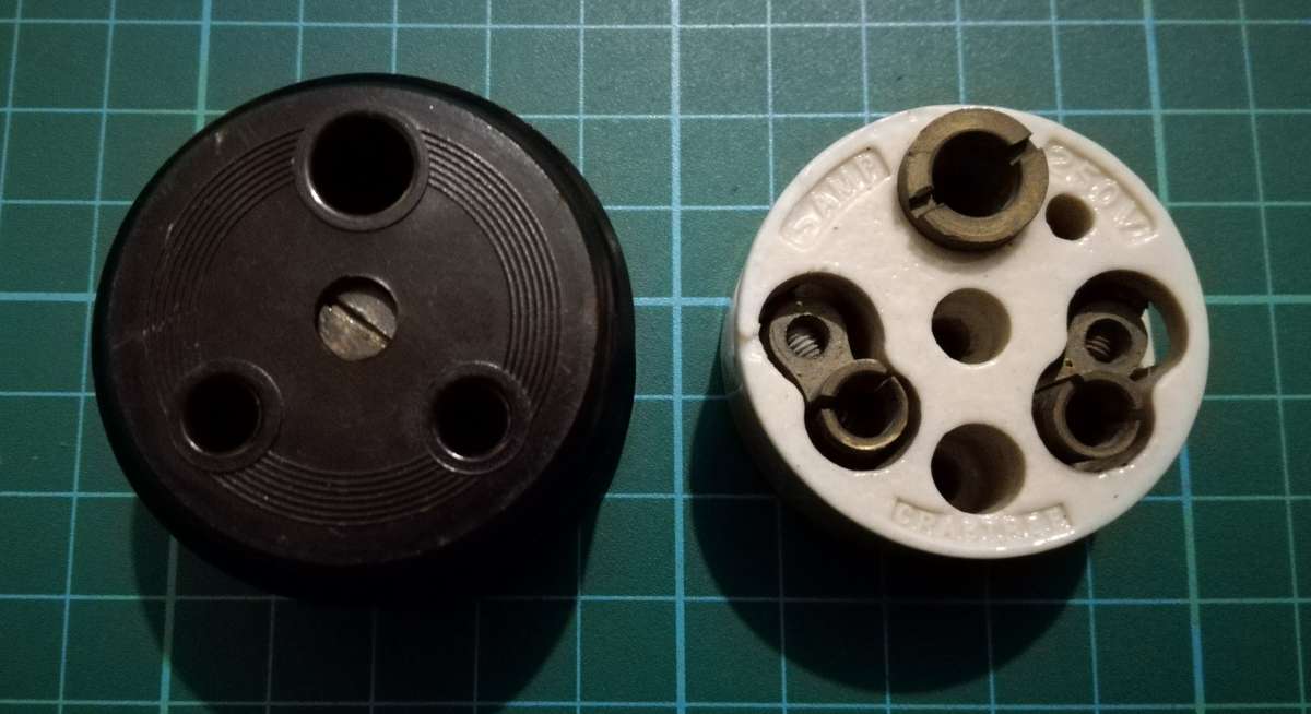

                                                Hi densleigh, I’ve never seen those Wylex plugs that you mention, but I do have an old Crabtree 5 amp socket without an integral switch, this has a porcelain base with a brown bakerlite cover, which would have been mounted on a round wooden plinth fixed to the wall, with its own cable back to its own fuse.
                                                Socket#1
                                                Socket#2
                                                Socket#3
                                                I can remember my father having one of these in his shed, which had only a twin outlet, and when I was about five or six, I was in there with him once, and I put two of my fingers over both the holes, and they must have been small enough back then, to just make contact with the terminals, and soon found out they bite, learnt not to that again.
                                                Regards Nick.
