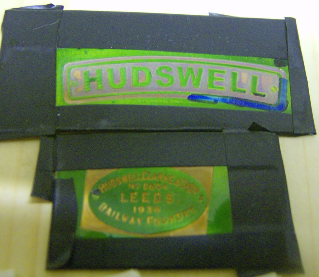

                                    Sub Mandrel
                                      @submandrel
                                      I'll bump this as my experience today may be helpful
                                      Photo-resist spray is available from Maplin (but not Farnell) after some almost-usable tries using the iron on laser print method (using normal paper, but softening with NaOH).
                                      I normally use photo resist boards for PCBs, but this is my first try with the spray. I discover you need to use quite a good spray (~10 quick passes) or you get fuzzy results. The hardest bit is making sure the brass is dead flat so the positive (laser film) is pressed hard against the resist for sharp lines.
                                      I'll post some pics when they come out of the ferric, and after they've been tidied up.
                                      #89977
                                      Sub Mandrel
                                        @submandrel
                                        This is straight from the ferric, looking a bit rough – the blue bits are dalo pen:
                                        Straight from teh etch
                                        I've filed them out and quickly filled them in with magic marker – proper finish will have paint and a real polish. This is the maker's plate for the radiator, 1 1/2" across – I'm well chuffed with this:
                                        Makers Plate
                                        The number plate from the side of the cab is just 3/4" across. The text isn't perfect, as the resist was sprayed on too thick. A better one is in the etch:
                                        Number Plate
                                        Even so, if the R and Y had come out it would have been better than the real plate I copied!
