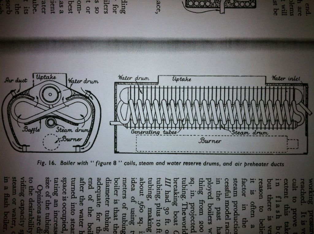

      image.jpgI have been poring over ETW and Benson's FS books. Both refer to this boiler as suitable for a diffuse burner ( and show a drawing of the burner, which had appeared in ME 1770 ( 1935). The boiler design does not appear in that issue and I can't find it in the index.
      Benson says that he knows of no actual examples.
      Has anyone built one? If so, how did it go?
      Would the water drum mean that it needs to be treated as a pressure vessel and inspected/ certified etc ( I understand flash units do not)?
      Does anyone know the original ME article that the design appeared in?

          Russ,
          For your information , this drawing is shown as fig 5.2 in the Benson book which I am about to put on sale. On page 69 of the same book fig 5.8 shows a design for an ETW diffused flame burner which may be suitable. Suggest you may find it useful if you could get to talk with Phil Abbott of the Blackheath Model Boat Club. Believe he also may still be the straight running secretary of the MPBA. Contact may be possible via our companion Model Boats web site ? Certainly Ive always found him to be a very helpful and knowledgable chap on the subject of flash steam. With respect to certification of the boiler, I would assume it would depend upon its bar-litre capacity , a point which I am sure Phil or any MPBA club boiler inspector would be able to clarify.
          #147715
          c
            @c
            Your boiler diagram is reproduced on page 523 of issue 1777. Whilst a design for it was not published in ME, you may find the accompanying text useful.
            Chris.

            Russell Furzer
              @russellfurzer50760
              Thanks guys.
              a second Itech search found that article in 1777. Dunno why it didn't appear first go!
              Russ

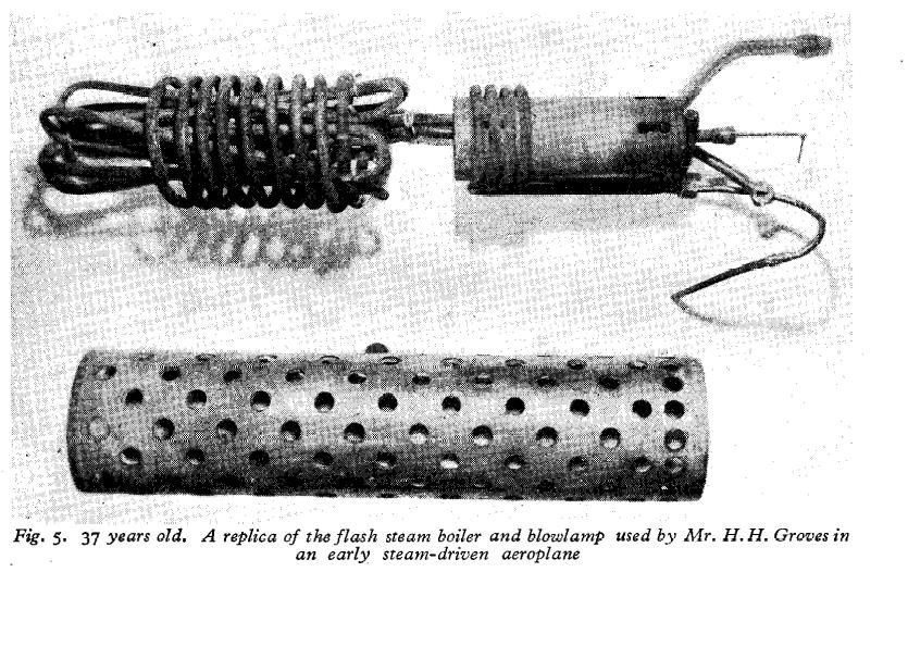

                #147732
                Ady1
                  @ady1
                  #147733
