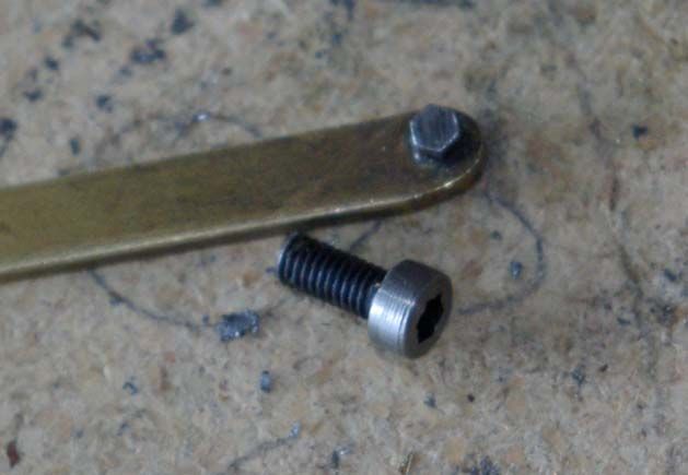

                        Some advice needed please. I have fitted an ER32 collet chuck to my Boxford VSL500. This lathe has a L00 taper spindle fitting and finding suitable backplates isn’t easy. Anyway, I got a backplate from Rotagrip and a collet chuck from MSCJL. I machined the register as best I could but as my machining ability rating is AC*,  needless to say it’s a tiny bit too small. Can’t actually feel any movement when the chuck is on the backplate but the TIR in the collet socket is about 1.5 thou. The runout on the backplate register on it’s own is about 0.2 thou and as the lathe spindle runout is the same I guess the register is nice and concentric, just that little bit too small!
                        So, do I have to live with this or is there anything I can do to improve matters? I have considered cutting the register right back and machining a sleeve but then I will need to make two super accurate cuts, not just one. Another stray thought, could I run some silver solder around the register and then re-machine to size? I like this idea but as I have never actually silver soldered anything and this would involve heating the whole back plate to dull red heat it’s a bit daunting.
                        What else?
                        Regards
                        Hugh

                            Why not just tap it true and tighten up ?
                            Cylindrical grinders are made with an undersized spigot just so the chuck can be tapped true with a lead block.
                            John S.
                            #54835
                            wheeltapper
                              @wheeltapper
                              tapping it true works for me too.
                              this collet holder I made
                              fits on the spindle flange.
                              I made the recess a mite oversize so I can true it up .
                              Admittedly it would be nice to just bolt it on and get it right straight off every time but who am I kidding.
                              Roy

                                #54839
                                Hugh Gilhespie
                                  @hughgilhespie56163
                                  Tapping it true sounds like a plan. I feel much more confident using a hammer than a lathe!
                                  Just to be sure I understand what’s needed, I assume that I need to do the following:
                                  Cut back the register on the back plate so that it misses the recess on the chuck by say 25 thou all round. Then the chuck is free to slide around on the surface of the back plate.
                                  Clean everything up, assemble with bolts just nipping.
                                  Fit to lathe spindle and set up with DTI reading from the ER32  taper in the chuck.
                                  Rotate and tap until minimum TIR then tighten bolts and recheck – repeat as required until minimum TIR with tight bolts.
                                  Noe that I have a slight problem with doing this as I have to take the complete assembly off the lathe to tighten the bolts – being lazy, I used the existing M10 tapped holes on the chuck. To use these I had to use socket cap head bolts – not enough clearance for hex head bolts between the spindle nut and the bolt heads – and there isn’t enough room to get an allan key in to tighten. Not a huge problem as I guess I can reduce the head size of three M10 hex head bolts to fit and then I can tighten with a spanner.
                                  Sorry to make such a meal of this but it’s all a bit new to me – well completely new to me to be honest.
                                  Thanks, Hugh
                                  #54849
                                  John Olsen
                                    @johnolsen79199
                                    If the register on the backing plate is already too small you should not need to take any more off it. Since it would have been turned while on the spindle, it should be true to the spindle, just a little undersize. So the main problem is to get the body part aligned, then tighten up the screws, which will all have to be done with everything in place. Usually start with the screws just nipped, and as you tap and the TIR comes down, you can gradually tighten them up.
                                    So the lack of room is the main problem. Sound like the hex head screws with a reduced head size would be one answer. If there is any room at all you could consider a modified Allen key. I have one (for M3 screws) that was made by silver soldering a very short length of Allan key into a flat shank. (The hole is round, the silver solder takes up the difference.) The shank is about 1/16 thick and about 1/16 of key sticks out. So that one can go into a screw when there is only 1/8 between the screw head and an obstruction above. I think I actually used a longer piece of Allan key, then ground it back flush on one side and to the desired length on the other. For M10 screws you might want to scale up a little, but I think we could make an Allan key to go into a 1/4″ gap OK. You can also shorten the arm on a standard key, but the radius of the bend limits how far you can usefully do this.
