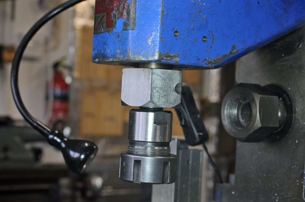

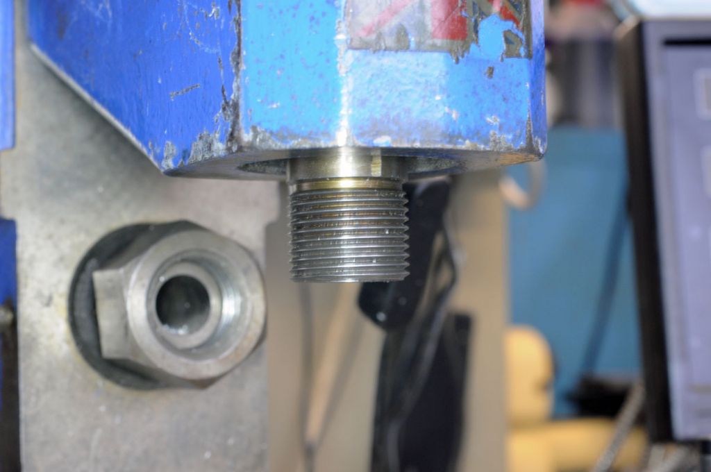

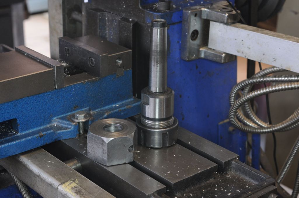

                        Franco,
                        I have a similar problem to you. My milling machine has a Myford nose thread on the spindle. My solution is to make a nut with the Myford 1 1/8" x 12 thread that screws on to the spindle before attaching the ER collet chuck. With the draw bar loosened, unscrewing the nut pushes the chuck out of the taper. The through hole of the nut is just larger than the big end of a MT2.
                        The nut you can see on the horizontal spindle is a nose protector and the through hole is bigger than the diameter of the collet chuck so that doesn't work as a remover although it does remove the horizontal arbor which has a bigger diameter than the ER25 chuck.
                        HTH,
                        Rod
