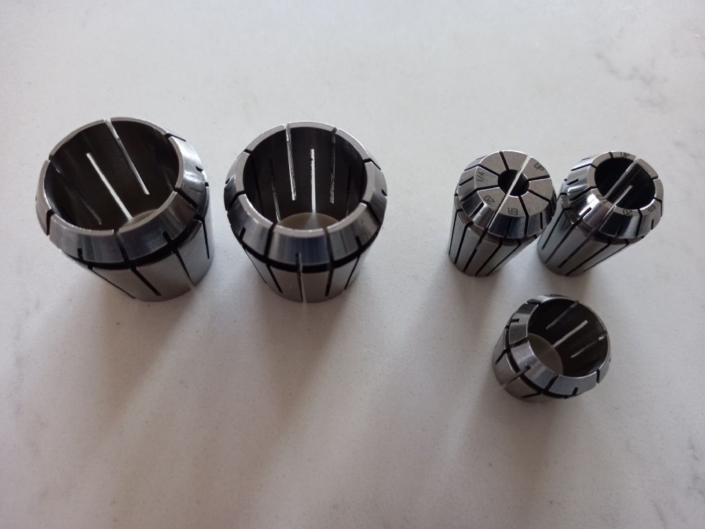

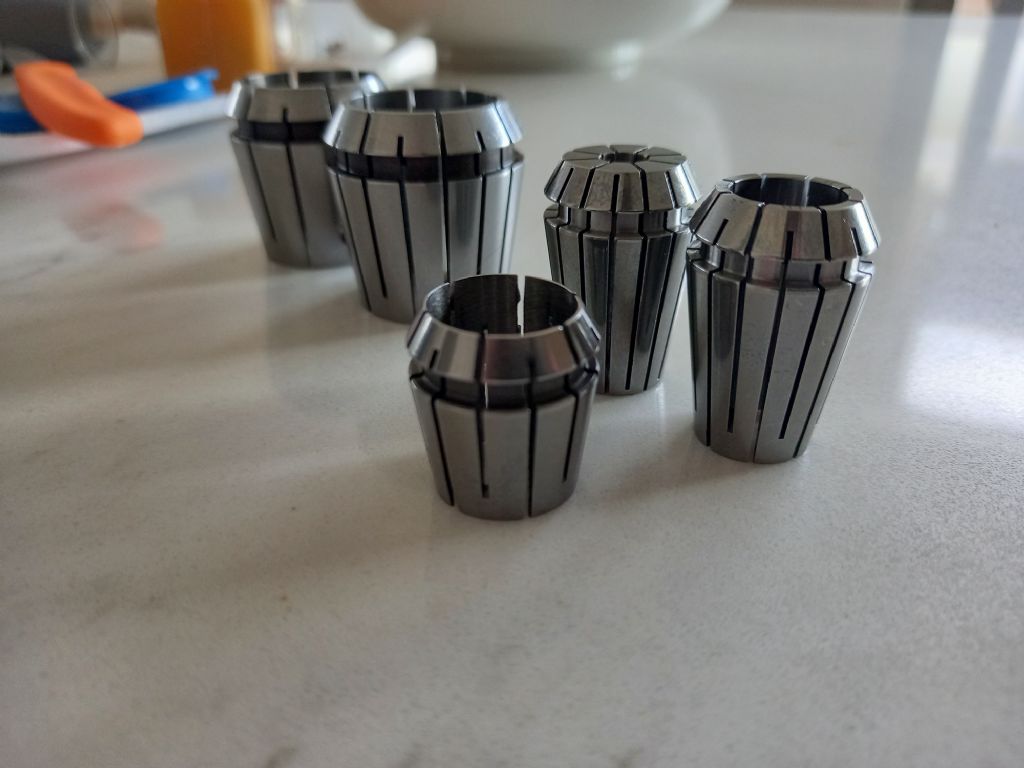

                          I just received these today. The short collets are from the oversized range . I got an ER20 Ø16, ER20 Ø12.7mm(1/2inch), ER20 Ø6.35mm(1/4inch), ER32 Ø24mm, ER32 Ø25mm.
                          They have the oversized collets in all from ER11 to ER40.
                          For me the over sized collets allow an overlap of the holders, so instead of using an ER32, I can still use the ER20, especially if I am using any of the Ø16 adaptors I made for the small ER11 collet chuck. The oversized ER32-24mm collet saves having to change out to the ER40 collet chuck. The two that I checked are very good, better than the bearing run out in my mill drill.
                          Cheers, Neil

                            Thank you for that.
                            Oversize ER32 collets are now on my need to get list
