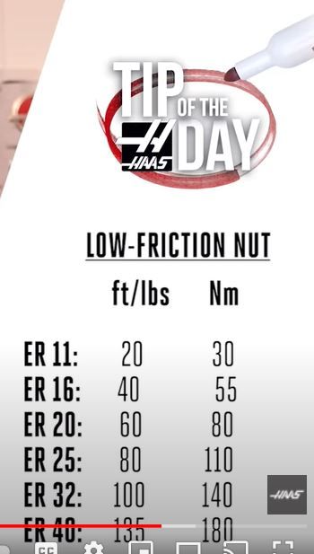

                          Actually torque for an ER16 is considerably less than for the bigger ER32 sizes something in the region of 40%
                          #595508
                          Dave S
                            @daves59043
                            And varies with collet clamping diameter as well as collet size.

                              #595560
                              Anonymous
                                Posted by JasonB on 23/04/2022 07:01:50:
                                70 vs 170 NM max according to my records so pretty close. (Recommended is 80% of that.) You can do your own conversion …. you're probably more used to it than I am on this side of the pond.
                                blush
                                … but unless the tests are made using at least reasonably appropriate (and repeatable) torques the runout results are not particularly meaningful.

                                                    And if you do decide to use a torque wrench then use a set of figures that are correct for your nut, you will not need to apply such a high setting for a bearing nut as a plian one.
                                                    Simple Hass chart for low friction nuts, ER16 is 40% of ER32, maybe Peters figures are for plain nuts as they are higher?
                                                    I'll just stick to using a spanner (shorter handle for the ER16 one) smiley

                                                    #595614
                                                    Hopper
                                                      @hopper
                                                      And that's with a low-friction ball-bearing nut? Wow. Getting up there for the ER32 at 100 Ft Lbs. That's Harley engine sprocket nut torque and usually needs the long handled 1/2" drive torque wrench. The ER16 at 40 Ft Lbs should be doable with a six-inch collet spanner and both hands.
