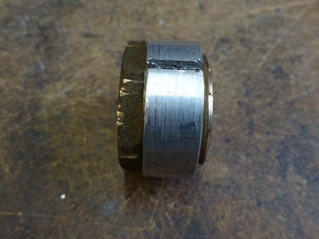

      Jim to return to your original post – have you got any nuts for the thread (is it a standard thread eg M20 – do you know what the thread is?)
      It is a a standard 1.5. The problem I'm having is griping the 4mm head of the plug and getting it to turn true.
      Forgive terminology I'm new to all this!!!
      #254208
      Anonymous
        Posted by Jim O'Connell 1 on 05/09/2016 10:39:31:
        That's because you're addressing the wrong problem. wink 2
        As Frances says you need to make a jig to clamp on the thread. Either use a nut or make a threaded bush. Ideally the nut/bush would be split so when you tighten the chuck or collet the thread is gripped firmly. I can't imagine that it is critical that the recess is exactly centred; a few thou out isn't going to matter.

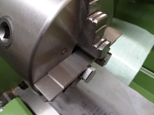

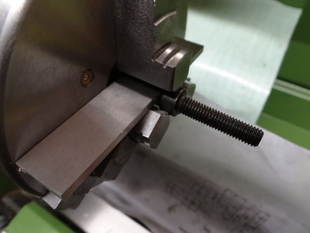

            Hi Jim,
            I'm at the inexperienced end of the spectrum so I'll be interested to see what the experts make of this.
            I'd use a bar across the body of the chuck to provide a flat surface against which the top of your plug can be pressed to get it at a right angle to the ways.
            Then press the plug against the flat provided by the bar near the tip of the chuck and tighten the jaws.
            I tap the bar out because of the trouble it will cause if it comes loose with the lathe turning!
            Probably not the best way of doing the job but it might be 'good enough'.
            I used two parallels as the bar only because they happened to be the right size to suit the bolt used as my example. Anything that provides a flat face to locate the work whilst allowing the jaws to be tightened on the job will do.
            Cheers,

                Dave, I quite often use the same method myself when faced with this problem, you just need to provide something that is square to the lathe for the back of the plug to rest against. Only proviso is as I mentioned before the head needs to be concentric with the thread which if the head was forged may not be the case.
                If faces with a bolt like you have shown rather than s stummpy plug it is easy to hold the thread of teh bolt in the tailstock 3-jaw while the main 3-jaw is tightened. This could be done with teh plug if the OP already has ER32 and a holder that fits the tailstock.
                Edited By JasonB on 05/09/2016 12:55:44

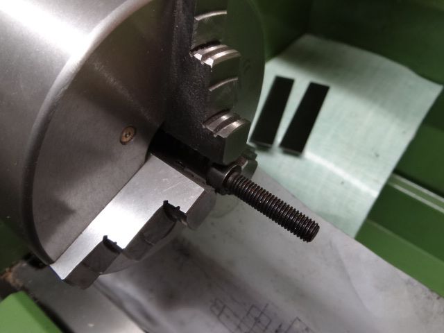

                    Bad use of words, I meant a drill chuck which would hold a small dia like Daves example.
                    #254264
                      Posted by JasonB on 05/09/2016 12:55:28:
                      Thanks Jason for confirming that the method I suggested isn't barking mad!
                      I also appreciate your useful tailstock 3-jaw suggestion. It could be done with a drill chuck in the diameters I most often hit this problem with and should be less of a fiddle.

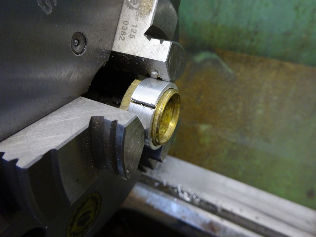

                            The split bush is probably the easiers option as Andrews says. I think a plain bore would give enough grip for what you want to do if you use a soft metal such as aluminium.
                            Assuming your plug looks a bit like the cap on the left then find an odd bar end that is just over the dia or A/F of the head, bore it out until the plug just slips in and face off to length of plug or a bit less. Take it out of the lathe and put a saw cut lengthways.
                            Now slip the plug into the bush
                            And you now have a longer length to hold the plug by which should help keep it from being held crooked and it will also be concentric to the thread regardless of head shape. Also minimum sticking out of the chuck so it won't get snagged by the tool.

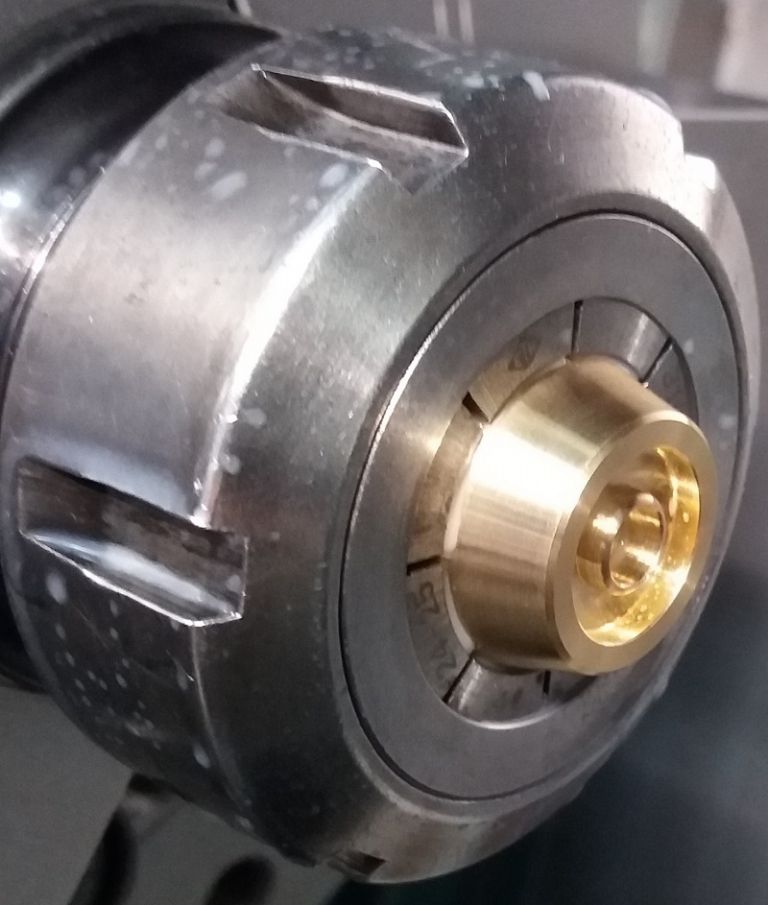

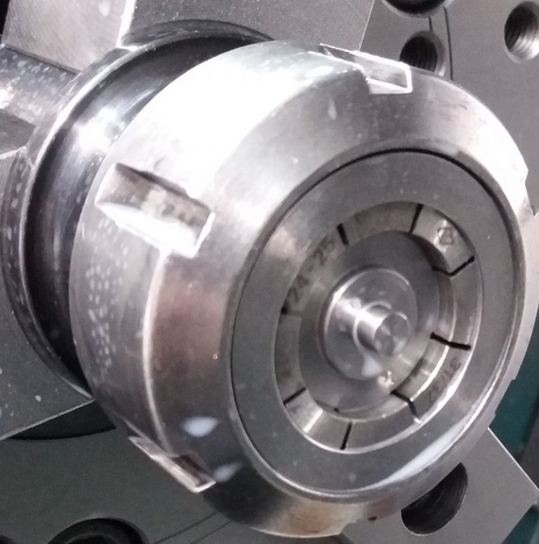

                                  With ER collets. I have made a collet fixture, I use at work. it goes into a dedicated set of softjaws. It has on the back a plate that is used as a stop. This is for ER40 collets. I have a set of spacers and also spacers that have the diameter of the work piece that locates into the last 5mm or so of the ER40 collet, with the front of the stop being used as a true face for the part to sit against. The area between the part and the 5mm engaged with the collet diameter is relieved a little, I make it smaller by 0.2mm in diameter. This allows me to hold onto parts sometimes only 2mm length to hold. Of course you only take cuts according to the ability to hold the part.
                                  This effectively makes the ER collet like a fixed length collet chuck, which is great for repetition of parts. I also make my own ER collets for specific tasks and only takes parts to a tight limit, Exact size or smaller by 0.02mm max. The collets I make , I only slit them from the front and leave the back as a single ring. The slits only go to about 5mm from the back of the collet. I drill a hole for the end point of the slots. If the parts need to all be the same length, then I make a stop block to suit. The stop blocks are held by a M8 capscrew. But a smaller similar system could be made fro ER30 or any other ER collet size.
                                  I can take some pics if anyone is interested and then add them tomorrow.

                                            I made a few counter weight blanks for my model plane single blade props. This is the ER40 collet set up I made and can use a variety of stops. In this case I made a stop that is 0.02mm smaller than the shape of the blank. It holds onto the 25mm od that only has 0.2mm length to hold the part for the 2nd op. The 5.98 mm spigot helps to stop the part from walking out.
