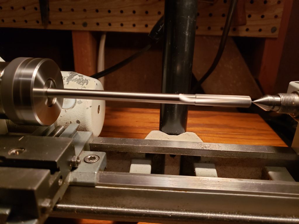

          Turbine Guy
            @turbineguy
            Posted by David Caunt on 04/03/2021 19:05:26:
            Now realise that yes I can use all the collets but the length is limited so if you are thinking like me then buy an ER25 mounting for a faceplate for the lathe. Then you can take up to whatever your lathe mandrel will take.
            I agree with Dave. If you can get a collet chuck that will let you pass the unused length through the bore it is a big advantage. I have a Unimat 3 lathe, so space is very important. The EMCO ER-25 collet holder allows be to do this. The following photo shows how much my reamer would stick out if the depth of the collet chuck was very short. Being able to pass the shaft through allows the amount of cantilever to shortened considerably.  I should point out that the lathe is running in this picture that was taken to show how little the run-out is with EMCO collet chuck.

            Howard Lewis
              @howardlewis46836
              Old Mart,
              I avoid the ****** smiley by leaving a space before the closing bracket , if it is any help!
              Having an ER Collet chuck on a morse Taper limits the length of material to little more than the length of the collet, before it hits the arbor.
              Having an ER collet chuck on a backplate allows work to maximum ID of the Mandrel to be passed through.
              I tend to use the Backplate type for workholding on the lathe, and the arbor type on the mill, for holding cutters.
