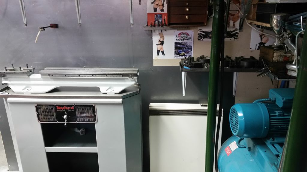

                                          Most of the work I intend to do on the mill and Super 7 is classic car related
                                          The Super 7 for me is a little on the small side but it will come in handy for screw cutting as it has the screw cutting gearbox,

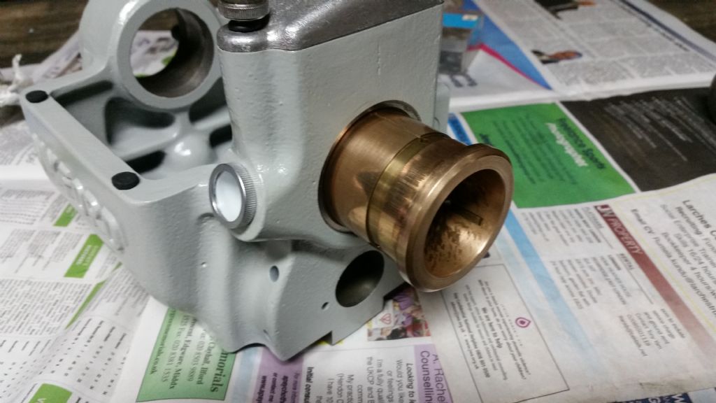

                                          I am half way through rebuilding the super 7.
                                          If i can side track for one minute
                                          My super 7 does not have a feed to the saddle
                                          can the screw cutting gear box be used as one or is it nor fine enough???

                                              Posted by Piero Franchi on 19/03/2016 14:23:43:
                                              There is compound gear in the gearbox, retained by a swinging latch, that is reversed for providing fine feed for the saddle. Finest feed is 0.002 inches per revolution, as shown on the legend on top of the gearbox.
                                              Rod

                                                I have the early super 7 WITH OUT saddle feed,
                                                I have yet to use it as I stripped it from day one,
                                                the saddle must get feed when you cut screws no ??????

                                                    Funny place to post this question. But when you say "without saddle feed" I guess you mean "without power cross feed" (pxf), right? The Super 7 has always had a longitudinal leadscrew for cutting threads and auto-feed, but pxf is optional.
                                                    Edited By John Haine on 20/03/2016 12:27:50
