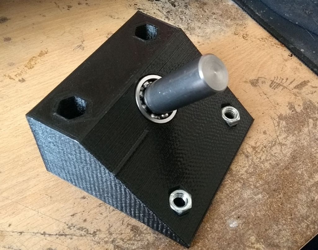

      I'm planning a platform to take my 10" scope with an angle of 52 degrees, so that with minor adjustment it will be suitable for anywhere in the UK – even Scotland if propped up an inch or so.
      Designs for the South bearing vary from a very simple 'pin in a depression' to a second conic section like the North bearing. I've decided to use a robust pin that's a push fit in a pair of ball races to give a secure but easily demountable solution.
      A nice combination of 3D printing and turning:
      Very chuffed with the fit – pushes in without shake
      I got some chatter when parting and had to follow my own advice of increasing the feed rate!
      The nuts are M8 and fill is at 40% so this is a pretty solid chunk of plastic.
      The pin will be glued into a suitable socket on the base board.
