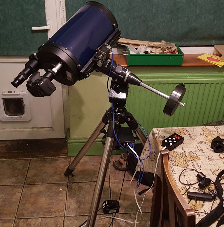

            I recently bought a Skywatcher Newtonian with EQ5 mount, sold the telescope tube assembly and then converted the mount to stepper motor belt drive using an open source microcontroller project: OnStep (STM32 based) controller  Check the Showcase page for examples of mounts.
            I can now click on an object in Stellarium and the scope points there and compensates for the earth's rotation. Mounts sometimes come up on the site UK Astronomy Buy & Sell
            But you can get by with a single motor on the Right Ascension axis to correct for rotation, or initially just manually with a knob or flexible drive.
