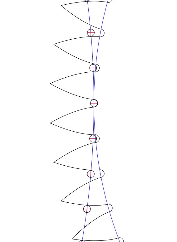

      Here is a detail of the external meshing, from the svg file
      Someone with superior CAD skills might like to check my assumption that it would lock-up if used with that tooth profile inside the ring.

      duncan webster 1
        @duncanwebster1
        I think the use of cycloidal gears for clocks was debunked a long time ago. I've quoted the link in previous posts. For involute gears, the tooth form for internal teeth is the inverse of an external gear with the same number of teeth. If this is a large number, straight teeth might work?

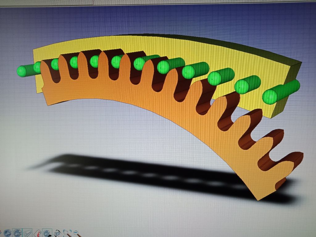

              Not my usual standard, but you know what I mean David.cheeky
              With too many unforeseen issues, I'm no longer able to take this much further.
              Anyway, who cares if it's cycloidal, involute, convolute, or even inefficient at this stage, you've got to start somewhere. A scrap of plywood and some panel pins comes to mind.
