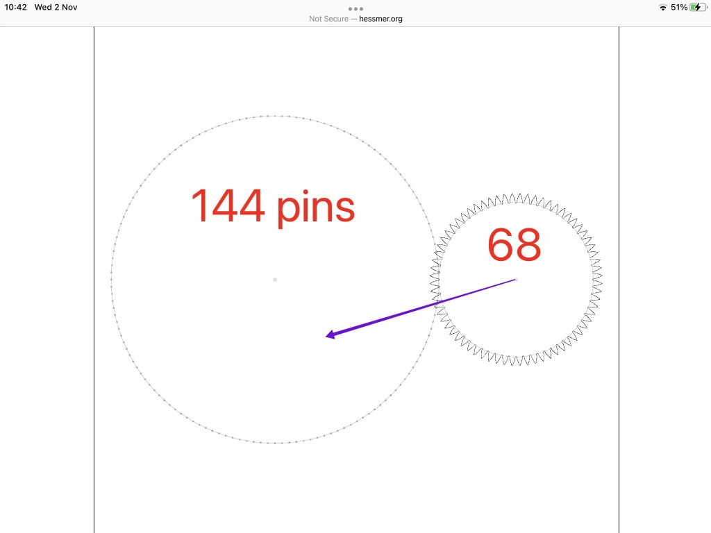

                                            Dr Rainer Hessmer will assist:
                                            **LINK**
                                            Online Lantern Gear Builder
                                            Edit: __ Yes, it does work with the relevant numbers,
                                            but I can’t see any way to get the “pinion” inside the wheel
                                            Edited By Michael Gilligan on 02/11/2022 09:00:29

                                              Wouldn't you use the pins for the internal teeth?

                                                I think that Sam was thinking of using the pins fixed to the face of the wheel rather then inside it but as you say, the pinion would not be inside the wheel.
                                                David

                                                  The other geometry, with radial pins [!], would be very difficult to make AND inefficient.
                                                    But presumably the teeth would need to be a different profile dont know
