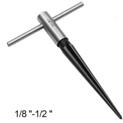

          Paul Lousick
            @paullousick59116
            Martin, Is the rc reamer that you refer to the same as this ? They are not only used for rc models but used in general industry.
            Avilable from Rc Components, ebay and local hardware stores.
            Paul.

                    Martin Hamilton 1
                      @martinhamilton1
                      Posted by Paul Lousick on 14/10/2020 04:14:56:
                      Paul.
                      Edited By Paul Lousick on 14/10/2020 04:16:44
                      Paul i also have one of the reamers that you show. The rc car body reamers are slightly different but with the same principle, the car reamers only have a single cutting flute. The rest of the reamer is a full tapered round shape, with only 1 cutting flute these reamers cut very circular holes indeed & pretty sharp for cutting plastics, thin aluminium or brass sheet.
