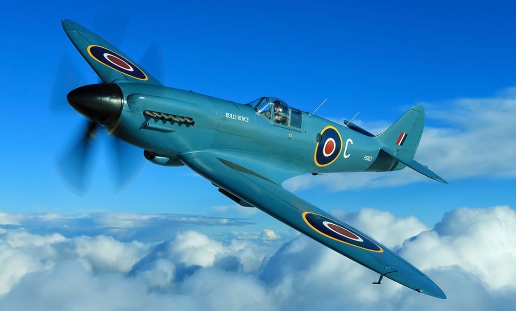

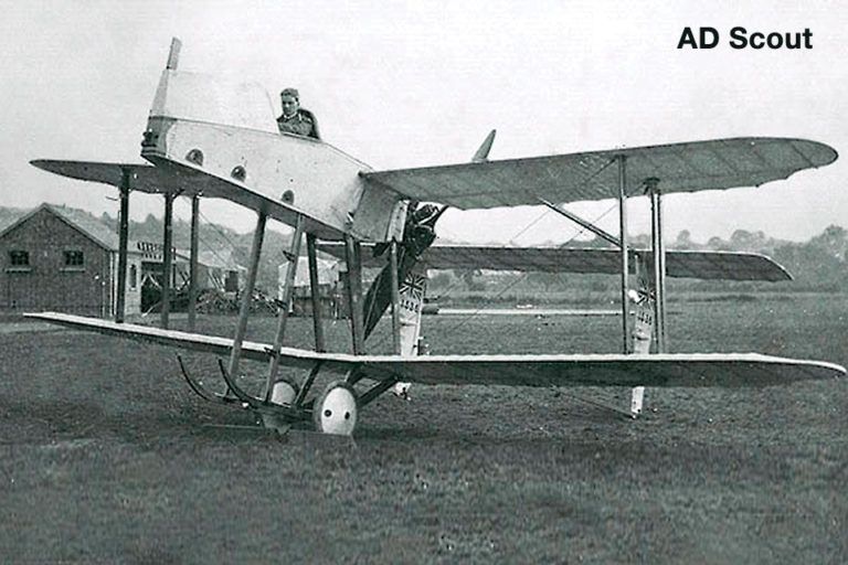

                                      Posted by DiodeDick on 09/01/2022 23:10:48:
                                      Engineering as Art:
                                      First define"art".
                                      While there is undoubtedly a lot of skill in producing an engineering drawing "the old way" is that really art? I do not consider a manufacturing drawing to be "art".
                                      The drawings in the ME article are not particularly good examples of engineering drawings – no tolerances for a start, too many items on one sheet, etc. , but nicely drawn.
                                      Although engineering drawings aren't intended to be art, they often tick the boxes needed to count as such. Same is true of the finished objects built from those plans.
                                      Quite often a design that looks right, is right. But if, and only if, the exspurts have done their jobs properly! Someone has to do the sums! These two aircraft were designed in their day to meet mechanistic requirements, but how attractive they look, 'art', isn't entirely accidental.
                                      Most agree the Spitfire has artistic merit. Is anyone turned on by the biplane?

                                        Posted by SillyOldDuffer on 10/01/2022 11:31:31:
                                        Wikipedia's comments on this biplane – especially the Operational History – say it all, pretty much as you might expect from looking at it… laugh
