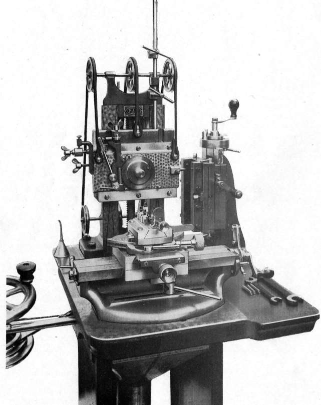

      one that shows the full complexity is the
      14in Independent Straight line Machine
      p04

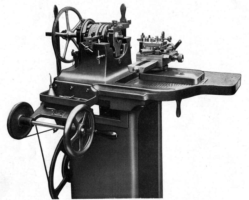

      Another is the Small Type Rotary Machine
      p12

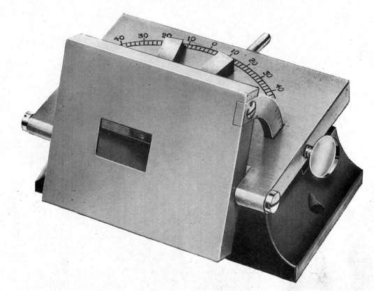

      A Goniostat or Tool Sharpener is also illustratedp13

            The machine looks like an updated industrial version of the earlier Holzaphel ornamental turning lathe, still used and demonstrated by  The Society of Ornamental Turners.
            As stated by Clive  above Birmingham had a large Jewellery and Watchmaking industry, so a more robust and easier method of operation would have required such a machine.

                The second machine is a Rose Engine. Slightly different from an ornamental lathe. A little research will show you the key features making it easy to identify.
                If you get interested there is a book ‘Ornamental Turning ‘ by famed model engineer Ted Walshaw.

                  The straight line machine looks like the Guilloche in Clickspring’s video:
                  Clickspring Guilloche video
                  Rod
                  Edit. Looking at the video again, both the rose engine and the straight line machines feature in the series of videos and a Harborne nameplate is shown.

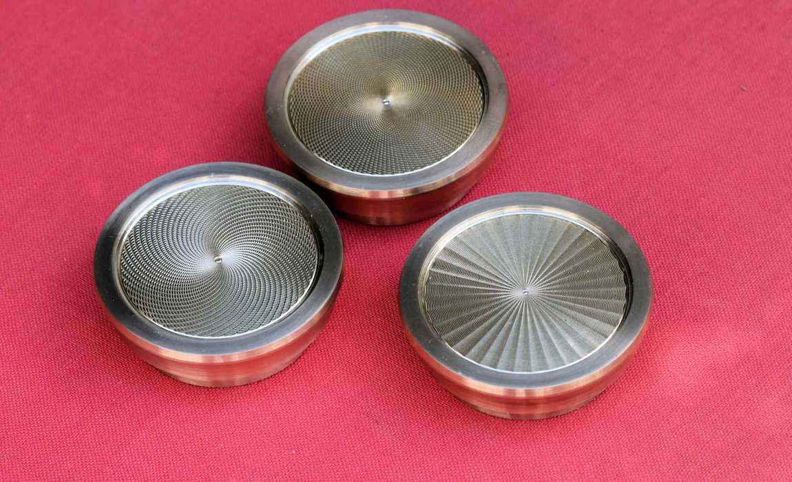

                    Just in case anyone is unfamiliar, these machines originally put fancy patterns on watch backs, but ‘engine turning’ is often applied ornamentally to other items.
                    examples_of_different_engine_turned_patterns

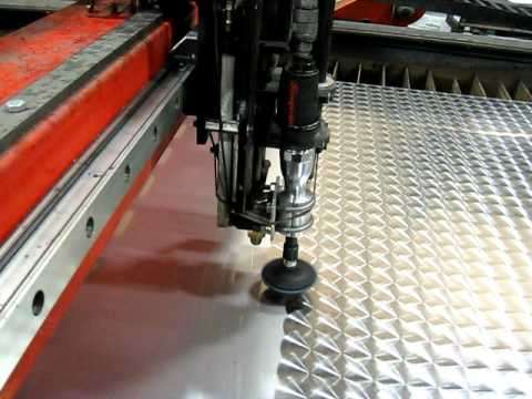

                    Different machine doing a flat plate:
                    hqdefault

                      It might not be the best to put that machine in the same category as the others. That uses an abrasive action (a rotating sanding disk applied at regular intervals to the piece). On a smaller scale, a wooden dowel charged with valve grinding compound can be used in a drill press. A lot of aircraft engine cowels were finished in a similar manner.
                      The finish shown is often used on stainless steel sheet; an alternative is a ‘brushed’ finish, and the machine perhaps more belongs with that, at a lower level of technology than an engine turning item.
                      To me, the important difference between the machine pictures in the first post and an ornamental lathe is that the first machine is for production operations on multiple parts (the watch cases). Once set up, it would not need a skilled operator: just a machine attendant to load and unload parts.

                        I’ll try and add the little I might know. Today the term engine turning doesn’t mean the same thing as it was once used for ornamental or those guilloche straight line machines. I guess technically it’s still correct and that’s how your book describes it, but it creates confusion about what’s actually being described without further context. Dave’s last picture of what’s meant today by engine turning or it’s sometimes described as jeweling by gun smiths is a completely different, much simpler and easier process since very good work can even be done using little more than a pillar drill, a flat faced wooden dowel of the correct diameter, abrasives and some basic spacing marks. A mill makes it even easier for the regular spacing and swirl overlaps. I’ve done a little of it, and it’s simple, but not quite as intuitive as one would think for some of it. For the best effect, the work piece needs to be highly polished first, and the abrasives should never be wiped off. Instead they need to be washed off so the surface isn’t affected by straight line scratching any wiping would cause. For the best results, how much down feed pressure is applied and for how long almost to the exact second is also highly important to get the same depth and level of light reflection from each swirl mark in the metal. Any minor errors in technique show up as something that’s instantly and easily noticeable. Engine turning by today’s definition does have one thing common to it and ornamental turning or straight line work. They all use the light reflections in the same way to catch someones attention. So in my opinion, there loosely related, but still not the same thing since straight line or ornamental turning uses in general much deeper cuts and much more precision.

                        Rose Engine lathes were also built with one or two extra motions our lathes can’t do. They used rosettes or more descriptive, multi lobed cams attached to the spindle and the head stock could rock the amount the different cams had for lobe design and the high and low offsets each of those different shaped rosettes had. Some rose engine lathes could also follow cams that forced the lathe spindle and work piece to move back and forth in a lateral direction. A pumping action would be used by ornamental turners to describe it.
