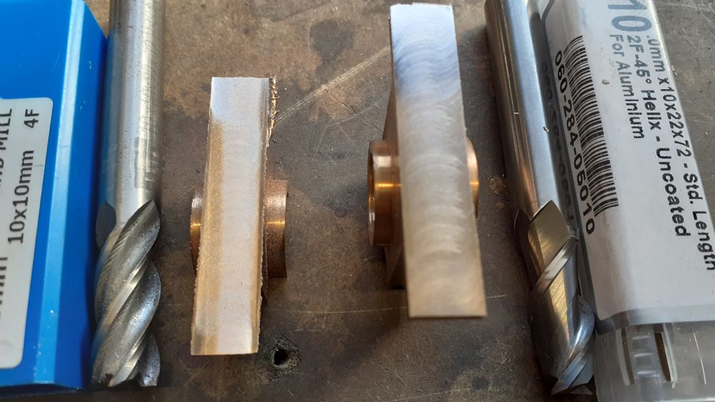

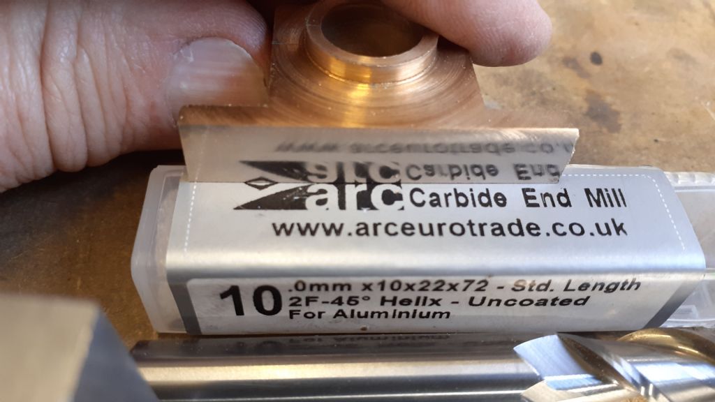

                                                    #535433
                                                      Well I had thrown a couple of Stuart bearings into the scrap as I did not use then on the just finishe dVictoria so dug them out and took a couple of cuts. I'm assuming Nick is using the end of the cutter to clean up the 10V parts as there is not much else that needs milling.
                                                      First up was a 10mm dia HSS 4-flute cutter of the cheap far eastern type that has been used on a bit of everything and the corners were starting to look a bit worn but it cut quite well and did not leave too massive a burr though you can see it is pushing one along the edge. 2000rpm, 240mm/min feed 0.5mm DOC x 9.5mm width of cut. The SX2P may need a slightly slower feed than my X3.
                                                      Then to my cutter of choice for the last 3 or so years for aluminium and non ferrous. One of Uncle Ketan's aluminium specific Carbide cutters, again 10mm dia but only two flute so a reduced feed rate. This cutter has been used a lot on a mixture of non ferrous but not on steel or iron and is still performing well. hardly left any burr, what was there could easily be removed with a couple of licks of a needle file. 2000rpm, 175mm/min feed, 0.5mm DOC x 9.5mm width of cut, again SX2P may want a small reduction in feed.
                                                      Not the best side by side by side photo, I've not removed any burrs
                                                      But not a bad finish from the ali specific one.
