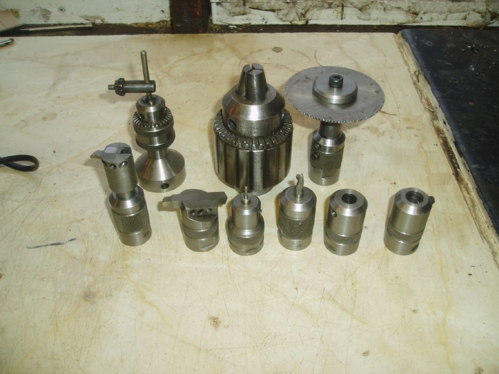

                                        #62396
                                        Nobby
                                          @nobby
                                          Hi
                                          These home made cutter holders is
                                          an  an alterative to holding cutters in my drill chuck on my kerrys drill. the abour is scerwed to an insert in the drift slot
                                          Regards Nobby
