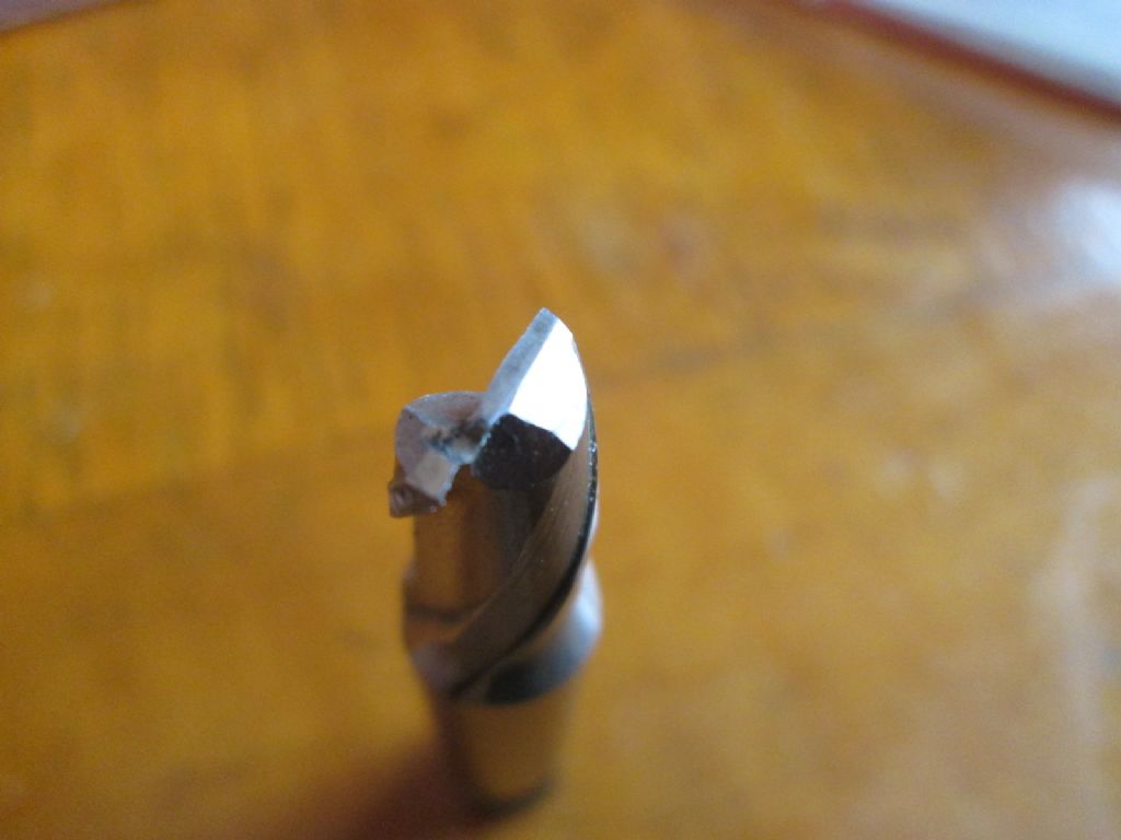

      I've just completed the end-mill accessory for the Worden, and am keen to try it out. I need to establish the correct angle of relief behind the end-face teeth on an end mill. I can find plenty of learned treatises which refer to it as 'dish angle' or 'end relief', but nothing which tells me how many degrees it should be. The usual helpful books (Sparey, Bradley, Tubal Cain) don't seem to specify it, and it doesn't appear in the Workshop Practice series books I have either. The end-mills are the sort of tool-steel items used by model engineers 30 years ago, and will be mainly used on mild steel and brass, in a Myford VMB mill.

              Some others call it 'axial relief', with primary and secondary values.
              Unless you're hogging out volumes of metal, I dunno if a secondary relief is really necessary.
              I couldn't see a ready value for either of 'em on the net, but general knowledge would suggest trying somewhere around 15 degrees for (say) mild steel, then suck it and see.
              I've got an 8mm slot drill that I sharpened offhand, and I don't even know what the relief angle is, other than it looks about right and works well.8mmslotdrill.jpg

                                  Holding a straight edge against the face of even a 1/4" slot drill showed distinct slivers of daylight touching the straight edge at the periphery. The slot drill has had very little use, mostly on delrin, and I'd guess the dish angle could be as much as 5 degrees.
