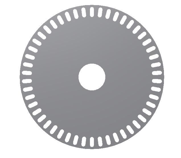

        Hi everyone,
        I am very interested in building an electronic gear box as referred to in MEW issue 108 and noted in this post.
        An encoder is needed but these look quite expensive to purchase, so I would also be interested in building one of these as well. There is some good info and photo in this thread.
        The electronic gear box circuit in issue 108 requires a phase A and phase B input from the encoder at 2000 pulses per rev of the gear hob.
        My question is how do I set up to get these phase A and phase B inputs?
        I have seen "quadrature" mentioned, but how does this work?
        I think the following will be the case but I am not 100% sure.
        1. If I can make a 50 slot encoder disc (to keep the diameter a reasonable size).
        2. Then have 2 photo electric switches to give phase A and phase B inputs.
        3. Then arrange these switches so that one is set to switch at the leading edge of a slot (Phase A) and, at exactly the same time, the other set to switch at the trailing edge of a slot. (phase B) (I am very unclear on this point an how this gives the "quadrature".
        4. So with 50 slots and quadrature I get 200 impulses per rev of the gear hob?
        5. So to get 2000 impulses I need to gear up the encoder disc by 10 x the gear hob speed?
        My knowledge of electronics is extremely limited, any pointers in the right direction will be very much appreciated.

            #102518
            GoCreate
              @gocreate
              Thanks Michael and Michael, very helpful info.
              I now understand the quadrature issue much better and how to place the photo switches.
              I am busy sourcing the parts, some of the Farnell part no.s don't exist any more so I am having to source alternatives, great funfrown.
              I am thinking of making the encoder disc with 3mm slots and using the photo switches specified by John S in the thread previously referenced. With 3mm between slots the disc come out at 107mm. I think this is manageable, 2mm slots would be better, I presume it depends upon the switches. I would rather play it safe and not get to fiddley.
              Cheers
              Nigel
              #102520
              jason udall
                @jasonudall57142
                I have in the past used saw cuts..
                Also holes work well and are easy. and this would allow for second track and " gear ratio"
                any appature bigger than say 0.1 mm will be fine
                I would recomend photo interuptors with scmitt detector outputs.. (..) all the lowlevel signals are internal to the device and noise just goes away smiley
                BUT IF DOING SO OBSERVE POLARITY they don't like it up 'em
                A zero index hole might prove helpful in the future so put one in now…

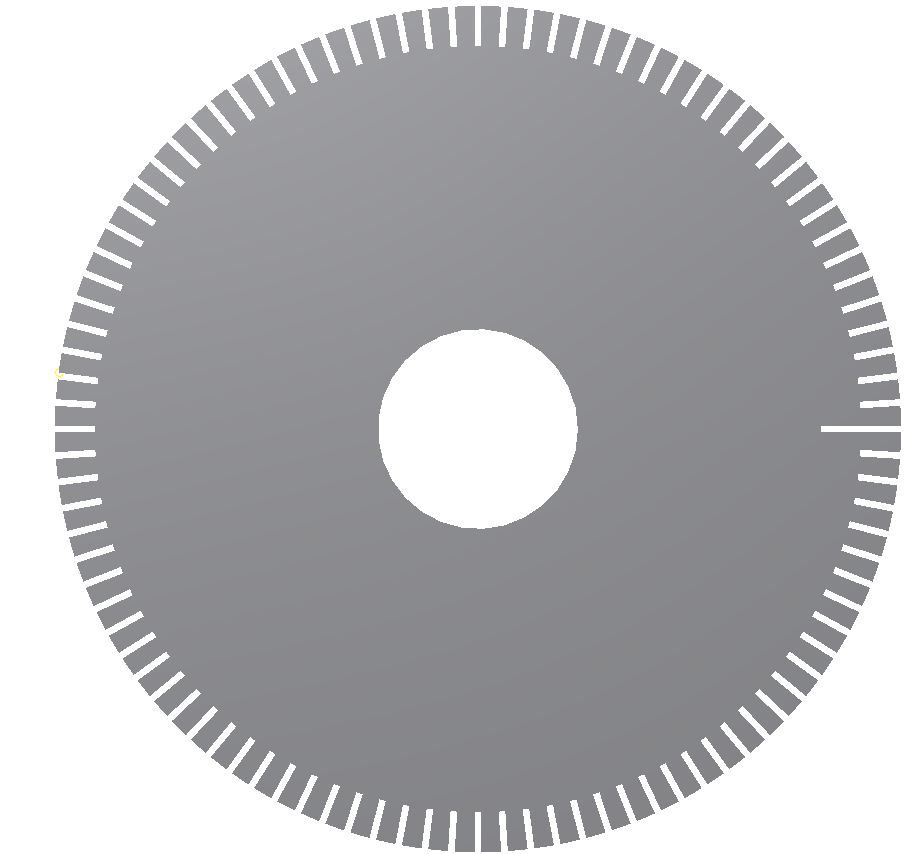

                  GoCreate
                    @gocreate
                    Hi
                    Jason, thanks for your post, very helpful information.
                    Neil, I am asking around for an old mouse so I can have a look. I am finding this very interesting but still a little confusing.
                    This is my latest encoder disc now at 63.5mm dia. with 100 – 0.5mm slots. Material between slots is nominally 1.5mm wide. So to get 2000 pulses I would have to gear it up 5:1.
                    Am I correct in thinking that so long as I place one photo switch in the centre of a slot and the other in the centre of the material between the slot I will be OK?

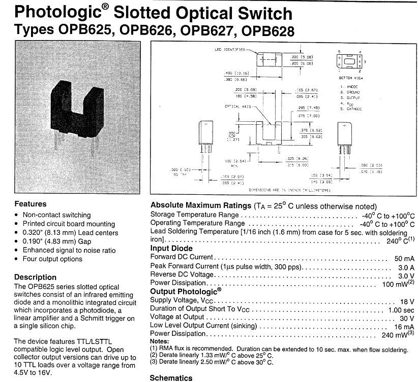

                    I thought this photo switch might be OK.
                    Cheers

                    #102831
                    MICHAEL WILLIAMS
                      @michaelwilliams41215
                      Hi Nigel ,
                      (1) The count wheel is acting in exactly the same way as an index wheel on a dividing head – whatever errors there are on the count or index wheels get copied onto the workpiece or into the elctronics .
                      With one count per slot only the general spacing on the pitch circle matters but when trying to get four counts per slot both the spacing has to be correct and all edges have to be equally spaced . This effectively means that solid tooth width = space width .
                      (2) The solid tooth width has to completely cover the active spot in the slotted switch and with some margin otherwise the switch may never turn off and you won't get any signal . If , for instance , the active spot is 1 mm wide the minimum solid tooth width has to be at least 1,5 mm and preferably 2 mm or more .
                      (3) Gearing up count wheels to get more position counts is chancy . You certainly get more counts but accuracy of true position readings can be much reduced .
                      If you actually need 2000 counts/rev there may be better ways of doing things .
                      (4) Work out at an early stage how many counts per second the photo switches will have to cope with . The simpler type photoswitches are not that fast responding and if you are trying to count at high speeds you may have to use more sophisticated switches .

                          Neil (Stub) – I think the requirement for symmetric waveforms will depend on the subsequent electronics – IMO most 'dumb' electronic systems (TTL, CMOS, etc) would probably clock on the edges of the pulses, implying that so long as the waveforms were present with reasonably fast edges, then the symmetry is not so important for a simple system using only leading edge detection.
                          However, one way to increase the number of pulses per rev is to use both the rising and falling edges of the waveform, and in that case, the quadrature waveforms need to be symmetrical, otherwise the pulses will tend to occur in pairs (two pulses, followed b a longer gap, then two more pulses – hope that makes sense). It is easy electronically to detect the rising and falling edges and combine them to provide quadrature pulse trains, providing two pulses for each slot in the wheel.
