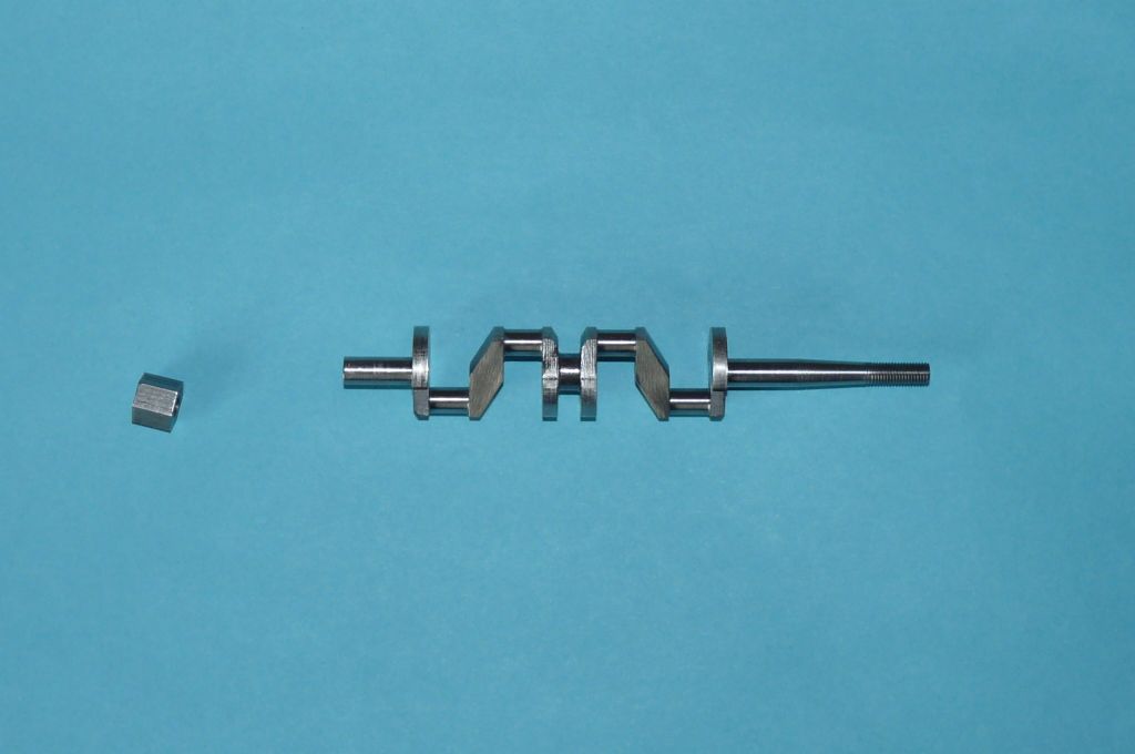

                  This feels like I'm swanking a bit – however here is a crankshaft I made made from EN8. All done with HSS on a Sieg C6B lathe. Sharp HSS is the way to go to get a good finish, with the tool height set right and the tool the right shape. I have no facility to deliver flood coolant, so can't comment on that.
                  Although my lathe will run at 2500 rpm and I can take decent cuts with tip tools, and it will deliver a good finish, it's all bit too frantic when I'm trying to get those tiny journals dead to size. (Within the ability to measure of course…)
                  Steve

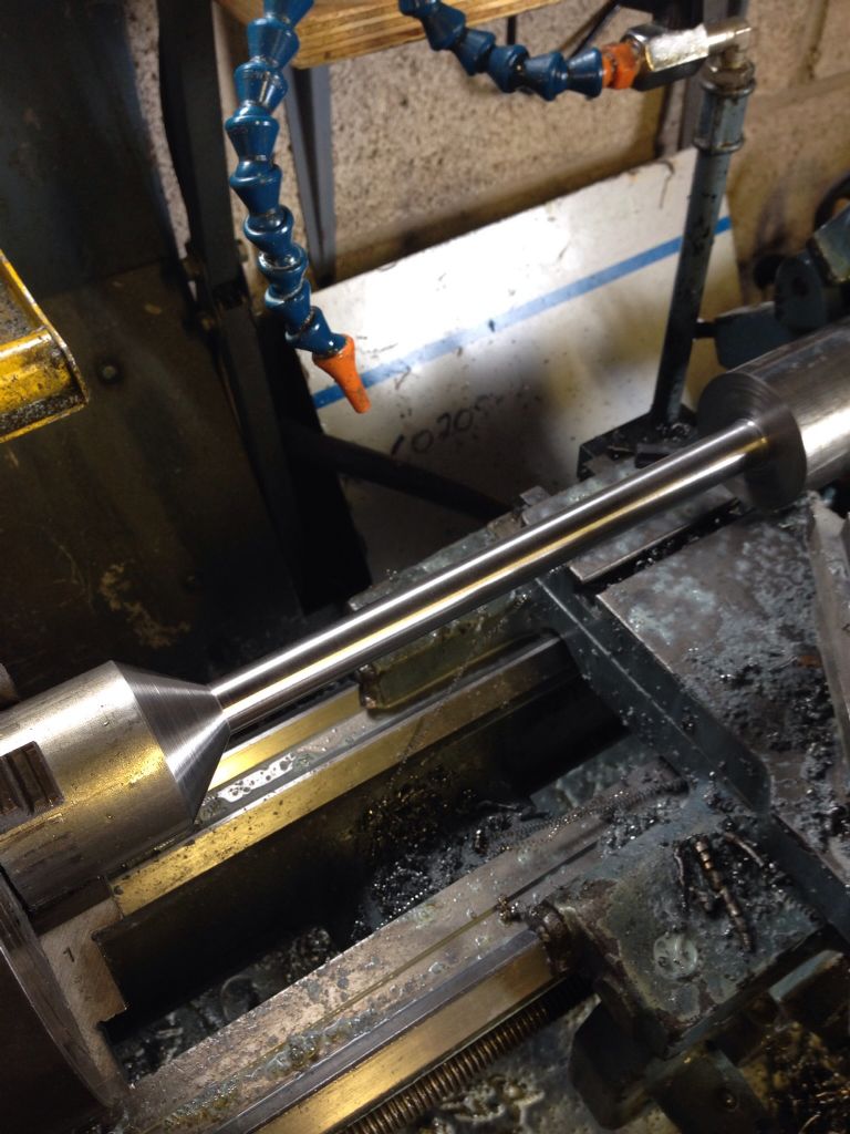

                      2 en8I took all your advice from the above comments and have made a great start on my con rod. I roughed out with inserts and finished with hss.
                      Bri.

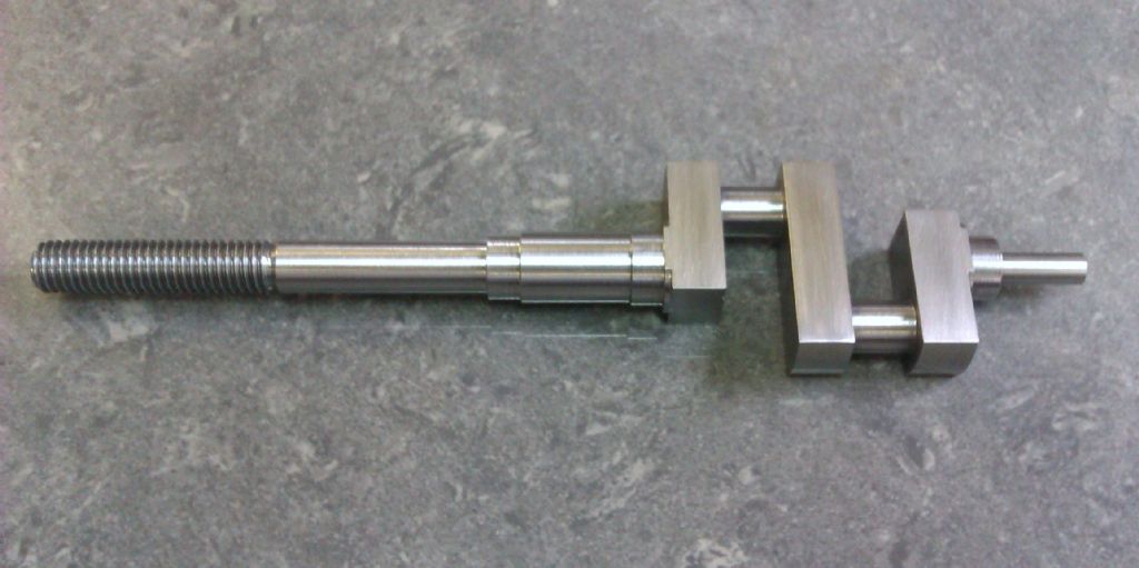

                                Again EN8, roughed out with tip tools as far as possible then many hours with tiny HSS bit's (eg using what would conventionally be parting off tools with a bespoke "grind&quot.
                                I did try to straighten it in the lathe, but it broke…

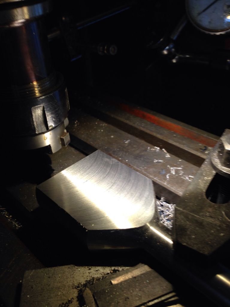

                                      image.jpgWell you all make my efforts look tame, however I am enjoying making the con rod.
                                      Jason your work is to be admired and most of us wish we could produce the amount of work that you turn out, however the day job and domestic scene get in my way + travelling to Wales most weekends.
                                      I have now moved the con rod to the miller to put the flats on it.
                                      Rather than multi- cut with an end mill I decided to fly cut it. I will probably have to emery the finish a little but it seems to cut ok.
                                      When I finish it with the fly cutter I will try a faster rotation and take about .1 mm cut
