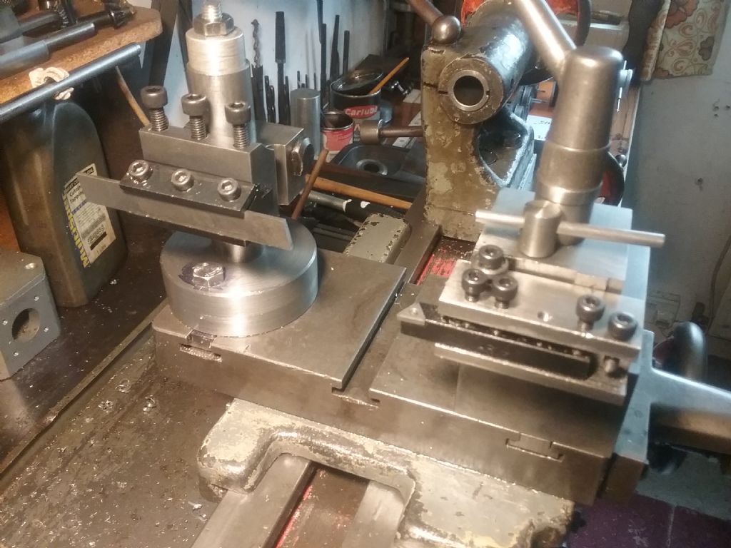

                          20180830_114246.jpgMacc metals, shopping partner on MEW Home page, £ 15 for 2"×2"×1×", Bms, + delivery and vat, I have used loads lf this their steel is good quality, Have not tried welding it. Machines well and I used it to make a version of Harolds Qctp plus other tools
