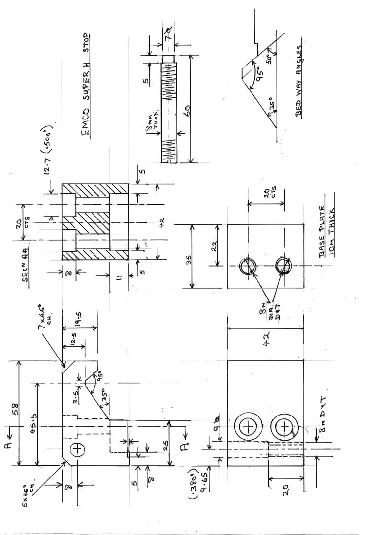

      I have an Emco V10P lathe, and need to make a carriage stop for it, but the bed ways are rather an awkward shape, I have included photo's and a tracing taken from the tailstock end of the bed in my albums.
      I do not possess a tilting vice or a sine bar, can anyone suggest a way of making an accurate stop for the carriage please.
      I do own a milling machine.

          You could try something like this:-
          The angle of the 'V' bed on the Emco looks to be at 90deg but one side longer than the other. You may be able to modify my design a bit,. Drawing and build ***HERE***

            Looks as if you have a small vertical step at the bottom of the triangular guide on each side. A simple rectangular slot engaging on those vertical steps would probably give sufficient location when fixing a bed stop. Less than elegant tho'. The job would be neater if something fairly close to the triangular section above the vertical steps is cut by whatever means you have and the gap filled with metal loaded filler. Press the filled slot onto a well lubricated section of the bed to get the shape just so. Once its painted the filler won't show.
            One advantage of the using filler to get the right shape on the triangular part is that a fairly rough job is actually better than a super smooth machine finish as giving plenty of nooks and crannies for the filler to grab. The good metal loaded fillers tend to be moderately expensive and come in pack far to large for a single small job. JB Weld is easier and cheaper to find and works well provided the layer isn't silly thick. Advisable to put dams of some sort in if using JB Weld as it can slump. I've used duct tape and plasticine for dams in the past. Worked well enough.

              Chris, As Clive says Journeyman John has posted a good basic design however I have a factory stop on my Super 11 lathe and looking at your photos of the V10P bed it looks identical so I'll go and do a drawing of my stop but please PM me with your email — never got to grips with posting drawings on here. My drawings are done long hand no CAD etc and the only way I can send them is scan to PDF etc and email them.
              Incidentally the clamp bolts are the same as on the 1024 i.e. on the top — much easier to use than when underneath.

                      Thank you all for the replies, I have measured the angle of the lathe bed way and unfortunately it's 85 degrees not 90
                      So I am going to go the sawing and filing route, was hoping to use an end mill and create the V in the stop.
                      JohnF, I have sent a message with my email address, thank you for the reply and the offer of the drawings.

                        Hi Chris I have created an album on here with some photos and a drawing of my bed stop, the Super 11 bed is 95 deg ! I also have a pdf of the drawing but cannot get it to load !!!
                        You also need 2 off 8mm bolts, 2 x 8mm washers and 2 springs — see the photo's,
                        springs are O/D 0.473"  ;   Wire 0.031"   ;   1.500" long

                          We ordinary forum members can only load JPG files. … hence my offer, yesterday.
                          It appears, however, that the drawing you have posted is entirely adequate.
