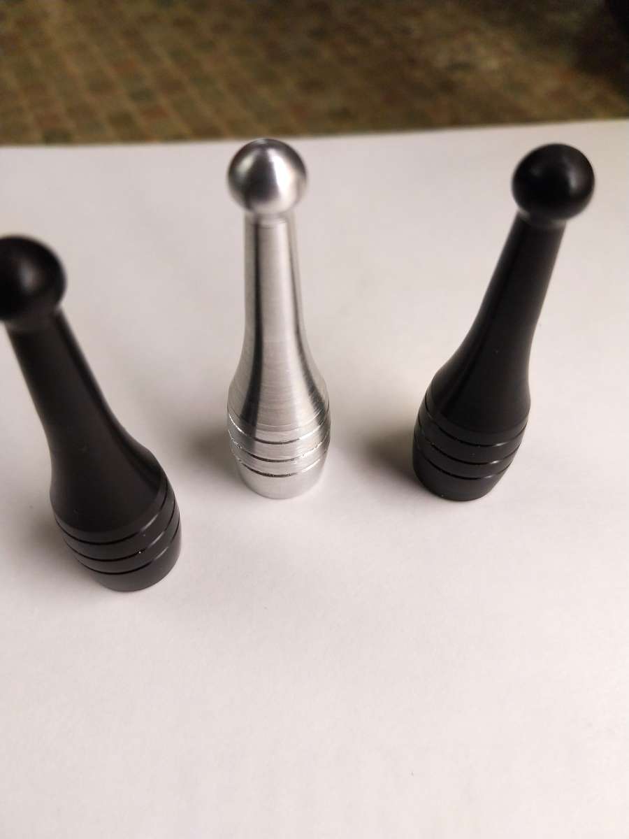

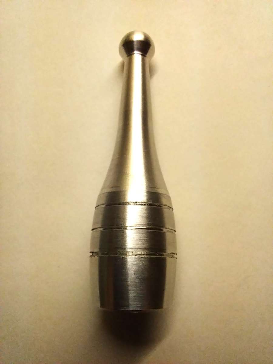

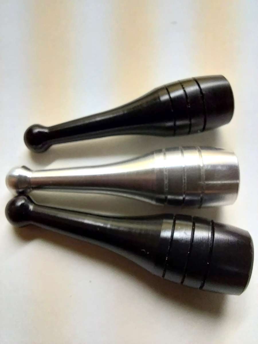

                                        Emgee
                                          @emgee
                                          Update for those interested, I have found that when the command line overfows I can go into the line and using the edit command add further characters into the line so completing all info required for the command to function.
                                          The turning and facing cycle command line/s for the Emco Compact 5cnc are so much simpler to enter and carry out the same function with just 5 parameters.
                                          After getting the tool offsets sorted I loaded an example program from the Emco program manual to turn a Bowling pin, these came out OK after adjusting spindle speed and feedrates for turning and parting.
                                          Still a huge amount to take on board but progressing slowly.
                                          Emgee

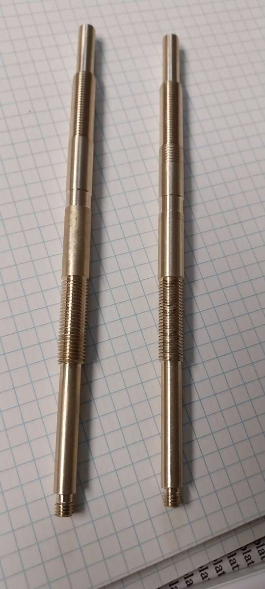

                                          #702278
                                          Emgee
                                            @emgee
                                            Got a turn and thread program running to do some brass parts so all is not lost but still having some programming problems with G72 turning cycle.
                                            2 shafts 23.12.2320231223_161107
