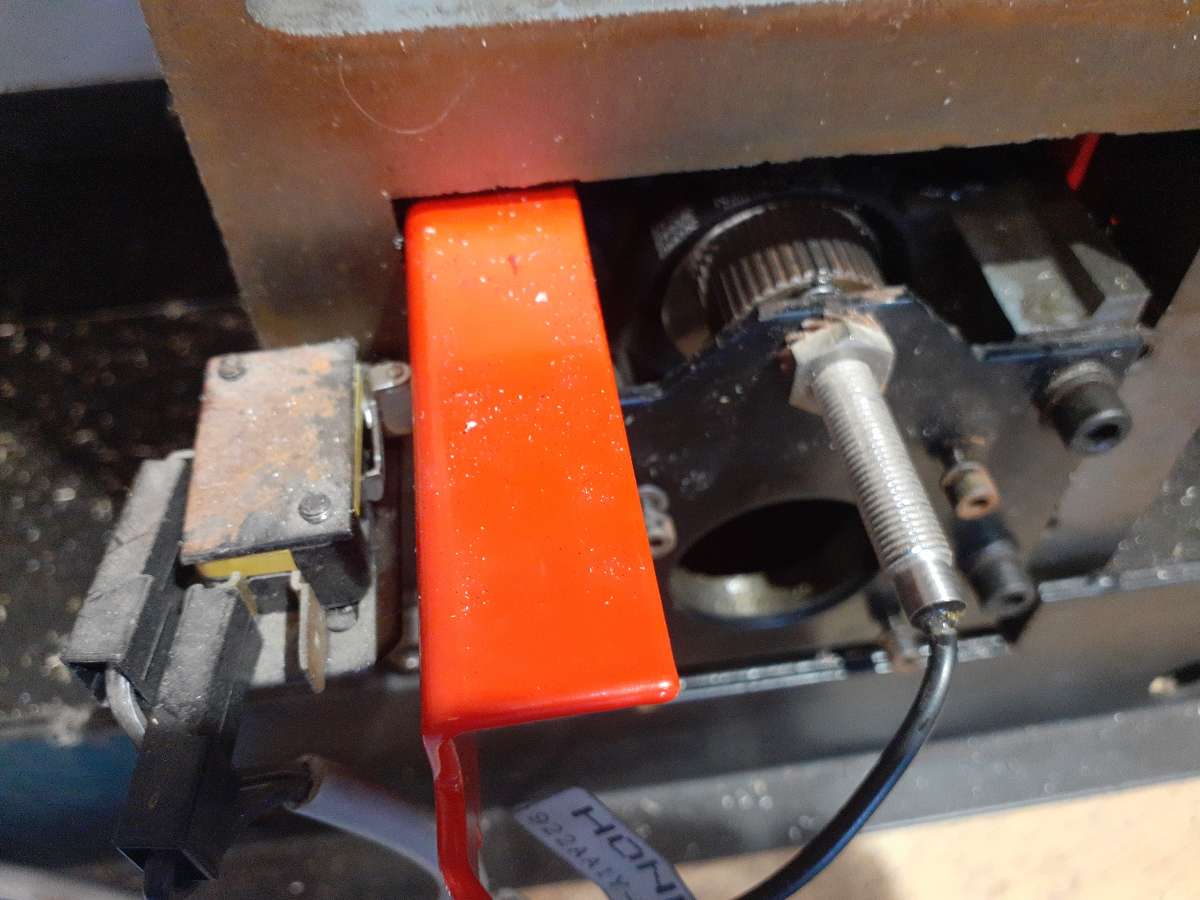

Currently I’m carrying out a retrofit on an Emco PC 50 Mill that I purchased in June. So if anyone is interested I will post images of my progress and info on what parts fitted and where purchased.
But I’m hoping there is a CNC God on here, who can identify this sensor. I think it is a hall sender which is made by Honeywell, and most probably counts the turns of the ball screw when the machine is operating. Before I removed the humongous 32 kg control cabinet, these sensors where connected to blocks that were related to limit switches.
Ideally because of the quality of this machine, I would like to incorporate them in the refit, that is of course whether Mach3 or Planet CNC will identify them in the circuitry.
