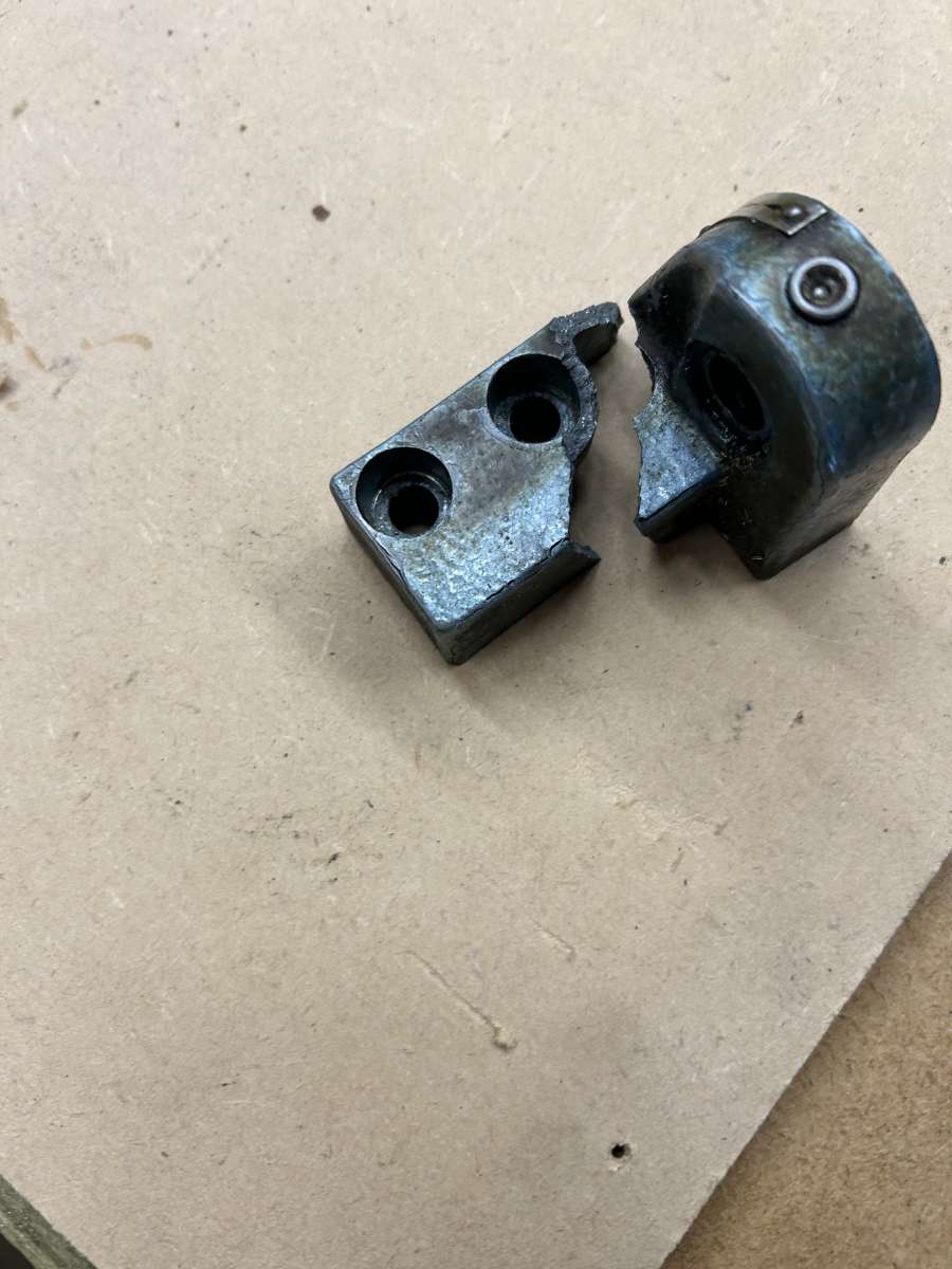

      I have just taken delivery of the above but it has suffered some damage in transit. The bracket holding the lead screw to the main lathe body at the tailstock end has sheared in two.
      Any ideas on replacement parts at all?
      Thanks

        No spares at EMCO Austria, none at EMCO in South Africa either – unlikely to find as a used part since it would probably be attached to a whole lathe…If you are not averse to joining Groups.io you can try the EMCO V10 group – good folk there – https://groups.io/g/emcoV10lathe/topics.
        ELse just make a new part – it is quite a simple part- from aluminium, you could even get away without the bronze bush if lazy.

            I think that’s a part from the power cross feed version but similar concept
            IMG_0201IMG_0198

              As said before quite a simple part or there is silver solder or brazing with manganese bronze rods.

                    Looks like cast iron, if so then arc welding with nickel rods was used to repair a broken cylinder casting on  narrow gauge railway I worked on. You’d need to find someone who already had a box of rods, they are very expensive.
                    In these modern times I wonder if JBweld would be strong enough. The fractured surfaces should knit back together as CI is very brittle.

                        Since the back is hollow, Duncan’s suggestion of JBWeld, packed into the hollow, seems promising, and it avoids the possible distortion or cracking (a risk with something as thin-walled even with careful pre-heating) from welding.
                        #775547
                        John Haine
                          @johnhaine32865
                          Might it be possible to combine JB Weld with inserting a couple of bolts to reinforce?  Glue first, then drill clearance holes.

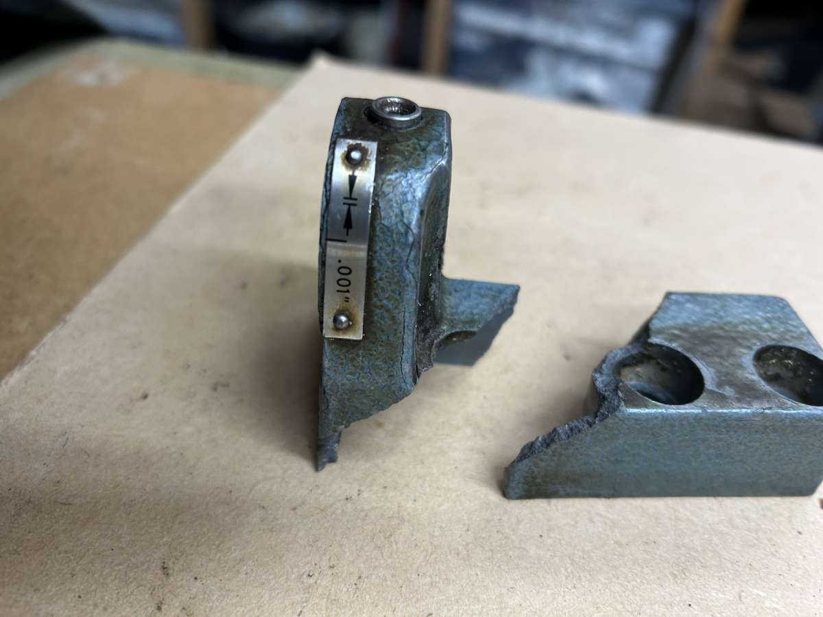

                            These brackets on Emco Machines tend to be a Mazak (or Similar) die-casting. I know on the Emcomat 7 which I had, which was a forerunner of the V10, and on my Maximat Super 11, which was the V10 successor that this was made of Mazak.
                            Given the thrust exerted on this bracket from the leadscrew a new part made from aluminium would be a much better solution.

                              Indeed it is Mick that’s a V10P part with the extra feed shaft hence the two bearing holes.
                              Please check the leadscrew is still straight before you have it welded. Also be aware that the casting is very likely to warp during a hot process. Yours has also cracked around the end corner as well.

                                i think you are right. This piece has a number
                                of hairline cracks around it .
                                The seller has kindly agreed to take it back and have a new one manufactured.

                                  The fact that it is covered with hairline cracks means the metal is suffering from Hydrogen Embrittlement. A lot of the early diecast materials suffered with this. It was an accident waiting to happen.
