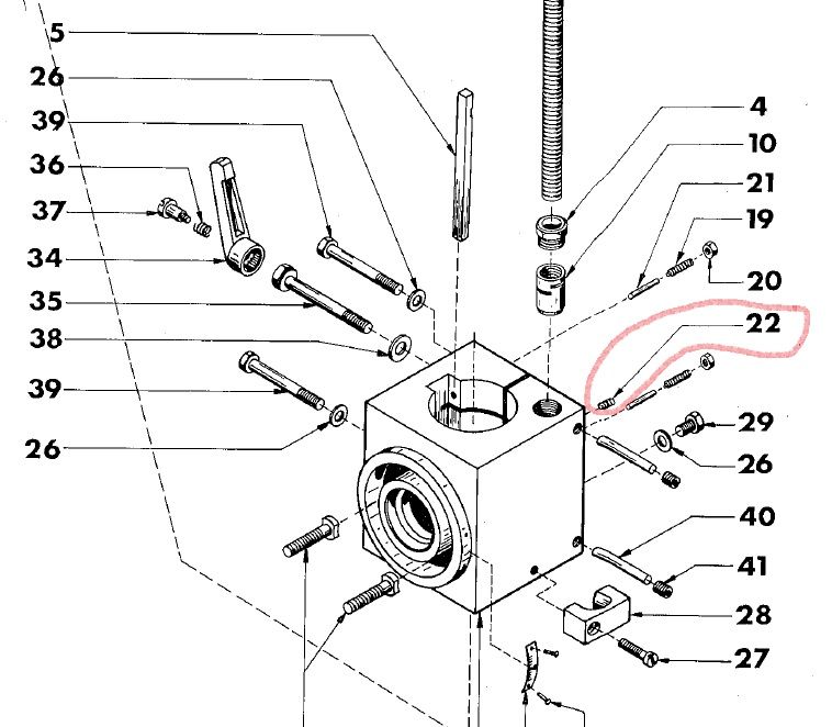

      The head of the mill suddenly could not be moved upward during use today. It didn't take me long to find that the problem was due to the thread of the Z axis nut partially stripped. I removed the stripped threads with a boring bar and the mill is now working again but it probably will not last long. Would like to hear from FB2 owners your solutions .

          How 'partially' stripped? If the head would not move while the leadscrew turns, then the nut is stripped properly..How did you 'fix' this by boring out stripped threads?
          I have 3 FB2's – One is cnc'd with ballscrews, but the other two have the original Z nuts in, one still OK after 32 years, the other after 21 years.
          I do however have a spare set of XYZ nuts, obtained from EMCO 2 years ago – they still have stock..
          The Z nut is a simple one to make though – if you can find a piece of 7075 aluminium bar stock that will work just fine.
          The thread will need a inner pointing tool ground , but that is not to difficult I would think.The thread is quite short in that nut so the tool need not be very long. When I obtained the second FB2 (pre-owned) , it was imperial and I purchased metric leadscrews and nuts and dials (2001) and swapped out so I have a set of new imperial screws and nuts in the cupboard…I did investigate shipping costs to the UK for another fellow interested in some other FB2 parts, and from Namibia it was horrendous – near 170 pounds to the greater London area!
            I haven't taken any pictures but the nut has two slots cut half way across the body at the upper end. These two slots are meant to be for backlash control. By compressing these slots, the threads in that portion will shift relative to each other so the backlash can be eliminated or reduced but that's IN THEORY. The same design is used in the cross-slide nut of my Emco Compact 8 lathe. This design does not work for me. The compression of the mentioned slot resulted in the threads in that portion totally stripped but the rest are OK.
            It appears that I will need to make spare nuts out of 7075 aluminium. That will not be too difficult but I would like to know if there are other ideas.

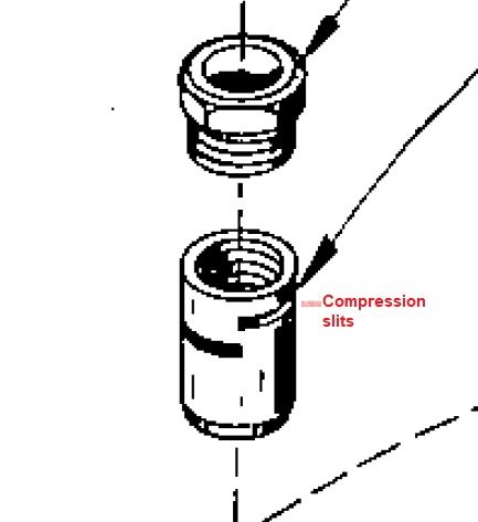

              Still not sure I understand – I know the nut well, so understand how it works, but fail to understand how if the lower half's threads are not stripped that the head would still not move. Was the leadscrew turning while the head remained stationary? If so then the lock-screw in the side of the slide block into the Z nut was not preventing the z-nut from turning. Or would the leadscrew not turn, ie, jammed?
              If the upper half threads are stripped while the lower half are good, then the compression nut on top of the slide block was probably way overtightened – a number of times…
              The design works and works well if not abused, so it should work for you as well!
              I frequent various EMCO ( lathe and Mill) groups ( groups.io, etc) and no-one has complained of the Z nut design being unfit for task..

                The head could move, but just downward, not upward above after a certain point. The threads parted from the nut coiled around the lead screw preventing the nut to move upward over that point.
                The compression of the slot is not entirely controlled by the locking nut but the weight of the head. I have never over tightened that nut and as a matter of fact, it often got lose by itself and I could not figure out why.

                  Was the upper half of the nut, the part above the compression slits, still attached to the lower half, ie, was it only that the threads are stripped from the upper half, or had the upper half parted from the lower half?
                  Are there signs of rubbing tween leadscrew and the crimp nut interior ( item 4 below) at all? If not it should be impossible for item 4 to unscrew, unless the z nut somehow rotates- that could occur if item 22 is not well tightened..
                  Do you recall what the hole in the side of the nut, where item 22 impinges, looks like at the moment? Has it elongated vertically? If so, then all the head weight is on item 4, compressing the z nut slits all the time and wearing the upper thread half prematurely. However, that that should even more prevent item 4 from unscrewing as it is under tension all the time. Or has the hole elongated horizontally? If so, the nut would turn a little each time Z is wound, and that would cause loosening of item 4

                      Original nut is, I believe, a zinc alloy, Mazak/Zamak, etc. 7075 has been mentioned as a nut material. Honest question: is this a wise choice? In the back of my mind, a small voice is saying that the stuff is abrasive, and wears cutting tools quickly. Quite likely mistaken, though.

                          Could the threads have been stripped by over-correcting backlash and perhaps over-tightening the gibs as well in hope improving the machine's accuracy? Tightening the gibs puts extra pressure on the screw and nut, and so does squeezing the anti-backlash slot. If slots are closed up to the point backlash is very low, the nuts wear rapidly, especially if the slides are tight as well.

                                I would say thats likely to be the reason. The gibs as well as the other two bolts for Z axis play control are all on the tight side. When the head is lowered slowly, sometimes it would stop before suddenly fall by around 0.1mm before moving smoothly again. That zinc alloy nut always worries me so I have been exercising great care not to overload it. When I move the head upward, I always push the head upward with my hand at the same time in order to reduce the load on the Z nut.
