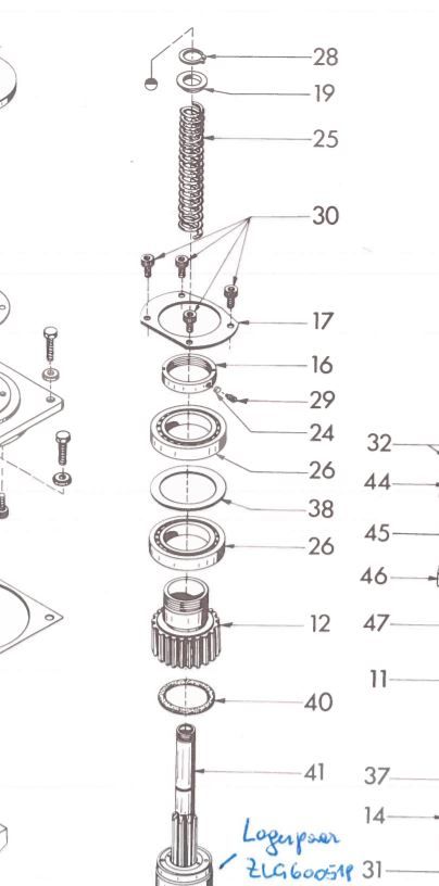

      …. I'd still like to understand what the spring is for, though….
      I think the spring is to keep the quill/spindle retracted into the head when the quill feed handle is let go. The lower end of the spring rests on parts #12 which is kept in place by the housing of the head. The upper end pushes parts #19 , which is attached to the upper end of the spindle upward. There is another coil spring in the quill feed mechanism so may be the question is why two springs are needed.

        Oh, good grief! Of course it does! Thank you. What a monumental blind spot! Clearly, I'm losing it…
        #584577
        Graham Meek
          @grahammeek88282
          The small torsion spring fitted to the Quill feed pinion is to return the Drilling Depth Stop to zero. It has no part in returning the Quill, this is taken care of by Detail 25 above.
