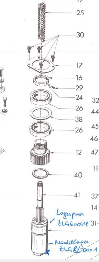

                    Not sure how it can be done ….. anyway, this is the construction of the spindle / quill of hte machine :
                    **LINK**

                          Is the spindle spring pushing the spindle down or up? Up is usual for drilling machines but it should be down for milling.

                              It was probably back in the '80s when I was interested in obtaining a replacement spindle, that I discovered that Emco would not supply the component parts of the quill/spindle assembly separately. That probably explains why the exploded diagram, to which you provided a link, shows the quill/spindle as a complete assembly. The parts diagram I have in front of me is probably an earlier version, which shows the internals of the quill. The thrust bearing arrangement, which controls the spindle's axial position (z-axis) is as I described in my previous post. Unfortunately, it's not shown in your diagram.
                              I'm not sure what the spring (25) does. I think it acts between gear 12 and part 19 ('pressure washer' ), to reduce possible rattling of the gear on the spindle splines. Hopefully Graham Meek will be along to tell us more – he knows vastly more about these machines than I do. I think the gear is helically cut. This means that it will try to move in one direction along the spindle when torque is applied, and in the opposite direction when torque is applied in the opposite direction. Perhaps the gear's axial float is transmitted by the spring to the spindle, but it still doesn't explain why the spindle is free to move axially.
                              I have noticed that, in some gears, the spindle can be turned in one direction more easily than the other. I assume this is because of end-float in one set of helical gears, but I haven't gone hunting for an answer… Having seen your videos, I'll go and check my FB-2, when time allows. Perhaps, like the garage mechanics say, 'Oh, they all do that, Sir.'
                              It's beginning to look like one of the screwed bearing-locating collars is loose, but why you can't move the spindle by applying axial force is a puzzle.

                                I have the official Emco works drawings covering the spindle. Its component parts and the assembly of those parts.
                                The Spindles are graded into three different sizes. As an example Class 1 is 30.023, +0.003, -0.006 mm, the Class 3 spindle is 30.033, + 0.005, – 0.003 mm. Class 2 being in the middle with similar tolerances.
                                Each Spindle is matched to another specially prepared Needle Roller bearing, made by INA NK 30×20 P6/ H32+26. Hence this is why Emco only supplied this as an assembly. When trying recently to get one of these bearings it was impossible. In the end I managed to track down a Japanese bearing with an extra roller and better tolerances. It is possible to get a new spindle but the owner will need to Lap the diameter to suit his bearing.
                                The two Special Ball races, FAG 6005 C3.K3 VSPK 10 kp, are secured in the Quill with Loctite 601, so even if the Ring nut came undone the bearings would, should stay put.
                                The problem I have with the original set-up above was touched on by Andrew.
                                If the two planes of contact are at a slight angle and complimentary to one another. Then when the cutter is rotated the error would be evident and double the displacement, or inclination.
                                Similarly the Ball acting on this inclined plane, although it appears to give only point contact. It is in fact touching off to the one side. If that ball is also running out, or eccentric in the collet. Then the contact point will move around on the top of the ball, and will not be directly under the spindle as it is assumed.
                                Unfortunately straight cut gears transmit the drive to the Quill. The Helical gear is the input drive gear to the gearbox from the motor. Turning the Spindle against rotation does tend to cause this gear to lock-up. As the helical gear is trying to lift the Sliding Gear and its spindle. Any additional force being applied manually to the Spindle to overcome this would affect this set-up.
                                It is also assumed that there is no side play in the measuring device. Which would allow the top to tilt slightly. There has to be a clearance here for the device to register freely. The unit is after all designed only to set the cutter height in a CNC application and is being asked to do something it was not designed to do.
