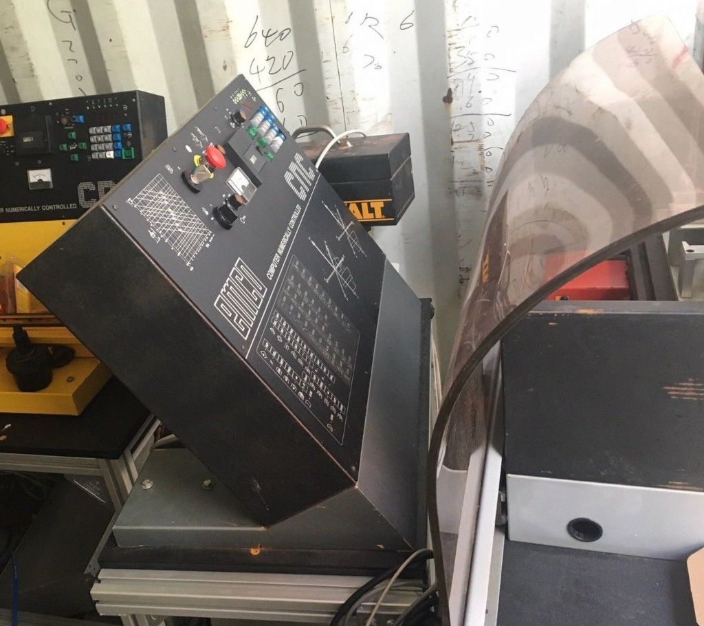

                        dsc00580.jpgEmgee – Here are a couple of photo`s of the unidentified frame from inside the mill cabinet. Fabricated from 5mm ~ Steel. Assumed at first it was some kind of mount for the remote cabinet. But nothing appears at first sight to be compatible in terms of fixings.dsc00579.jpg
                        #393061
                        Rod Ashton
                          @rodashton53132
                          s-l1600.jpgSussed it. Cabinet sits on and is angled backwards. My cabinet has frames attached to the base and so not immediately obvious.

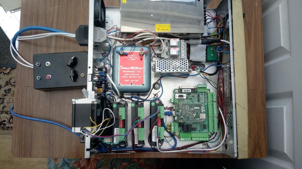

                              Resurrecting an old thread, but it's taken me 18 months to get this far…
                              Thanks to Dr. Dave's helpint theis thread I now have most of the hardware wired in
                              Today was the first live test of the first servo. I've plugged in the blue, red, green and black wires to the drive, set dipswitch No5 and run the Acorn software but nothing is happening. After 10mins the servo gets quite warm so there is power getting to it (!) but no movement.
                              The Acorn software is running with default settings. do I need to reconfigure anything?
                              Is there anyone who can help, please?
                              Bitzer

                                The main addition to Dr. Dave's setup is the 12V control circuit, which gives me a no-volt relay to interrupt the mains using low voltage to a couple of stop buttons around the mill. The black box will sit on top of the mill and has the spindle speed control, manual override and a plug for a remote e-stop.

                                  Hi Bitzer
                                  Have you watched Matryscncgarage on youtube? I found his videos very valuable when I was setting my controller up.

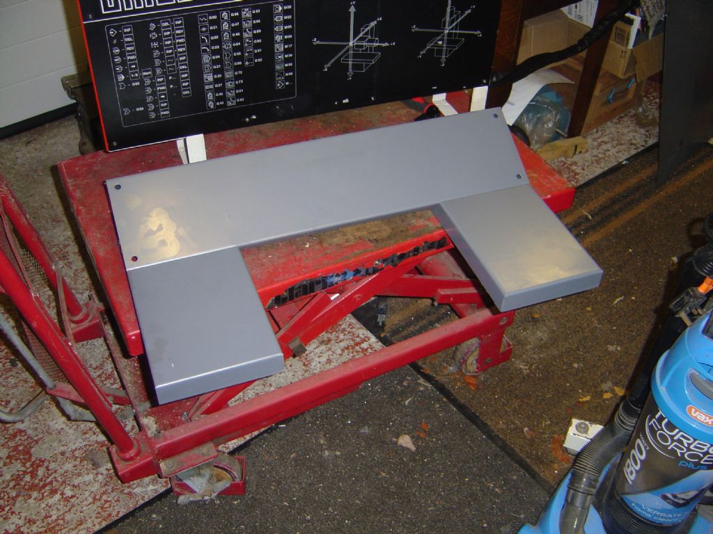

                                    I have done a few mods to the machine since updating the controller. I got fed up with swarf going everywhere, so a bit of bendy MDF came to the rescue. The lighting was also quite poor, so I have added a couple of led lights (they are intended to go under wall units in the kitchen) and now I can actually see what is going on!

                                          Quick update: Managed to set up the Acorn software today using a temporary USB to Ethernet converter to give me a connection to the web while the inbuilt Ethernet was connected to the Acron board (so that idea works!)
                                          The Acorn site is bookmarked as the homepage so I don't nget tempted to wander off to anywhere dodgy.
                                          Still cooking the stepper though. remains locked and not moving and after 10 mins it is too hot to handle. I thought I had followewd DrDave's "words and music" so I'm not sure what I am doing wrong, unless I have the wrong steppers?
                                          Looks like I will have to consult the Acorn forum. Will keep you all posted.

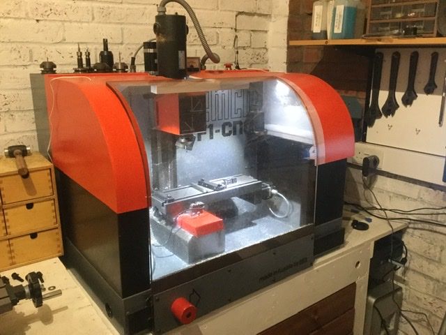

                                            Hi Dr Dave, What is the capacity of the F1 mill? What sized cutters are you normally using and what Sized cuts in what materials?
                                            There is one for sale at the moment and looking at the possibilities for it. It has all the original controller, not sure if the software is still there. I know nothing about the Emco F1 mills.
                                            Thanks, Neil Lickfold

                                              To be honest, I haven’t used my F1 for a while, so I am working from memory. I normally use 6 mm or 10 mm cutters, occasionally a 25 mm insert slot drill. I don’t feel the need for larger: just get your CAM software to program a suitable path (I use Fusion 360).
                                              Feeds and DoC? In the higher strength aluminiums, I would think that full-width on a 6 mm HSS cutter, I would be conservative and have a depth of 0.5 – 1 mm. The machine has an ammeter for the motor current. I find that very useful to tell me how hard it is working. And when the cutter is getting blunt!
                                              I have milled steel (up to En8, nothing fancy), but I forget the details. It seemed to take forever, so I might have been pussy-footing. 0.25 mm DoC, perhaps and trying not to use the full cutter width.

                                                Hi Neil
                                                You can see my F1 making chips at this link **LINK**
                                                There are several videos there showing the same machine doing other tasks, the MB backplate is 1 you may know.
                                                The machine is well built using mainly cast iron for the main components, there are chip shields on the sides with a sliding door to close off the front of the machine, tapered gibs are adjustable on all axis.
                                                The work envelope is XYZ 200x100x200, not large but fits most of the sort of milling jobs I do, spindle motor is 400W PMDC with manual speed control 50-2000rpm on the spindle.
                                                Quick change tooling is SKF30, BT30 holders with pull stud are an alternative.
                                                Full machine spec is available FOC in the F1 Manual available at https://emcof1cncmill.groups.io/g/main
                                                I am still using the original controller so writing G&M coded programs, to me it's all part of the fun, I use an editor called MFI which is designed around the early Emco cnc lathes and milling machine.
                                                Programs can be uploaded to the machine by computer using an RS232 link.
                                                For simple jobs with only a few lines these are entered direct into the controller using the on-board keypad.
