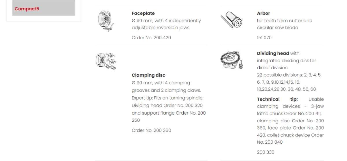

        Hi Nigel B @mgnbuk & Thor @Thor,
        I just did a check out of curiosity & it’s listed there.
        https://www.emco.or.at/index.php/zubehoer/compact-5
        C5_Dividing_Head
        HTH, Colin

            Hi Colin,
            The link you gave does show the indexer, but it can’t be expanded to give more details about it or ordered. It seems to be more of a listing of the accessory options that were originally available, not what is currently on sale. Putting the indexer part number 200 330 into the search function of the “Emco Online-Shop” link doesn’t bring the indexer up.

                Hi Colin,
                The page shown is taken from the sales leaflet. If you go to “On-line Shop” at the top of the link this will redirect you to the home page. Select “Spares and Accessories” followed by Machine from the drop down list.
                Not all pictures are shown for each item, but if you open a particular item and then go “details” this usually gives the part number.

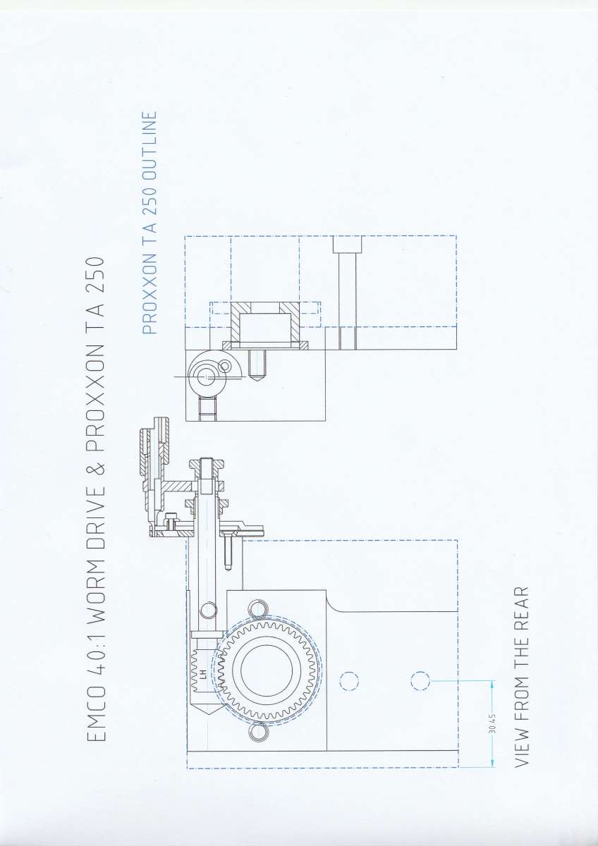

                    I did mention earlier that I thought it would be possible to adapt the Emco 40:1 Dividing attachment design to fit the Proxxon TA 250 Indexing attachment.
                    After a few emails with Colin and his kindness in supplying me with the measurements I needed. It was possible to see if it would be feasible. I can say that the Emco unit will fit this Indexer with only minor modifications to my original design.
                    A longer Worm shaft and Eccentric bush are the only two items needing major alteration. While the repositioning of the M6 mounting holes will simplify things, (see below).To marry the two units together does require an 8mm thick Adaptor plate and a Coupling piece to replace the Proxxon Index wheel.
                    The Emco attachment can be made to fit in two different positions and will thereby still give the original varied Proxxon mounting positions in the Horizontal Plane.
                    EMCO PROXXON
                    The above drawing shows quite clearly the extended shaft and bush.

                                I also have the “now obsoleted” Proxxon TA 250 Dividing Attachment which Graham has already mentioned & has now designed his Emco 40:1 Worm Drive to suit.
