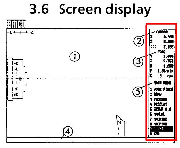

                              Can anyone decipher the wording/ numbers in red outline for me, its from an Emco compact 5 CD page 52.emco compact
                              #598344
                              Emgee
                                @emgee
                                Stan
                                Looks like they are the DOS programming shortcut codes, the original Emco 2.8 program was DOS based.
                                The dimensions and other info in the TOOL column are Tool offsets and spindle speed for the tool..
                                The arrow indications show the direction of tool travel by using – (minus sign) and +
                                so – on the X axis puts a cut on, – on the Z axis moves the tool towards the chuck.
                                Hope this helps.

                                stan smythe
                                  @stansmythe78809
                                  Emgee, Its a friend who has that version but his manual on that section is blurred so just trying to get the exact nos & wordsas outlined in red.. I just have a basic Unimat db 200 thats complicated enough for me smiley

                                  #598352
                                    I think:
                                    CURSOR
                                    X coord
                                    Z coord
                                    ::: number (don't know)
                                    TOOL
                                    X coord
                                    Z coord
                                    ? number (don't know)
                                    f number/min (feed rate)
                                    S number RPM (spindle speed)
                                    1 WORK PIECE
                                    2 DRAW
                                    3 PROGRAM
                                    4 DISPLAY
                                    5 SETUP number,number
                                    6 MANUAL
                                    7 MACHINE
                                    8 ARCHIVE
                                    9 ????
                                    0 END
                                    #598358
                                    stan smythe
                                      @stansmythe78809
                                      Thanks Dave, I think No.9 is PRINT.
                                      Hopefully someone may have a manual and can check the numbers for me

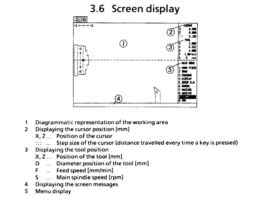

                                            From the Manual
                                            Emgee
                                            Edited By Emgee on 16/05/2022 00:30:53

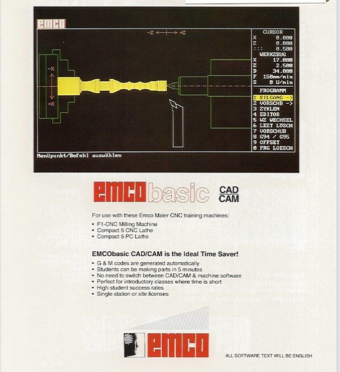

                                              Edited By Emgee on 16/05/2022 00:45:19

                                                #598396
                                                Keith Petley
                                                  @keithpetley53472
                                                  Stan,
                                                  This would appear to be the manual, page 52 has the same image of the screen display
                                                  https://www.clockmaker.it/files_forum/monografie/emco/emco_5/emco_compact_5.pdf
