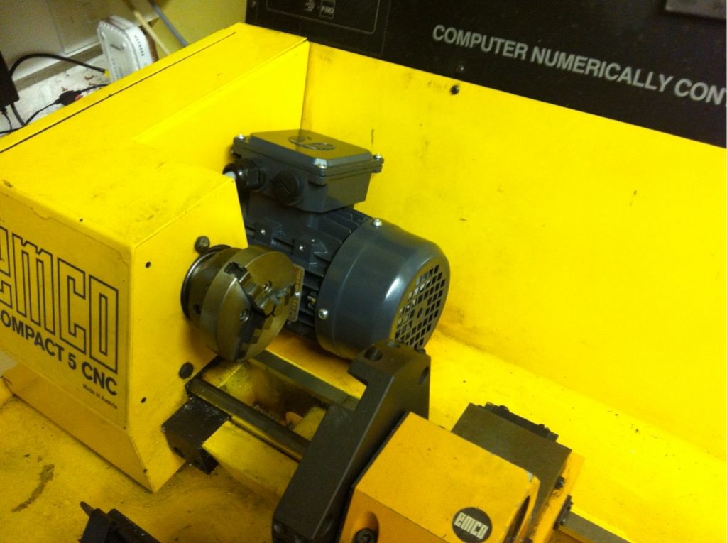

                                  I am a happy boy again. Having given up on getting the DC motor to work, I spoke to Pete from Power Capacitors at the Ally Pally show (no connection, just a satisfied customer) and ordered a 3-phase motor & VFD. Bits arrived PDQ, but the motor came as a foot mount. The EMCO requires a face mount and Pete sent a replacement front cover out the next day. It was easy enough to change, but still no luck! The mounting holes would not line up…
                                  I removed the cover again and, fortunately, four extra bosses are cast in at 45 degrees from the standard holes. They even have a dimple to guide a drill. Tap M5, put everything back together and it fits! VFD wired in and we have motion again.

                                    Good news you have it running, what output power is the new motor ?
                                    Emgee
                                    #223817
                                    DrDave
                                      @drdave
                                      Hi Emgee
                                      The new motor is 0.37kW (½ HP), compared with 0.44kW for the original. The big change is the motor speed, down from 4,000 rpm to 2,800 rpm (3,360 if overdriven to 60Hz). A small price to pay to get a working machine.
                                      Thinks: I will need to make/fit a motor guard before I do any serious machining. That cooling fan looks vulnerable…

                                          Frame size is 63 and the mounting is a B14 face mount. I found that I needed to drill an extra set of mounting holes in the face mount (at 45° to the existing ones) in order to get the motor to fit. Fortunately the motor that I received (TEC) had bosses cast into the mount so this was a simple task.
