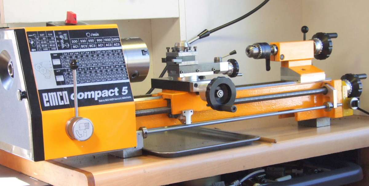

                  #744153
                  Graham Meek
                    @grahammeek88282
                    Twenty years of wear on the knurling of the Feed screw Handwheels on the C5 had reached the stage where I could not grip them very well any more. While new handwheels are still available from Austria. I decided to make some new ones similar to the ones I made for the Unimat 3 that I have. An example of this type can be seen on the C5 Topslide.
                    New Handwheels
                    I also took the opportunity to alter the cone angle of the handle to give better access when adjusting the dials. The revolving handles were also changed. The new ones are parallel and made of steel. The tapered plastic Emco ones were also showing a lot of wear. The handles revolve on a commercial 6.5 mm diameter x 25 long Shoulder screw. This has an M5 thread and screws directly into the Delrin handwheel. A custom steel washer abuts the shoulder screw and increases the contact face with the Delrin. This washer also stops the handle from wearing into the Delrin over the years to come.
                    This mod was done some weeks ago, but today was the first chance I have had to get a photograph.
                    Regards
                    Gray,

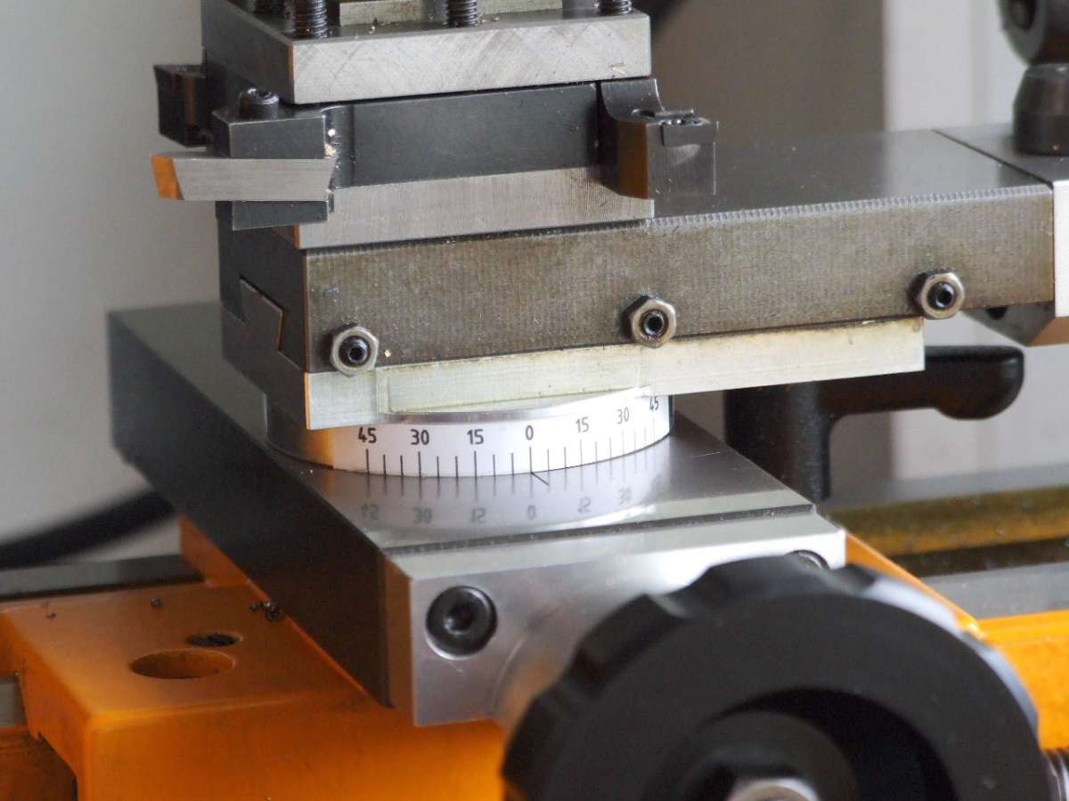

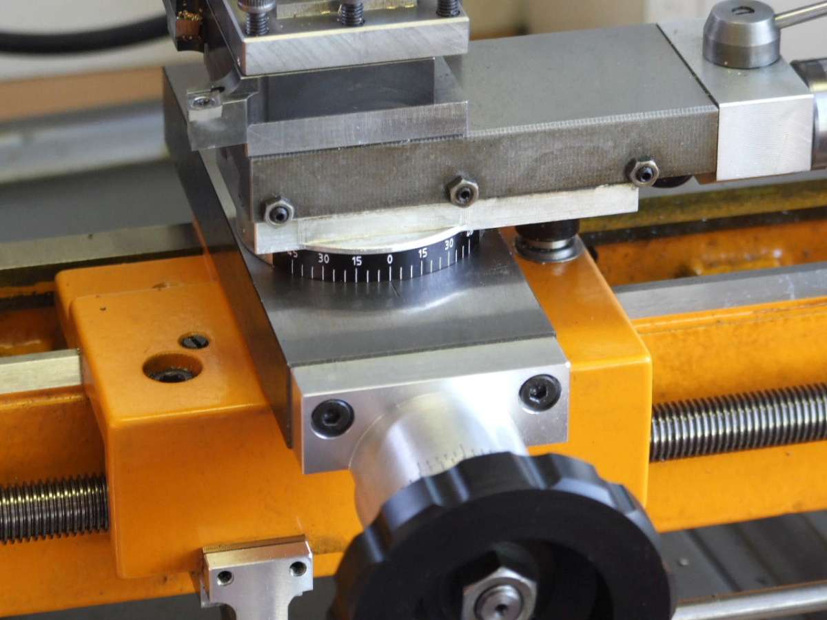

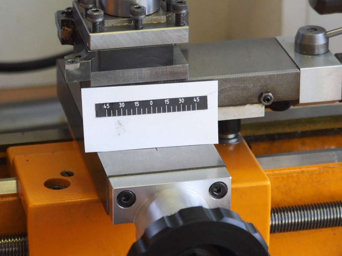

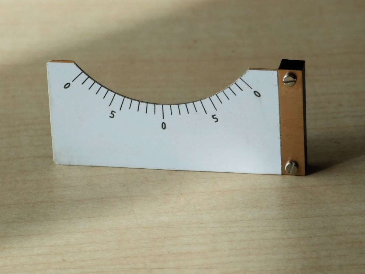

                    #747010
                    Graham Meek
                      @grahammeek88282

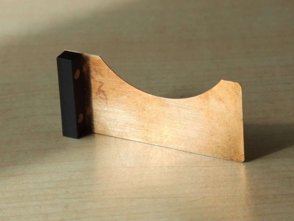

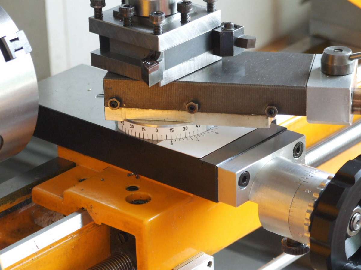

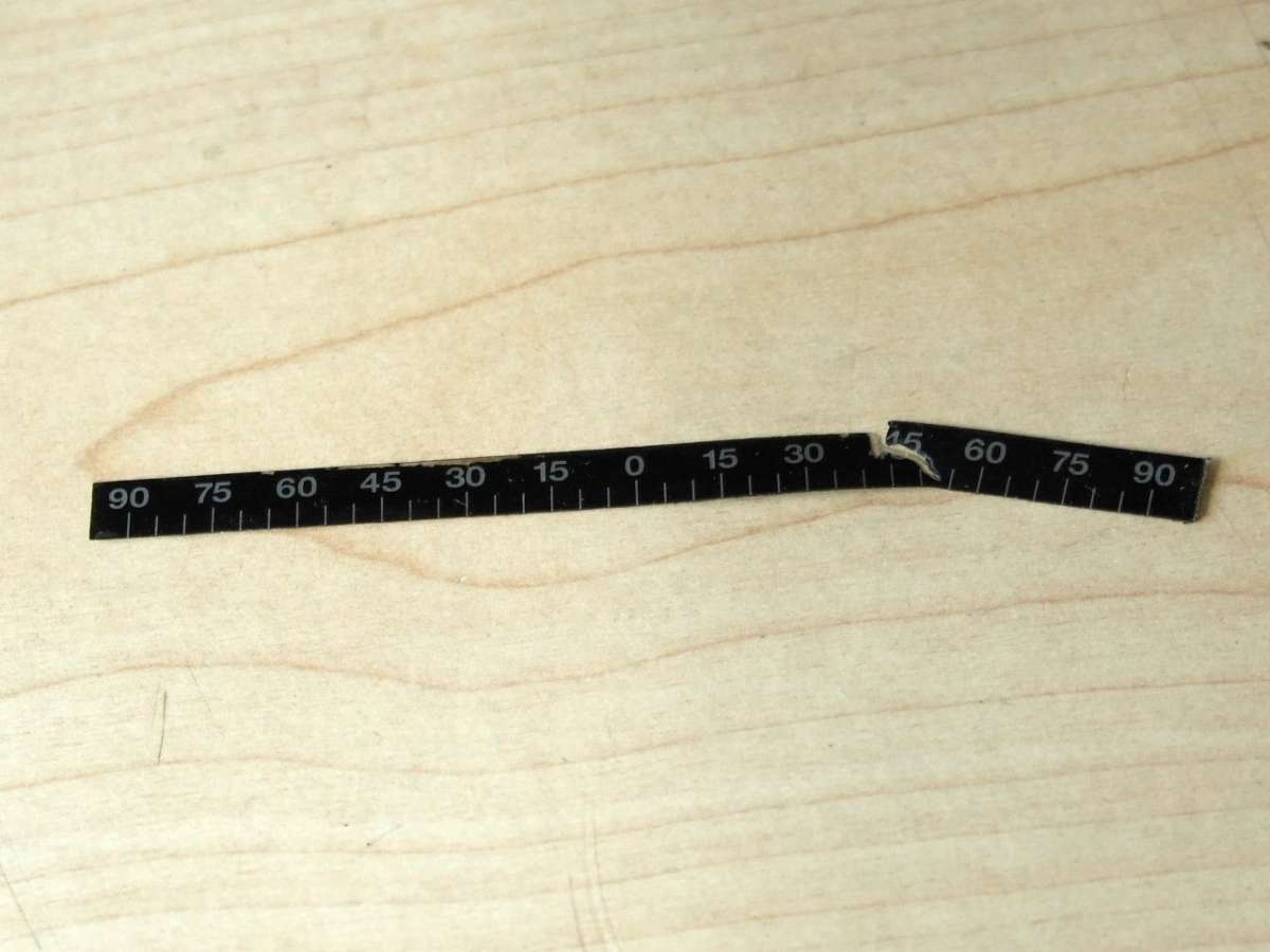

                      This modification was not part of my original plan. Whilst watching the swarf coming off a rather long workpiece. I had failed to notice the free end which was snaking around the top-slide base. Before I had a chance to react the coil of swarf had deftly removed the C5 Top-slide degree scale.
                      Emco 90-0-90 Broken Degree Scale.
                      This scale had been an annoyance in that is was impossible, at least for me, to see graduations on the scale past 45 degrees either side of Zero due to the overhang of the top-slide.
                      My initial reaction was to make another scale but an engraved one in Brass. This was going to be a lot of work, so an alternative was needed. I did wonder if it was possible to get inkjet printable sticky Vinyl sheets. This was later confirmed following a google search.
                      Thus I decided to draw up some new scales using Qcad. From the outset it was deemed pointless doing 90-0-90, instead 45-0-45 seemed a better option.
                      New 45-0-45 Scale
                      To make up for the missing 45 degrees a separate scale on the cross-slide was needed.
                      Cross Slide 45-0-45 Scale with Vernier
                      This was made such that it could removed when not needed. The time also seemed ripe to add some Vernier scales to this new scale. The outer “0” either side of the main “0”, or Zero degrees, represents the 45 degrees either side of Zero. The “5” graduations represent 1 degree of movement when used in conjunction with the top-slide scale. This is a vast improvement over the original Emco scale which was 5 degrees per division.
                      Underside view of Cross Slide scale
                      The cross-slide scale is supported on a piece of 0.2 thick Phos Bronze sheet. The two magnets ensure the registration of the scale and that it stays put when adjusting the topslide.
                      Set at 60 degrees
                      This last picture shows the topslide set to 60 degrees. Previously this would require using an adjustable set-square off the face of the Chuck. This was always fiddly and time consuming. This time it took only as long as undoing the retaining capscrew. Turning the top-slide to 15 degrees, (Ref 45+15=60), and retightening the capscrew.
                      The permanence of the inkjet is good, it is not affected by Oil or Isopropyl. As regards the adhesive strength, then only time will tell on that score. I have a plan “B” in that I can give the scale a coating of clear lacquer to seal the joint if it does prove to be a problem.
                      One thing I have noticed from the photograph is that the scale on the top-slide base is on the skew. This will be attended to tomorrow.
                      My only regret is I could not replicate the White on Black scale of the original.
                      Regards
                      Gray,

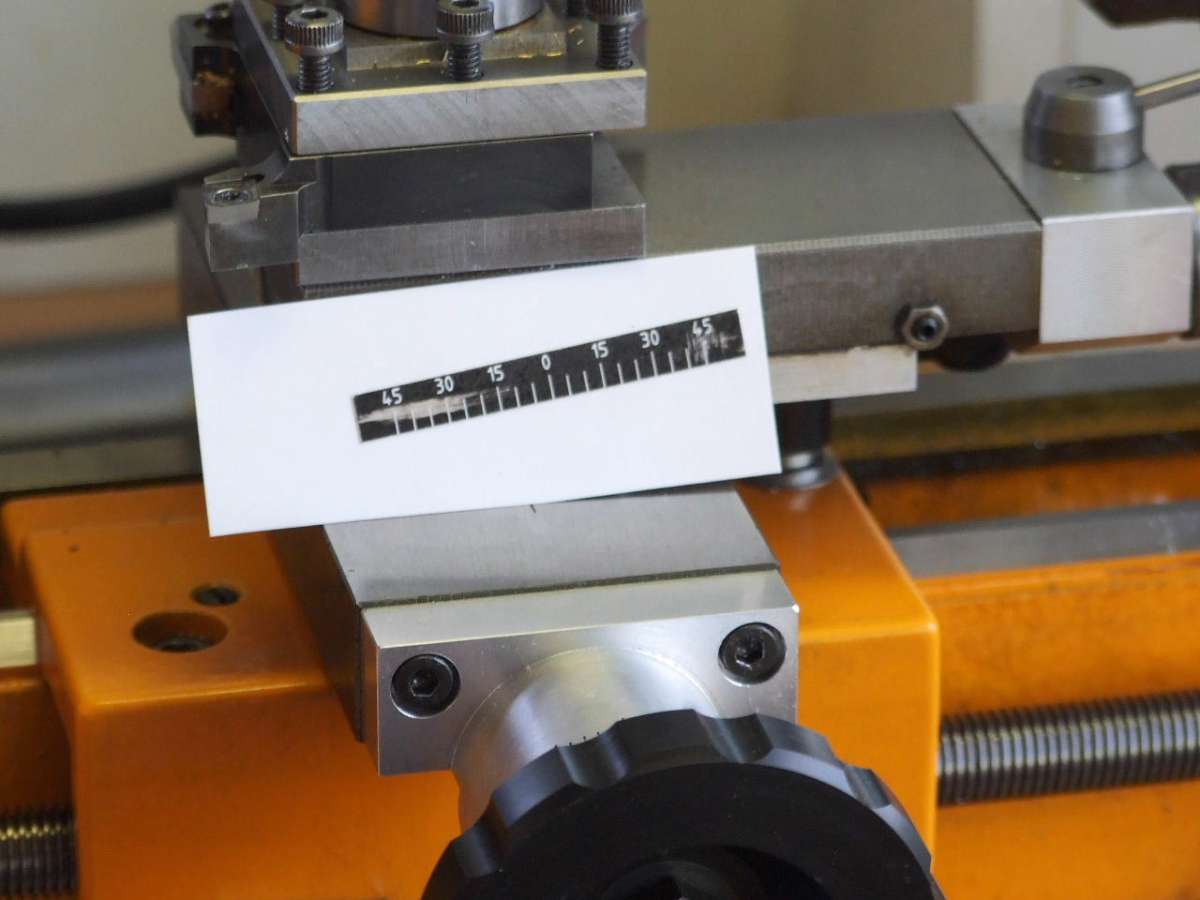

                                        #749003
                                        Graham Meek
                                          @grahammeek88282
                                          Thanks to Jamie I now have a White on Black Scale. The path to this scale was not so easy as my Qcad produces the PDF at 93% of the original Artwork, but with a bit of skull duggery I finally got there.
                                          White on Black
                                          The photograph above shows Gloss Vinyl with and over spray of Clear Lacquer.
                                          Gloss not durable enough
                                          Above shows that the Gloss Vinyl is not durable enough without the clear lacquer coat. The long mark was the artists paint brush that I was using to smooth the scale. The other marks are from the tweezers used to hold the scale.
                                          Matt is not so Black
                                          The Matt Vinyl is shown above. While this is more durable, the Black is more of a very dark Grey. The photograph does not do justice to the difference. I did think the Matt Vinyl would be better for accepting the clear lacquer, but the finish was not as good as the lacquer on glossy vinyl.
                                          Regards

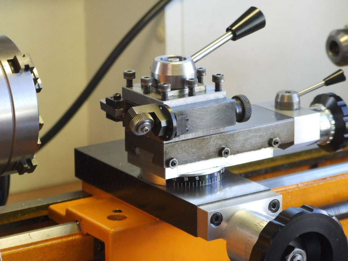

                                          #757242
                                          Graham Meek
                                            @grahammeek88282

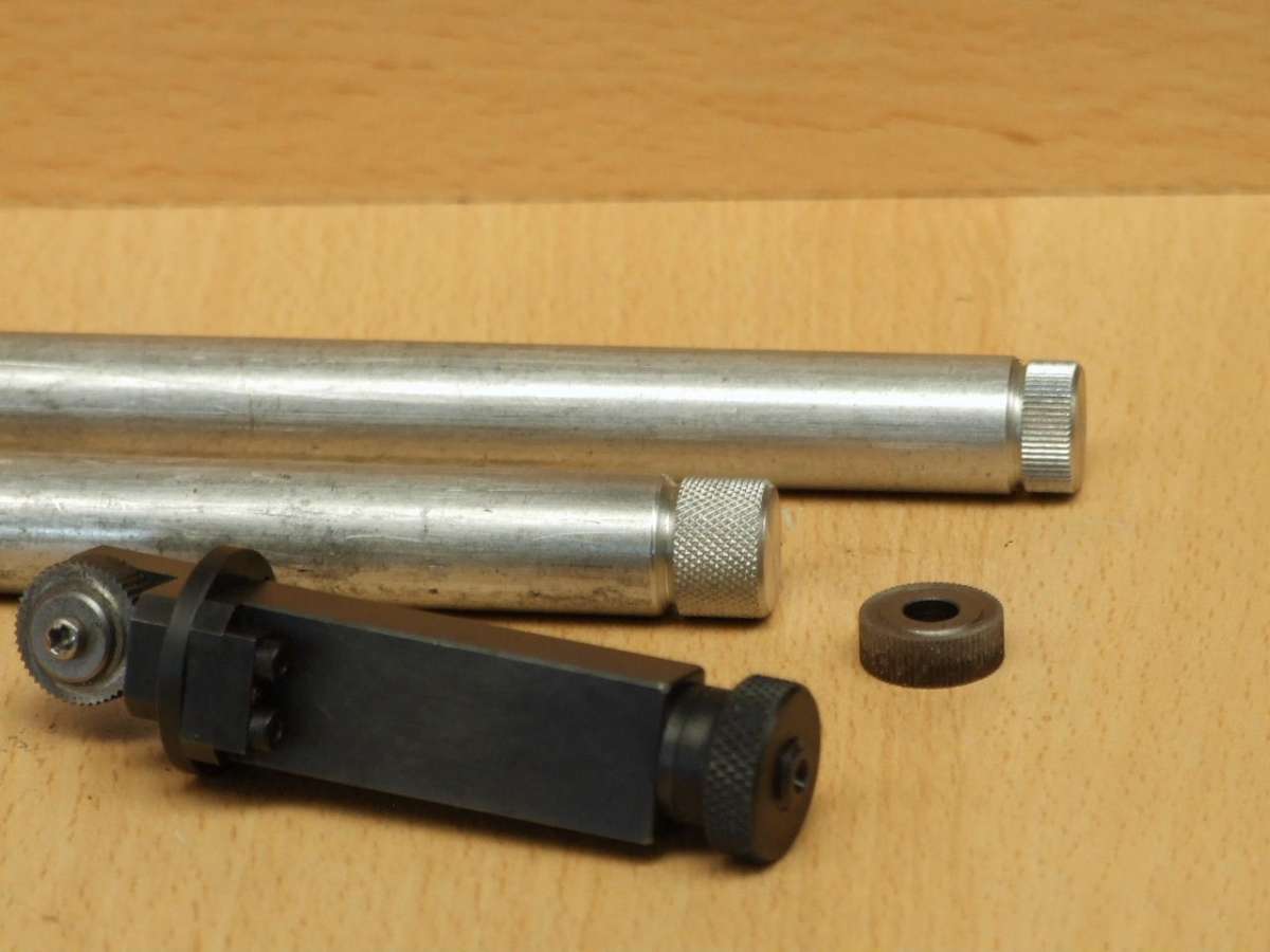

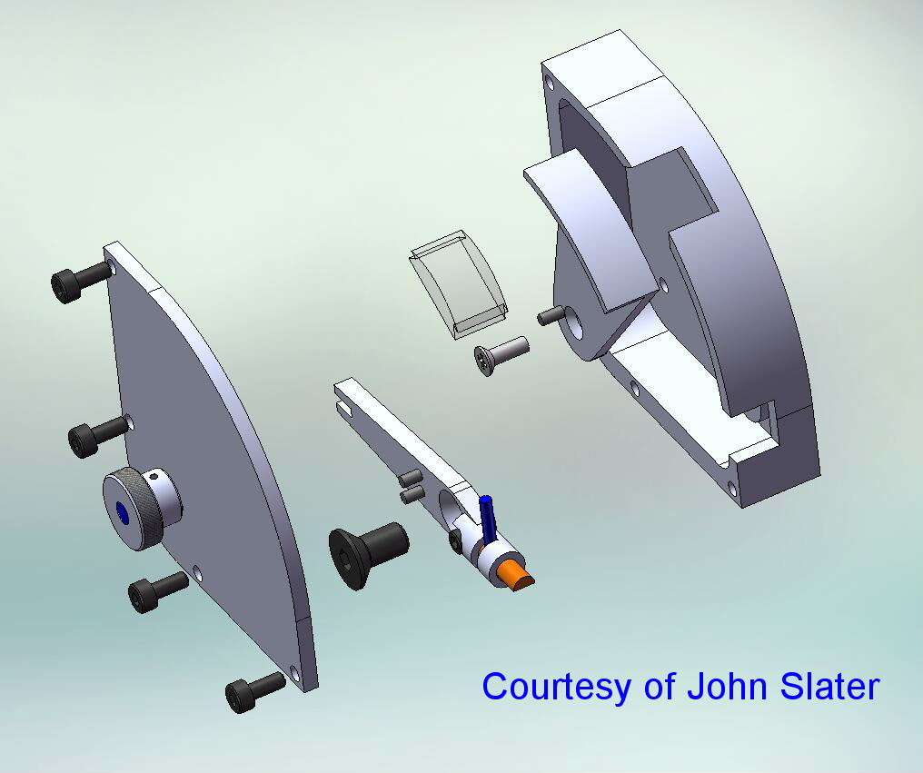

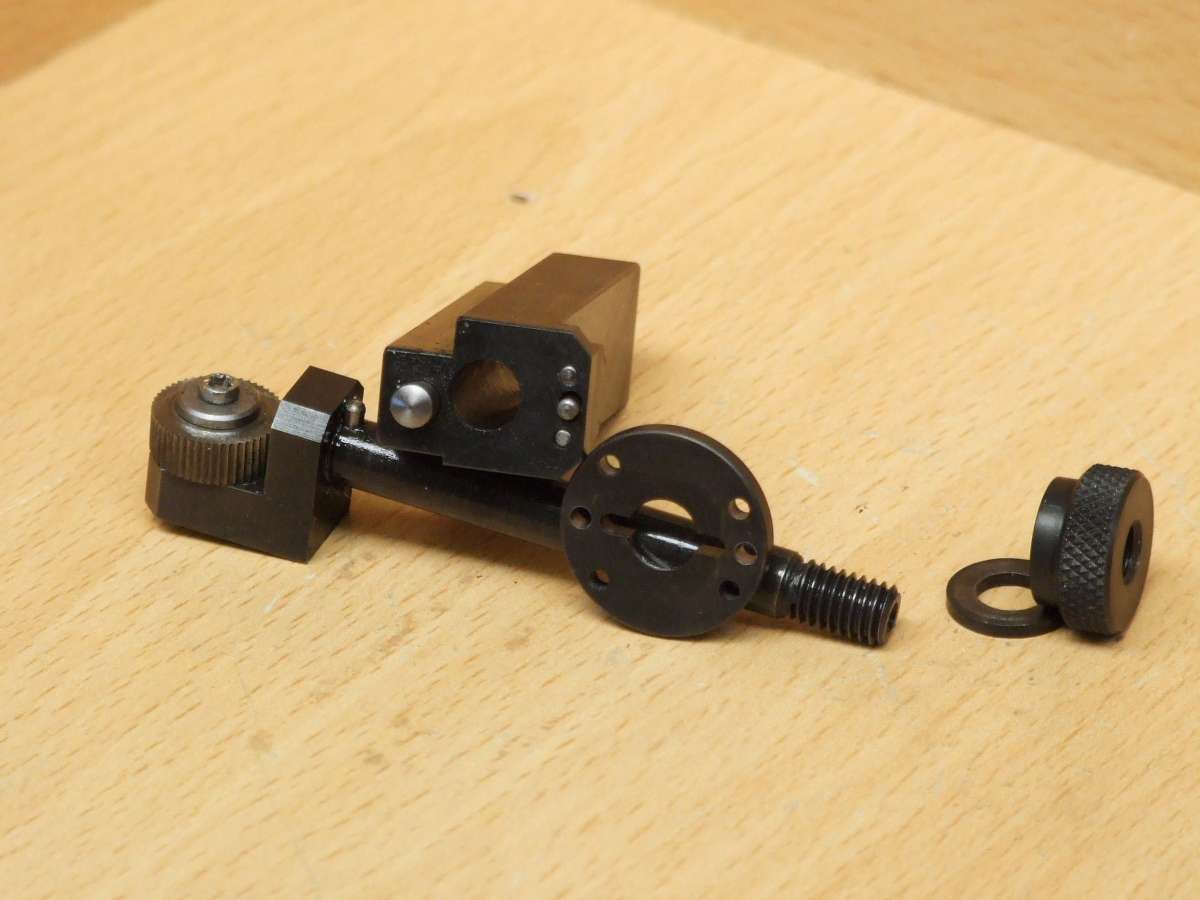

                                            Whilst this is not really a modification to the Compact 5 it is none the less a very useful addition.
                                            I was recently saying to John (Slater), that I was about to start making a scaled down twin wheel Knurling tool. Similar to the one I had designed for my Maximat many years ago. By way of giving me a Rabbit Hole to disappear down, John sent me some photographs of his Cut Knurling Tool. Once I was in the Warren he sent me further information and a design by Jacques Maurel got my attention.
                                            Diamond Position 1
                                            And,
                                            Diamond Position 2
                                            The upshot of this is a tool designed for the Compact 5 which produces some excellent knurls without even trying.
                                            The Parts of the Knurling tool
                                            The parts of the knurling tool are shown above. A sample of the knurling produced can be seen on the Knob which holds everything together in the assembly. The Index plate gives square knurls as well as the regular diamond knurl. To keep things together when changing from position 1 to position 2 I have included a spring loaded plunger. This pushes the plate and the knurling head away from the adjustable Indexing pin. (Held by the small block and the two Cap screws.)
                                            Releasing the Knob further allows the plate to slide off the Snug in the Wheel head and to be rotated to allow square knurls to be produced.
                                            I will post some further samples of the work produced as well as the trails and tribulations on my attempt to do straight knurling with this tool using helical knurls.
                                            I will just finish for now with a thanks to John for the Rabbit hole, and to Jacques for an elegant design.
                                            Regards
                                            Gray,
                                            #757278

                                                #757354
                                                Graham Meek
                                                  @grahammeek88282
                                                  Thanks Colin and Pete for the kind comments.
                                                  One of the Rabbit Warren holes was the article from HSM, so I already have that.

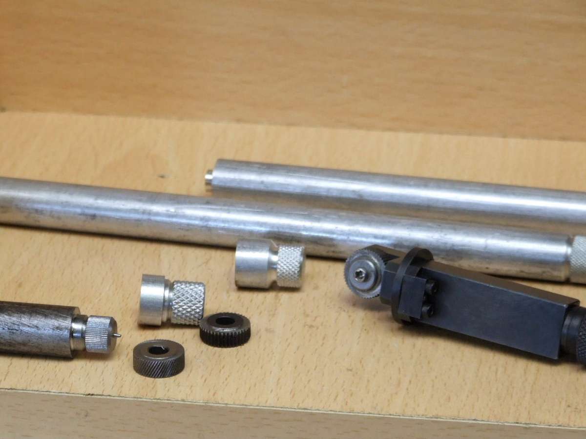

                                                  I first saw Cut knurling being done at the Machine Tool Exhibition in Birmingham in the 80’s. While I would have liked such a tool the cost of the tool was greater than a new GripTru Chuck for the Myford. Plus the shank size was too big for the S7. Even clamping it to the topslide.
                                                  I forgot to mention yesterday that the knurling wheel is canted over at 3 degrees so that the corner of the knurling wheel is presented to the work. The face of the knurling wheel has been dished by 3 degrees. This is to ensure a sharp corner on the knurling wheel and to give a neutral cutting angle. If it had been left unground then there would have been a negative rake angle presented to the work.
                                                  Here are a few examples of what I have done so far, the main objective was to produce the diamond knurl for the Knurling Tool.
                                                  Knurling Samples
                                                  The above shows some close ups of the knurls produced, please ignore the straight knurl I am not impressed with this.
                                                  Further Samples
                                                  The Straight knurl on the aluminium bar was produced using the straight knurling wheel vertical. This still cut the knurl, rather than forming it, but I found it needed several passes to achieve the full depth.
                                                  Preferred Straight knurl Position
                                                  This type of knurling is a lot kinder to the C5. I know because I have already done straight knurling for my Dividing attachment using a conventional forming process.
                                                  I think the Straight knurl in steel above is due to my approach, having received advice from John this morning. The other straight knurls that I have done using helical knurling wheels canted over in brass and aluminium, which I have yet to photograph. These are not very good and I am convinced this is because of the size of the wheels I am using and the coarseness of those wheels. The knurl faces or slopes appear to be undercut, or concave. This I feel is a product of the geometry and the size of the wheel, (1/2″ diameter). Some Macro photos I hope will shed light on this.
                                                  Regards
                                                  Gray,
