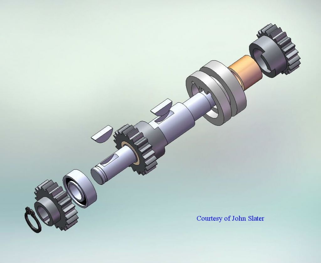

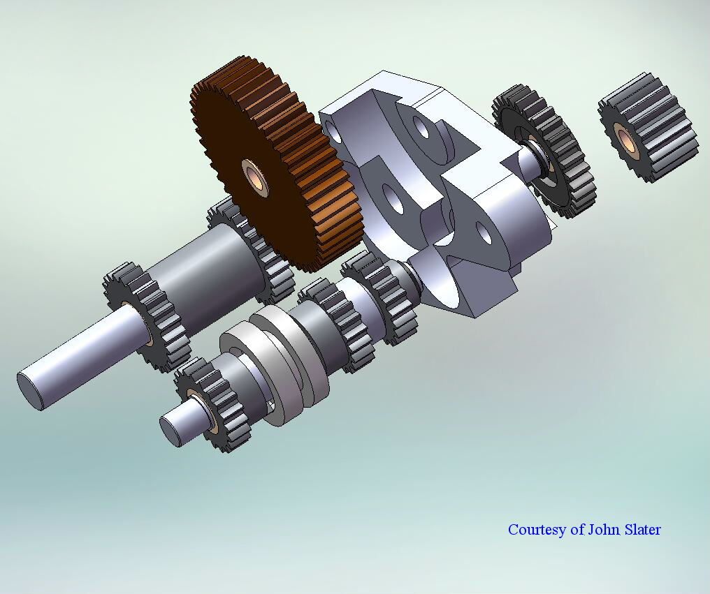

                One thing I did forget to mention is that the gears were made using the Emco Compact 5 Dividing attachment and are all 1 MOD.
                Regards
                Gray,
