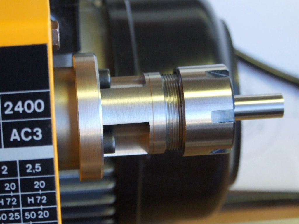

              Emgee
                @emgee
                Geoff
                You can buy an Emco bolt direct to spindle ER25 collet chuck for the same cost or cheaper as messing with a new backplate to fit on the Emco 5 spindle and a Backplate mounting ER type collet chuck.
                Collets are going to cost extra whichever way you go but remember some very low cost collets have excess TIR.

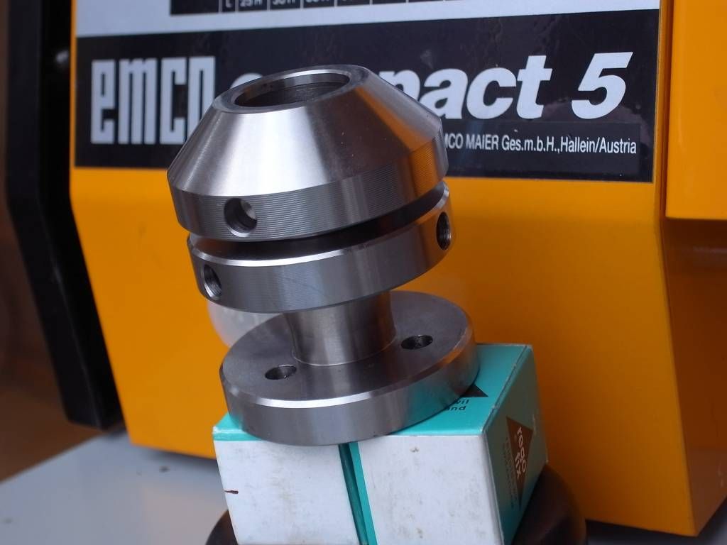

                  Having owned and used the Emco collet holder for the Compact 5. I was not happy with the amount of overhang that the factory original had. Nor was I taken by the wasting needed to get the bolts into place.
                  I therefore set about designing something which has less overhang, is more rigid due to the cut-outs for the capscrews and uses a smaller collet closing nut. The result is one more compact unit which uses the same ESX 25 collets.

                    Gray
                    Looks to me your collet chuck has more overhang to the collet face than the Emco part, but yes the hex sets are fiddly to get in/out.

                      Graham Meek
                        @grahammeek88282
                        Hi Emgee,
                        The original Emco collet attachment that I had, gave me the dimension that I had to beat as regards overhang. From memory my attachment is something like 8mm shorter. This may not seem a lot but it does make a difference.

                          Gray. Another ingenious and beautifully executed production! Please put me (us?) out of my (our) misery. How are the relief pockets for the cap head screws machined? I can think of one solution, without making the flange as a separate item, but I'd expect yours to be better…

                              Graham Meek
                                @grahammeek88282
                                Posted by Kiwi Bloke on 22/07/2021 02:25:18:
                                The pockets were milled using a Boring Head and a tool similar to a parting tool, slow and steady wins the day. A large Tee-slot cutter could be used but this depends on the milling facilities and it is not for the faint hearted.

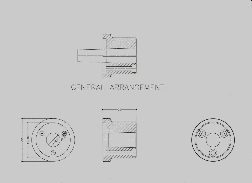

                                      Graham Meek
                                        @grahammeek88282
                                        Posted by Emgee on 22/07/2021 13:45:18:
                                        Posted by Geoff Stenner on 22/07/2021 07:35:09:
                                        Direktspannzangen, 7-teilig With MK2 New Collet Set | eBay
                                        Any comments on these?
                                        Geoff
                                        All of the Emco 5 cnc lathes I have or had needed the small end of the MT2 arbor reducing in diameter to fully enter the spindle, seems they were built to accept a shorter length taper.
                                        Emgee
                                        Hi Emgee,
                                        It is funny you should say that, as I spent ages getting a set of No 2 Morse Collets that did not disappear into the spindle. Those I have of Eastern origin, which I use on my 2/3 rds Quorn, all go in too far. While a set I bought made in the USA, and are years old, do not.
                                        I must therefore urge Geoff on the side of caution if going down this route. The problem could be overcome by using a sub-plate screwed to the spindle nose and bored through No 2 Morse. This would ensure maximum concentricity and it would not need to be the entire length of the Morse taper. Just sufficiently long enough for the working portion of the collet.
                                        This approach could be extended to suit other collets, provided the collet draw tube will enter the Compact 5 Spindle.
                                        Regards
                                        Gray,
                                        #555220
                                        Graham Meek
                                          @grahammeek88282
                                          This is the sort of thing I had in mind, which would allow any No 2 Morse collets to be used.

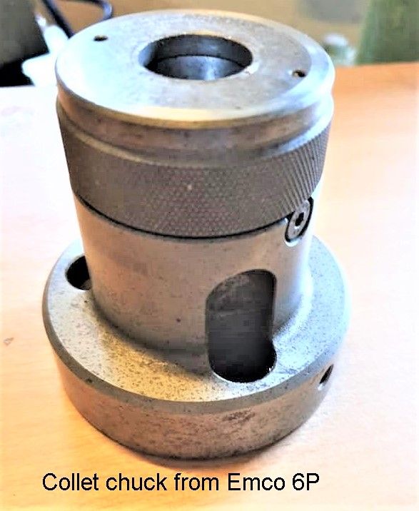

                                              Just found this Collet chuck on an Emco page, can't figure out how the screwhead recess was machined into the pocket unless the tool was located in the circular recess and then fitted to the spindle, any ideas ?
                                              Emgee
