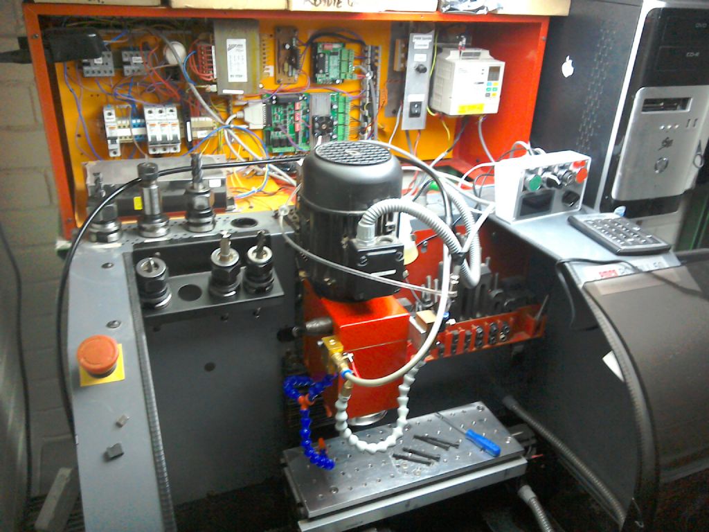

                    After altering the covers on the Cross Slide I now have 124mm Y travel , and shortening the switch actuating rod on the RH side I have 205 X travel.
                    So a useful work area of 204×123 [allowing 0.5 mm at each limit switch before hitting the end stops!].
                    I have fitted a tapped plate to the table that allows greater flexibility for fixing items down.

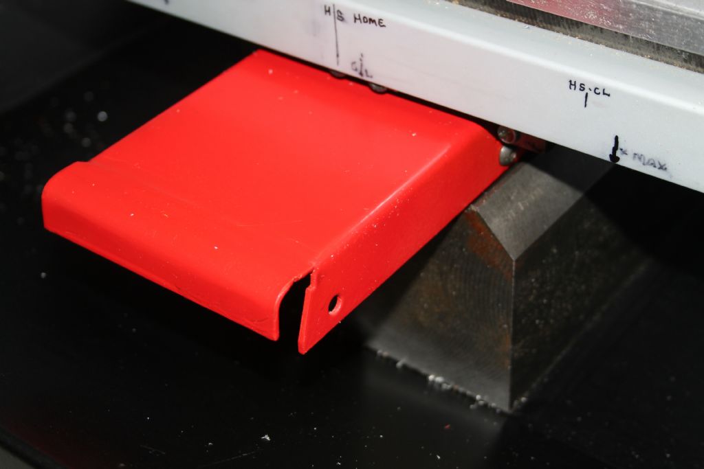

                          This is where the greatest improvement was made. By removing the front Guard and rebending the front of it I gained around 24 mm of movement on the table [when moving to wards the rear column], I also changed the lower cap head screw that secures the cover over the Z ballscrew on the rear column for a low profile dome head, another couple of mm for little effort.
                          The rear cover [accessed from behind the mill] includes the limit switch actuator for the forward movement [Home position] of the table, this was gently re-bent to allow more movement
                          Emco PC Mill 50 guard

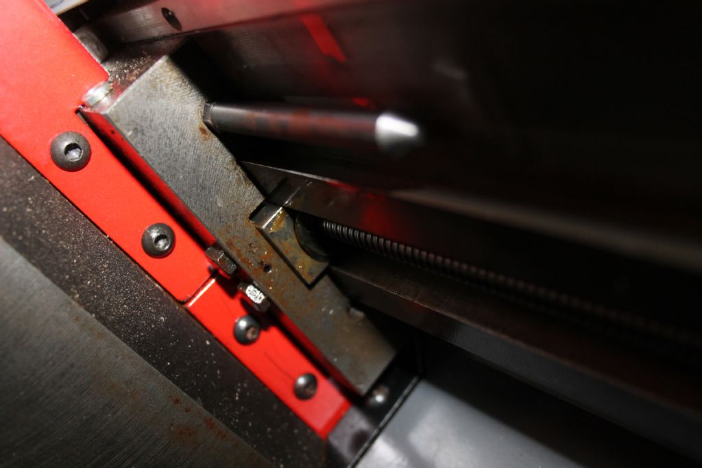

                          There was slight gain on this axis when moving to the left, by shortening the microswitch actuator rod ,~ 8mm removed. [this operates the limit switch under the right hand cover over the stepper motor]. This allowed the stepper motor assembly to come up to the ball nut housing, I set the switch for about 1mm gap here.
                          iEmco PC Mill 50 actuator

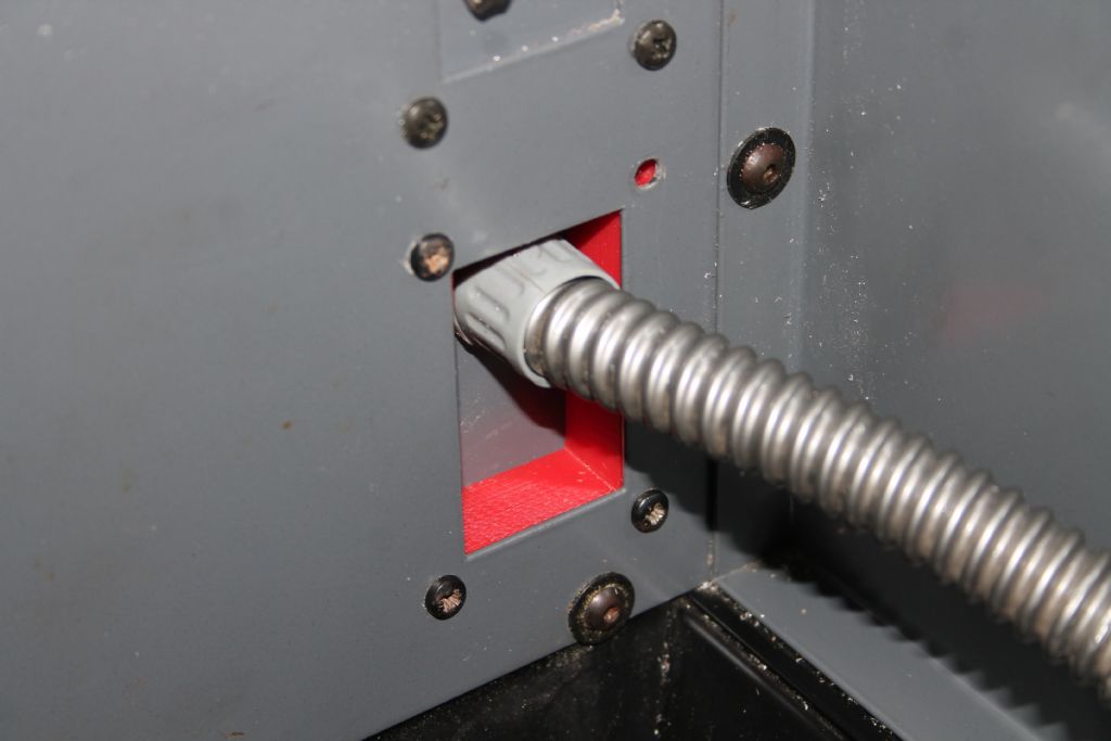

                          The other item to be modified was the cable gland fixing for the stepper motor cables. The gland plate was moved back ~ 18mm with a spacer plate. before I did this when the table moved to the maximum right and back the stepper motor cover would jam against the gland.

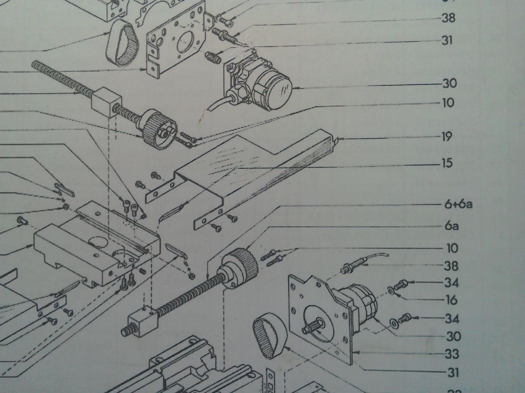

                            Here is a shot of the parts from the Emco manual, part 19 is the rear cover that operates the Y axis limit/home switch.
