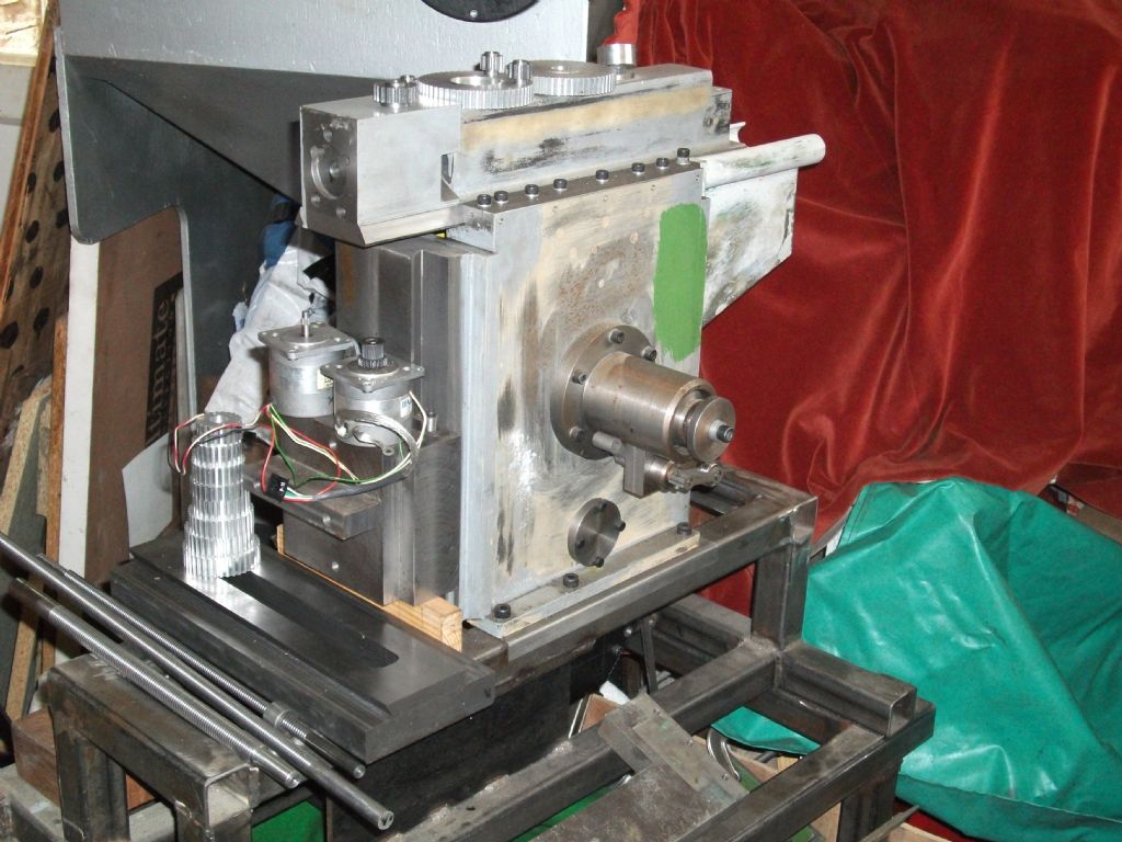

                              #321062
                              John P
                                @johnp77052
                                Posted by
                                Davey J 11/10/2017 07:53:04
                                Might be worth checking the "Gingery shaper". The majority of which could be easily
                                constructed from sheet materials instead of castings That's where I am looking at the
                                moment. Book still available from various suppliers.
                                I would agree with this ,the Gingery book would be a good starting place for
                                any would be constructors of a home built shaper.
                                My own version of this follows a similar construction to the Gingery machine
                                but uses steel plate and cast iron block.Seen here all of this was made in 2013
                                and has sat in the corner of the shop ever since,runs at the moment on an old
                                washing machine motor .Designed from the start to be part cnc and manual
                                machine is an easier job then retro fitting an existing machine.
                                I may even finish it at some time.
