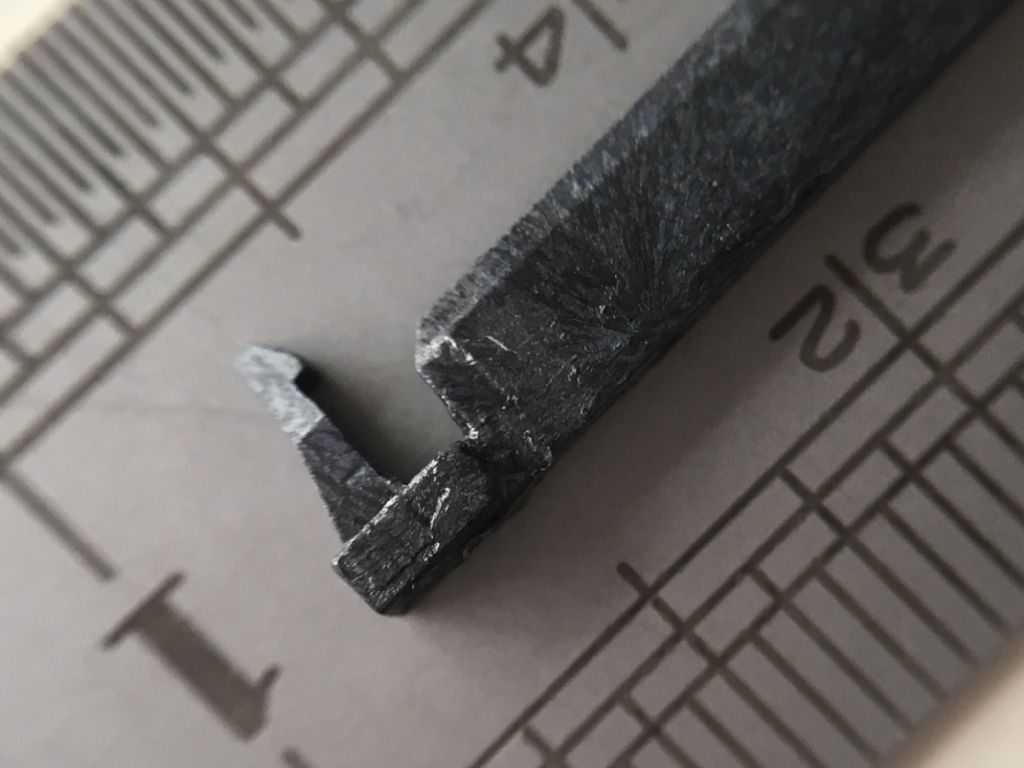

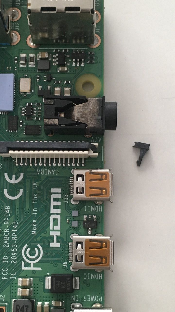

                                  Edit: __ for info. I clumsily broke one end off the flat-cable retention insert on a Raspberry Pi
                                  It takes no load [the clip is just there to stop it getting lost], but I thought I should try bonding it back in place.

                                          Exactly what it is, I don’t know … but it clearly demonstrates that short carbon rovings are not the universal panacea

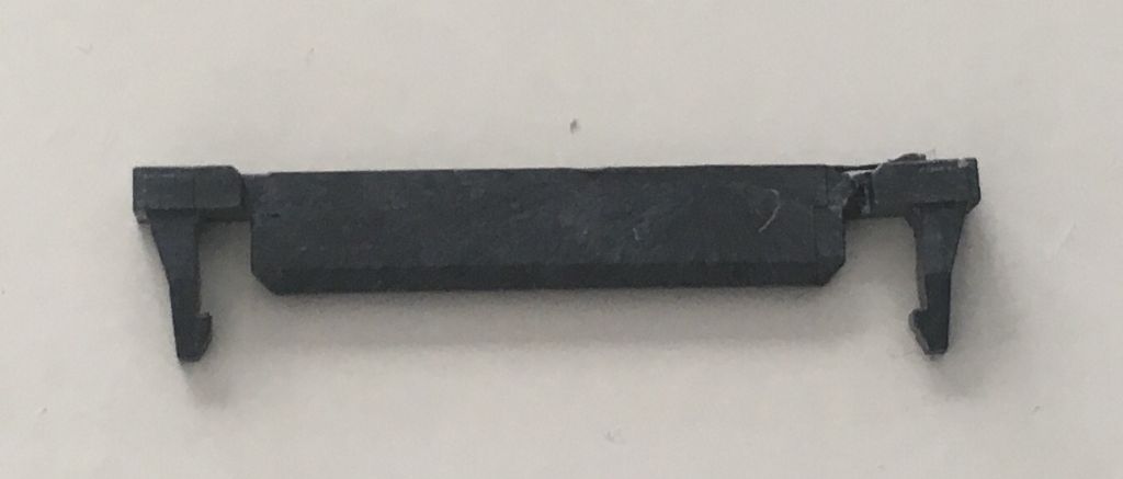

                                          The breakage was caused by my arthritic clumsiness, but the failure mode shows both a brittle failure and a de-lamination … as the attached snapshot of it ‘loosely re-assembled’ will hopefully illustrate:
                                          This is the repair job that confronted me ^^^ and at that time I presumed that ‘solvent welding’ would be the right approach … it was a surprise and a disappointment to find that the material is unsuitable for that process.
                                          #641160
                                            Here is my Super Glue repair
                                            dont know I have no idea how long it will last but, as mentioned, the clip is under no stress once it’s in place.
                                            I will probably get some sort of extension cable for the camera, so that this wedge doesn’t need disturbing again.
