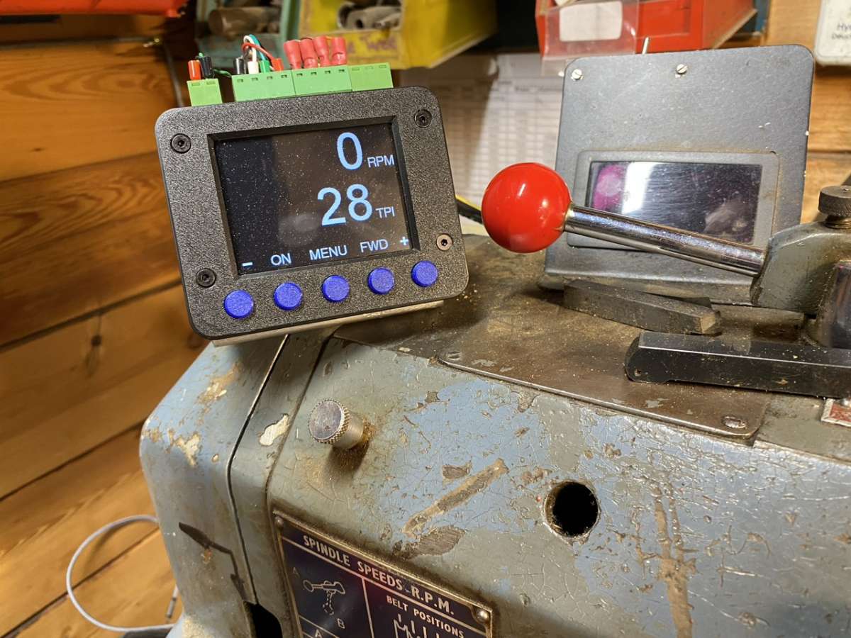

          I am having trouble with my Electronicleadscrew.eu in that the Nema23 stalls under certain conditions.
          Typical  840rpm 20tpi – Leadscrew stalls, but dropping down to 560rpm its OK.  The supplier has suggested that the problem lies with the stepper motor size,  but I use the same setup on my power feed to the horizontal mill with a heavier table/load etc without problem. (Warco Economy mill)
          Further tests show that for an 8tpi thread, I have to drop speed to 270rpm.
          I am wondering if my power supply is too small  36volt 5.0 amp, and that the Nema23 is set to 4.9amp peak 3.5 RMS current. (Max is 5.6/4.0).

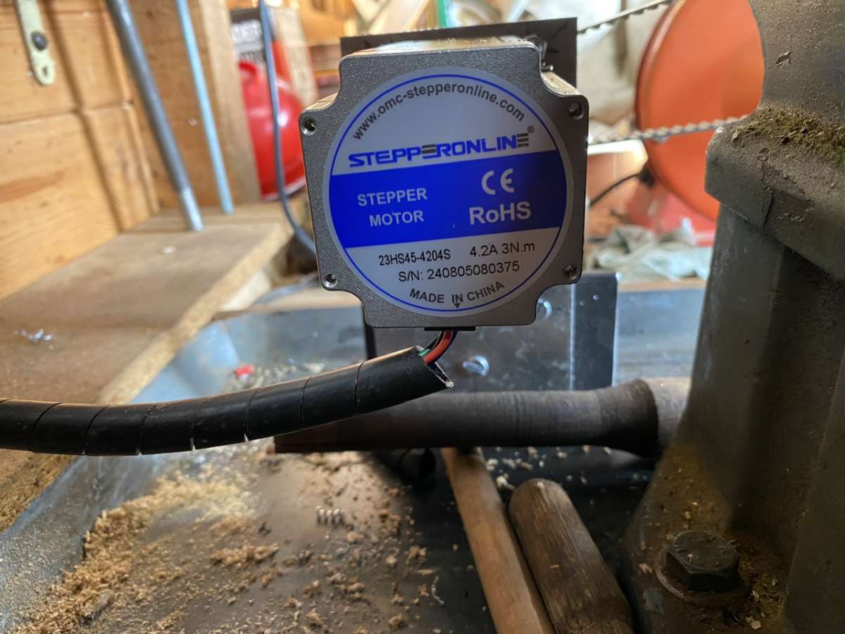

              Bob, yes more details are required but I do know the stepper motor [NEMA 23 frame] fitted to my Warco 290V ELS does miss steps when pushed hard, I can’t comment off the top of my head reference the current/amps.
              It works ok when I use the lathe gearing to give the stepper a 2:1 mechanical advantage so I haven’t really delved into the deeper issues, it’s on my list of things to do.

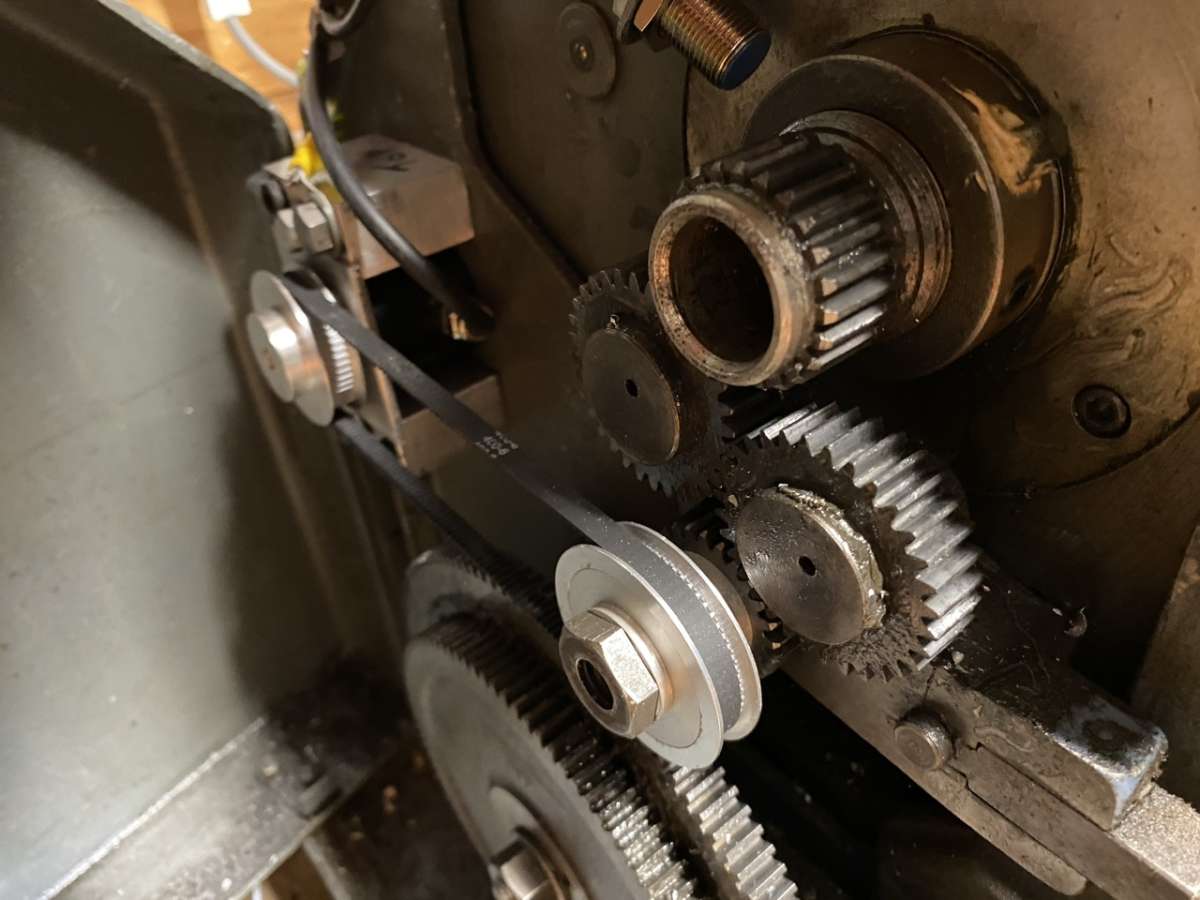

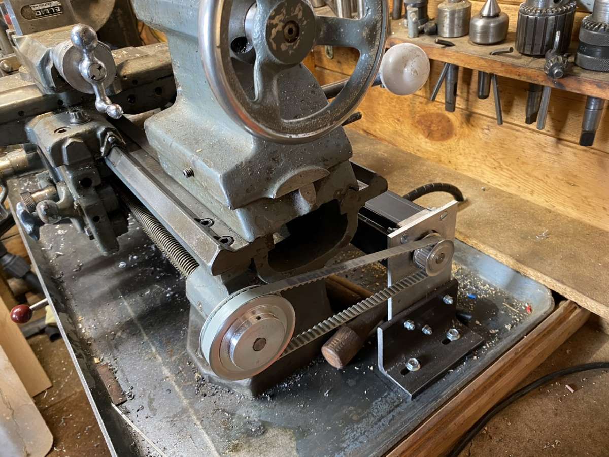

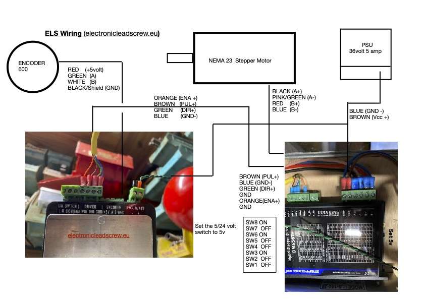

                  This is what we have got:-
                  ELS Wiring DiagELSinstall- 1ELSinstall- 2ELSinstall- 3ELSinstall- 4
                  Headstock to encoder is 60T : 60T  ie 1:1
                  Leadscrew is 20T : 40T  ie: 2:1  (stepper is the smaller pulley)
                  Stepper control and motor matched and sold by Stepper On-Line
                  The stepper motor can be stalled with the belt off and no connection to leadscrew – the system supplier ensures me that it can’t be their system not keeping pace with the encoder.
                  The stepper motor Nema 23 4.2 amp 3.0 Nm(425 oz in)
                  The Electronic leadscrew box is set with the correct parameters ie: gear ratios, stepper count etc and the stepper controller matched to them. My only choice is the power output Dip Switches  123 . initially set to off/off/on, now set to off/on/on. (4.9amp peak 3.5 amp Rms)

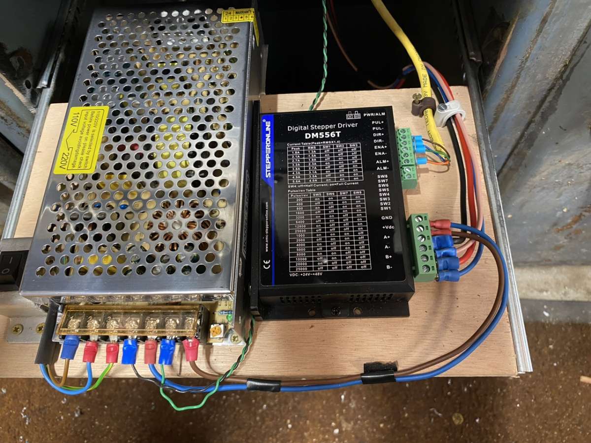

                  My only reservation is the power supply which is 36 volt 5 amp.(amazon ref LED 36V 5A – 10A 180W-360W).  It seems that this is intended for LED lighting, cars and public lighting.  Could this be an area of concern? I thought 5 amps was 5 amps But !!!!!
                  Bob

                    Don’t use LED PSUs for general electronics! They are designed down to a price and have poor regulation.  You can get very good switched-mode PSUs from many vendors at reasonable prices.  Here’s one from a CNC supplier.
                    https://www.cnc4you.co.uk/Breakout-Board-and-PSU/400W-PSU-36Volt-11Amp
                    By the way, the actual current taken from the supply with a modern stepper driver is usually well below the actual coil current because the driver is in effect a switched-mode power supply.

                            This is the PSU I have (amazon ref LED DC36V 5A – 10A 180W – 360W)  Don’t be confused by 5A – 10A. That is just 2 different PSUs one is 5amp, the other (surprisingly) 10Amp.

                              Higher voltage is better provided it’s within the voltage rating of the drive – it will also reduce the actual supply current for a given coil current.  It is very common for steppers to stall if you try to accelerate them too quickly, and driving software should do this automatically.  If using an Arduino the simplest thing is just to use GRBL which deals with the acceleration for you.  The motor will still stall if you try to run too fast or the load increases.

                                Stepper motors respond to pulses, and the best power supply for this is high-voltage, because that provides a fast rise-time.  However, the turning power of the motor depends on amps, not volts, so although high-voltage is important at pulse start, the ability of the PSU to supply amps takes over during the pulse.  (The volts can drop.)
                                This ‘volts can start high and then drop’ is why stepper controllers have amp limit switches.   As a stiff 48V PSU could provide enough amps to damage the motor, the electronics can be set to protect the motor by limiting the current.   They should be set to the motor’s maximum current rating, or a little below.   (Or if the PSU is too small, set them to protect the PSU!)  Don’t limit the amps unnecessarily, because that slugs the motor, making it more likely to lose steps.  Double check the switches to make sure the controller allows 5A.
                                Volts and amps depend on the motor, but for example one that allows the volts to charge a big capacitor to, say 48V, and then delivers sustained amps at about 36V would be good. No need for regulation, in fact a regulated PSU might well struggle with a pulsed load.  Though I’ve used them to drive steppers successfully cos they’re cheap and available, a LED supply might not cope with a stepper.  Much depends on the PSU’s circuitry, which absolutely wasn’t designed for rapidly varying loads, and we have no idea what it is.  The ideal stepper supply is surprisingly basic – like an old-fashioned unregulated car battery charger.
                                Bob said “My only reservation is the power supply which is 36 volt 5 amp.(amazon ref LED 36V 5A – 10A 180W-360W). It seems that this is intended for LED lighting, cars and public lighting. Could this be an area of concern? I thought 5 amps was 5 amps But !!!!!”  I think he’s right to worry.  The supply is reasonable on paper but the pulsing electrical load imposed by a stepper is nothing like DC, AC single-phase or AC 3-phase.  “5A” is the average current the stepper can cope with without overheating, and it’s possible the high-speed pulsing is too much for the PSU, which cuts the output in an attempt to maintain regulation – poor thing might even be having an electronic nervous breakdown!    An oscilloscope would reveal if this is a problem.
                                After confirming the problem isn’t mechanical by turning the drive by hand to make sure nothing is binding (over-tight gibs?), I’d:
                                • Increase the amp limit up to about 6A, and keep an eye on how hot the motor gets during a long ELS run. If it stays cool, go higher.  If that doesn’t help.
                                • Up the PSU to 48V, looking for one that’s stepper friendly rather than a LED type.   I’d risk this even if the motor is only 36V
                                In principle Bob’s set-up looks OK to me – it should fly.

                                  The power supply you have looks like the standard type used with stepper motors so should be ok.
                                  The stepper driver you have is rated up to 50v so you could try a 48v power supply with it.
                                  The driver controls the current to the stepper so you don’t need to be concerned about the voltage of the power supply as long as it is within the rating of the driver (ie the DM556T you have).
                                  The higher voltage allows a faster increase in current pulse so can cope with high speed/ high torque combination better.
                                  Daves last comment about the motor voltage is misleading. It is the job of the driver to control the current to the motor.
