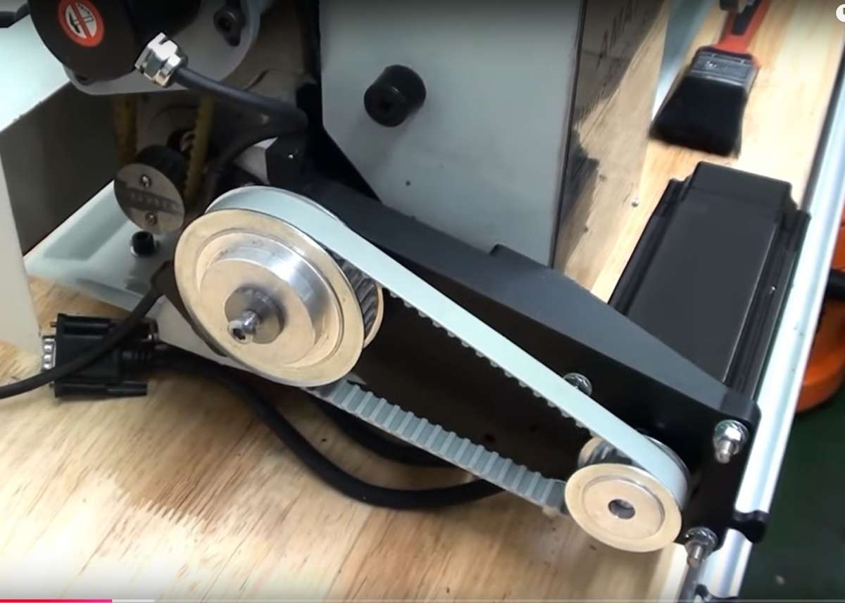

                  I used the same stepper motor/driver/power supply package for the mini lathe as I had used for the previous installation on the larger lathe for the simple reason that I knew that it worked OK, with plenty of torque available, and it was available at what I considered to be an acceptable price.  I went for a package from Stepper online, as shown in this eBay advert but is showing as out of stock at the moment.  It would be perfectly suitable for installation on your Warco machine, which looks similar to my mini lathe.
                  This is a still taken from one of the YouTube videos showing the stepper motor mounted in front of the lathe:
                  Stepper mount
                  The video is at This place. Other videos show the complete installation and testing.  If they were useful to you, the STL files for the stepper and encoder mounts, as well as the spindle encoder gear are available on Thngiverse, here.

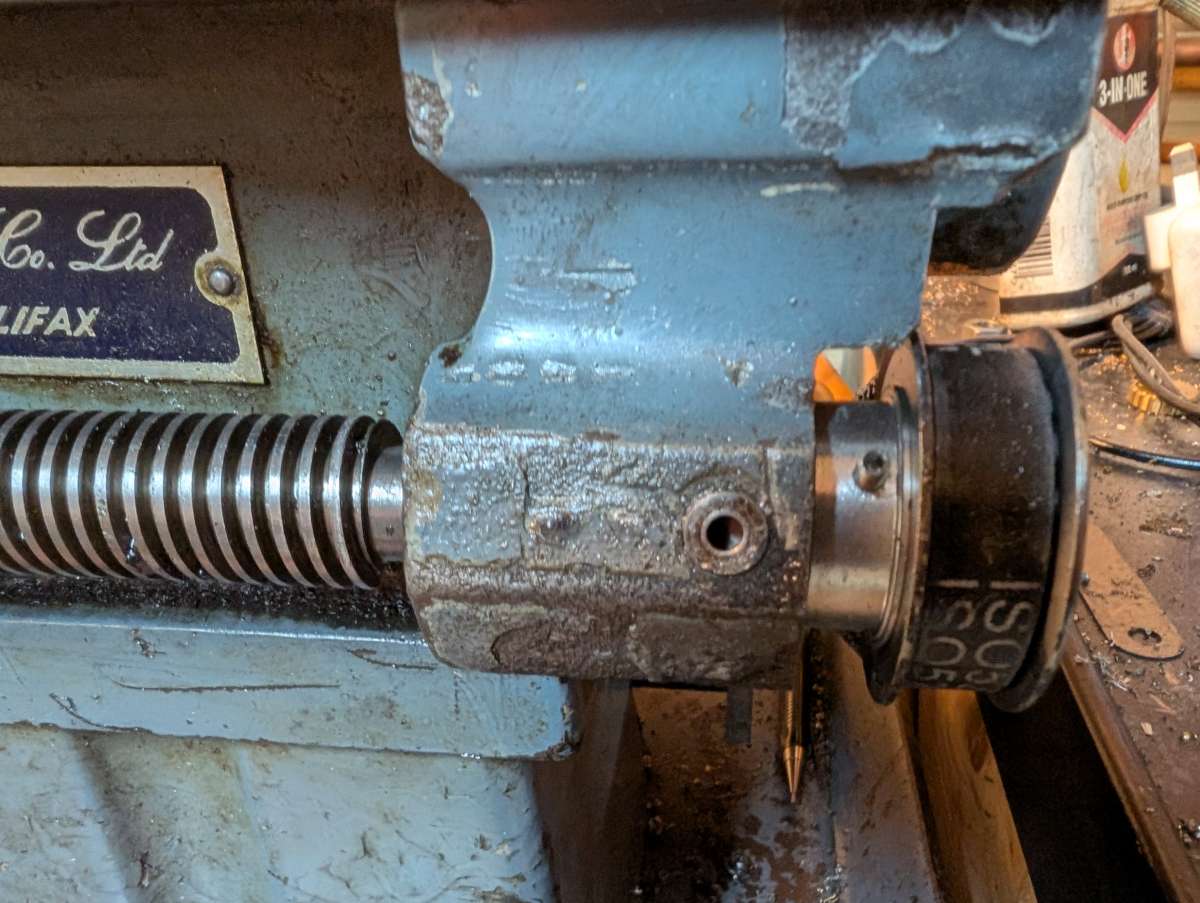

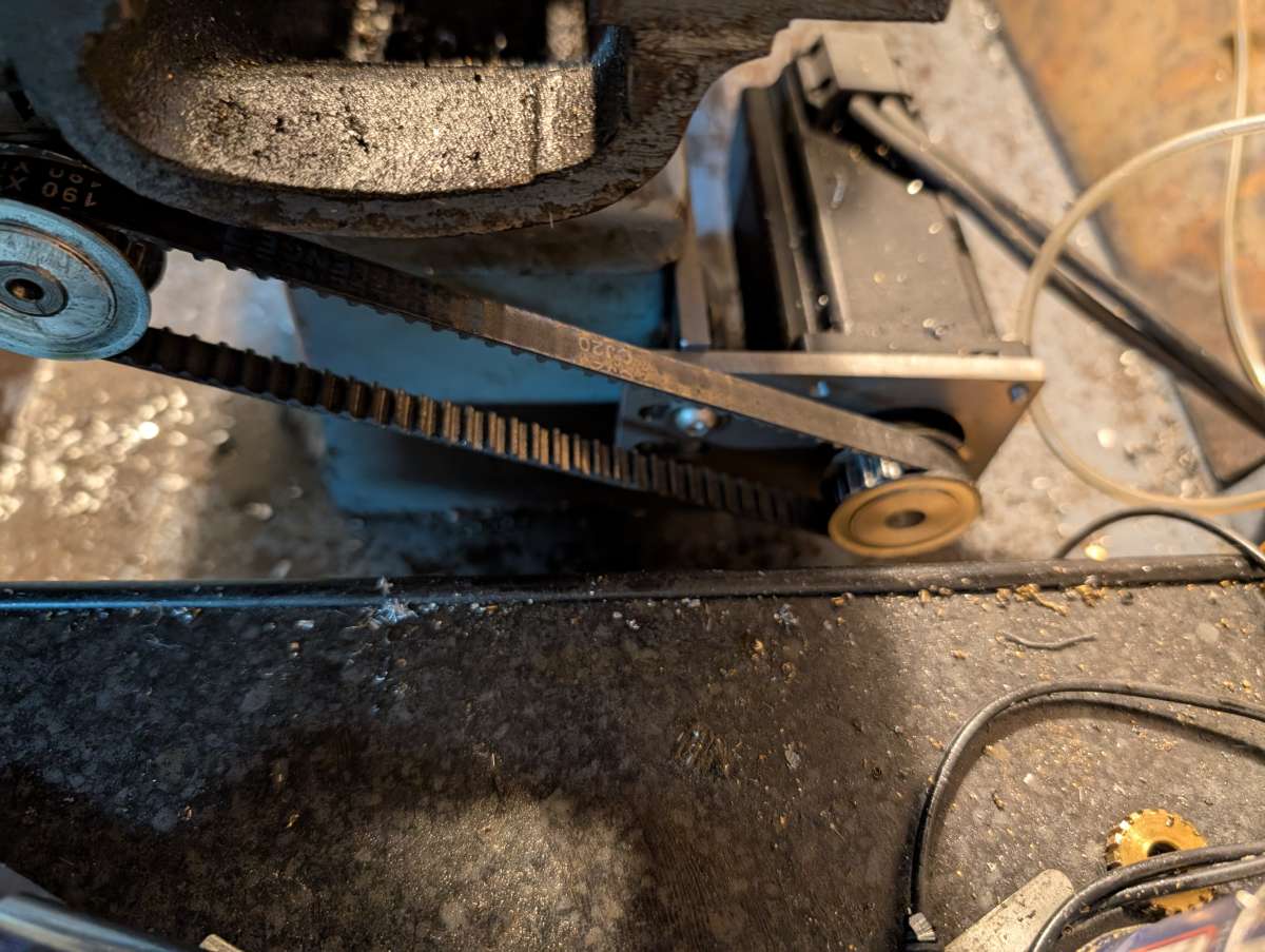

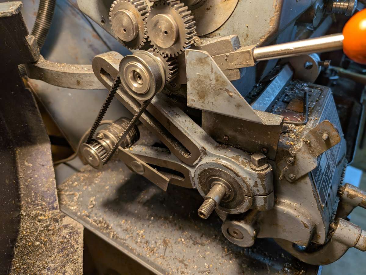

                            Hi Bob please see the photos below
                            I bought an additional leadscrew bracket and modified it so i could always put it back to original

                              MickyT – how delightfully simple – I can see how it can be fitted without too much “damage” to the basic lathe.  I seem to remember that I even have a spare lead screw support bracket in the cupboard somewhere!  Another plus is that the  carriage can move just a little bit nearer the tailstock with the Dial Thread indicator removed.
                              Do/DID you ever have a problem with timing belt slip?
                              Do you ever need / use the original geared drive to the lead/feed screw (Stepper motor disconnect).
                              I assume that you can still use the cross feed feature – just a matter of selecting an appropriate pitch (by experiment) – I can see a request going to the software developer to allow a variable feed rate as diameter changes on the cross feed (could be useful for parting off ??).
                              Thanks for the photos

                                    Hi Bob
                                    No the belt has never slipped
                                    No the gears are in a box and the stepper motor remains connected all the time
                                    Yes the cross feed performs perfectly and the pitch can be adjusted on the fly if the finish needs to be improved. I have used it when parting off as well.
                                    I originally fitted it in early 2021 and it has performed without any issues since

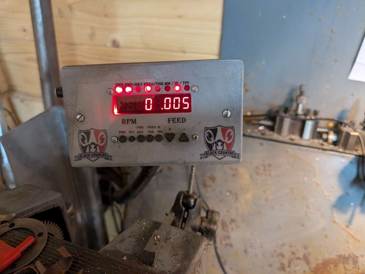

                                        I did not it seems make it clear in my first post that I was suggesting the ELS should have rotary switches. One with say 10 rates as per Norton like 8,9,10 etc then a second 10-way switch with 4 powers of two for imperial, then centre selects feeds (with 10 rates from the other switch) then 4 ranges of metric and final 10th position selects BA.
                                        I have enough electronic devices like my blasted digital radio with a little screen and multifunction buttons that takes a special magic to get to go from one listenable channel to another.
