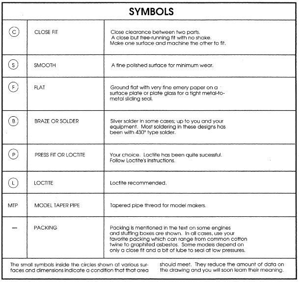

            You will find there are other symbols use don his drawings so this may help

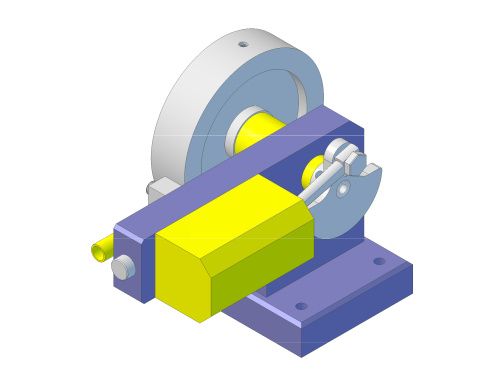

                  Getting to know the engine by drawing is a good idea. It will also enable scaling and metrication which may alleviate some of the odd screw sizes. I find most of Elmer's engines to be on the small side so upscaling can be helpful if, like me, poor eyesight and unsteady hands, are an issue. The engine you are looking at has a frame that is just 2.25" long. My last attempt at one of Elmer's was his No.19 Standby Engine, the drawing shown below:-
                  The final outcome was quite reasonable looking engine that runs quite well.
                  The details and construction are on my website – Journeyman's Workshop Good luck with the drawing and subsequent build.

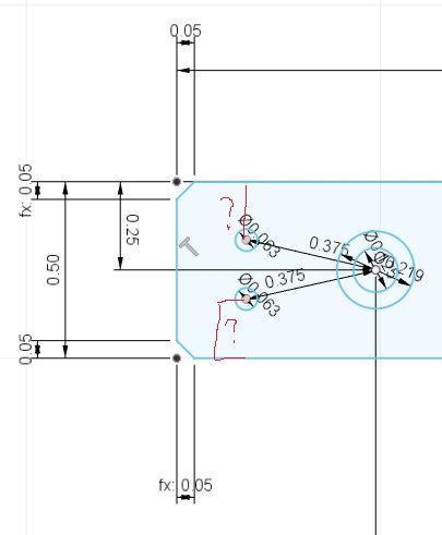

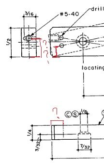

                    Your CAD drawings are great Journeyman, it's very clear in terms of measurements. I'm finding it difficult to determine the exact measurements for some parts of elmers drawings. It feels like there are bits missing, for example, the exact position of the air intake / exhaust holes. All i can determine (based on the dimensions provided on the jig) is that they should be 3/8 inch from the hole that atached the cylinder to the frame.
                    I can't see how far up or down on the frame the holes should be though. There also doesn't appear to be an exact position for the air inlet hole. I must be missing how to read something!
                    My drawing:

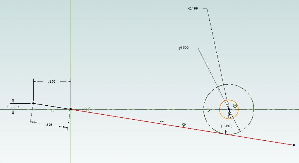

                          Should be possible to plot it
                          Draw the 3/16" pin 1.25" from the pivot and then a circle 1/2" dia around that. the 1/2" is the pin plus twice the distance of edge of jig to it's ctr line. Then draw a line through teh pivot that is tangental to the 1/2" circle. mark a point 3/8" along the other end of teh line and that's your hole location.
                          Plot (click for larger image)
                          And the two dimensions taken off the drawing.
                          If you do want to make the engine a bit bigger and to metric standards then use the scale of 1/32" on original = 1mm
