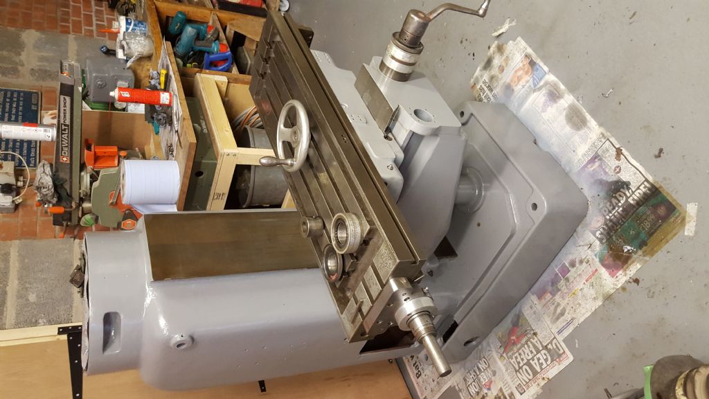

      I have just bought this smaller Elliott version of a Bridgeport vertical turret milling machine but strangely cannot find any info at all about it from the usual sources or google search. Can any members enlighten me with specs and/or their experience of it? I will post a pic. Adam

            More pics in my album…

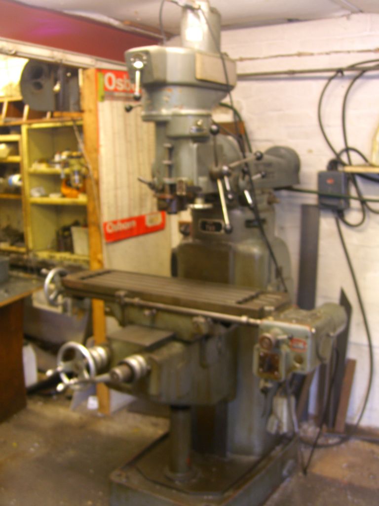

            Muzzer
              @muzzer
              Doesn't seem to share much (if any) DNA with the Bridgeport family apart from being a vertical turret mill.
              Seems to have power feed on the table. Looks nice enough – 30-36" table?

              Adam Harris
                @adamharris13683
                No i did not mean it shared DNA, but just that it is a vertical turret mill as is the Bridgeport , the Bridgeport to my mind being by far the most common of vertical turret mills, with head swivelling in 2 axis and in-out rack&pinion.
                #192604
                Adam Harris
                  @adamharris13683
                  It is a bit smaller than a Bridgeport (hence the appeal to me) and the table is a bit smaller – I think 30-36" is a good estimate. Whether it is lighter than a Bridgeport is another question…

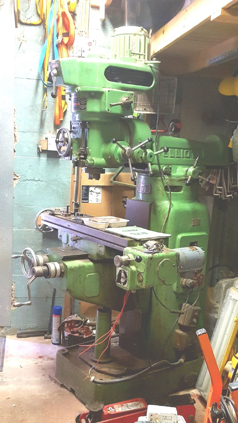

                                I too have just acquired a very similar Elliott, a TV2 as it happens. I'm also lost for information. My best guess is it's an early version of the Elliott "Milmor" as shown on lathes.co.uk. but with the head of an "Omnimill"

                                    Adam Harris
                                      @adamharris13683
                                      Looks very similar to the TV1. I sold mine to a nice guy in Scotland who set about fixing the spindle bearings which were a bit sloppy, and did say that was a difficult job. However it fitted into his new wooden workshop nicely in the corner albeit with a small timber protrusion built outwards from the timber wall to accommodate the ram. Too long ago to find any photos or correspondence but he was delighted with it and it is a very handsome British monument!

                                      Bazyle
                                        @bazyle
                                        You are right that the head is the same as the Omnimill, which came first? However the overarm is different as it looks like has the boss on the rear for a slotter.
