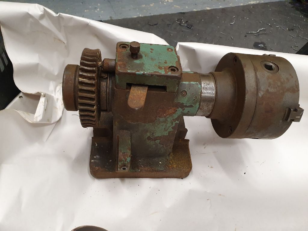

        Hi all.
        I've just acquired an incomplete Elliott dividing head, mostly because I wanted the chuck that's on it and it was the right price..
        To make it useful as a dividing head again though, I'd like to see if I can either obtain or make the worm to go with the gear that's mounted on the spindle.
        Not so familiar with the specs of these things – is there a simple way to measure what I need, or does some kind soul either have a spare they are willing to pass on, or even know what the specs actually are?
        Thanks,
        Youra.

          If you are making, then I would junk the existing worm wheel and make a new worm and wheel as a pair.

            Just measure the OD of the wheel at the bottom of the throat and count the teeth. Then you can work out what the pitch of the worm is and they are fairly easy to make.

              The worm is a tad over 0.975in or a tad under 2.6cm diameter, minor diameter 0.632in, 1.61cm. However this depends on depth of engagement so crest of thread is 0.085in 2.18mm. Base of thread is about the same but my calipers don't go in that far. Pitch: 3 turns are 0.76in 1.915cm. so seems to be 4tpi. It was probably designed as 4tpi being simpler to set up than a circular pitch and the wheel designed to match as the only variable would be the diameter.

                As it has lost the plate holder etc as well probably the best thing to do would be to make it into a stepper motor controlled divider.
                Unless you already have another dividing head to make a new worm wheel, with suitable precision as that is what the whole device revolves around, then it is much easier to make just the replacement worm. If you make the first one out of brass it will be adequate for hobby use and if it is not the best match won't damage the wheel.

                  Yes – a stepper motor controlled arrangement was exactly my aim
                  I have a motor and indeed the controlling electronics, all I'm missing is the worm and the bits that will hold it all in place.
                  Thanks for the measurements – I will make it out of brass – I'm assuming it's a flat crested / trapezoidal thread…?
                  Next challenge of course is seeing if I can easily achieve a 6.35mm pitch thread on my all metric lathe….
